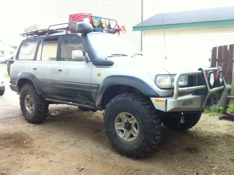

That's bad ass.
Did you use the Radius Arms?
Welcome to Mud, by the way.
A request for a build thread, or at least details on a separate thread, please.
Hi...and thanx for the welcome,
yes - i fit superflex radius arms, adjustable upper and lower rear arms, Tough Dog adjustable shocks, front and rear adjustable panhard bars and a front sway bar extensions.
..it works great on a traveller...;)
...my build up thread from 2009/2010 is on expo -> HDJ 80 - evolution from original to…. - Expedition Portal

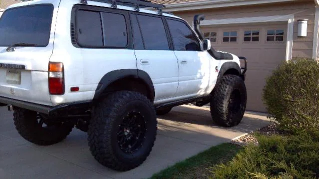

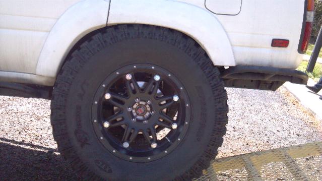

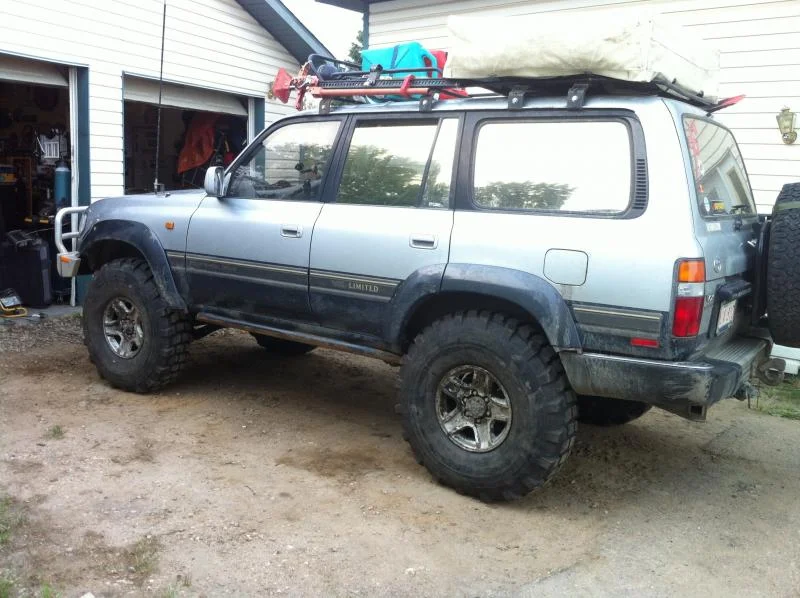

Well I guess I belong in this group now too.
HDJ81 4" Zeal lift and new 11x16 michelin XL's. A little rubbing at full lock up other wise it tucks tire nice. I am going to order the 6" slee for a little more room. I love how balanced these tires are and they havnt been balanced, crazy smooth

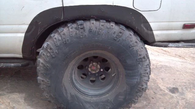

Dick Cepec fun country 44"
no body lift, alot of cutting and only a little suspension lift, not sure exactly how
much, havent measured , bought it like that, riding on airbags front and rear

Looks Good Ryan!
No more Ruby lake 37" mud grappler envy I guess! :hillbilly:
Ive been pondering the michelins lately myself, but I really like the look of the 17" fjcruiser wheels in black and none of the michelins seem tocome in a 17 of course, its either 16's or dubs.

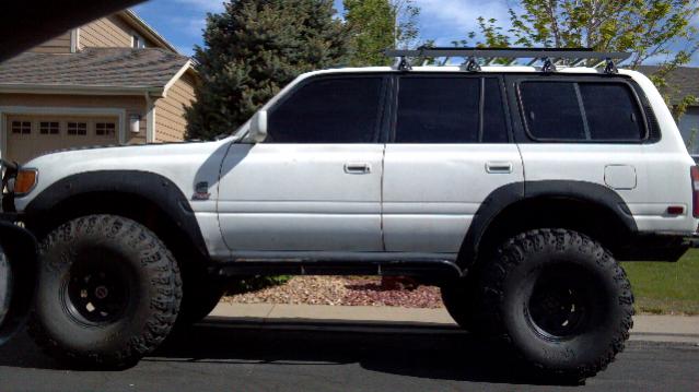

just got mine up on 345s
i need to trim the pinch welds, and i might remove the fender flares and trim my fenders to get all the flex I can.
im running an OME J lift, with 1" front coil spacers. i will be adding a MT 2" front coil spacers shortly as well.
oh and that oil stain underneath is not from me. the neighbor usually parks there.
Is your bumper a rear stinger style tire holder? Looks killer! Any pics of it.

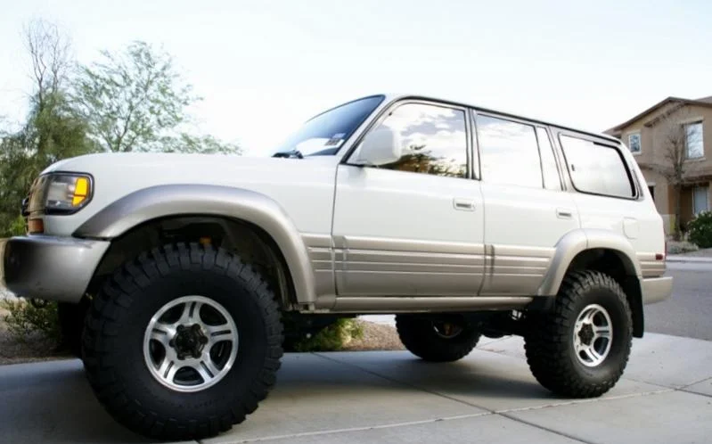

It seems as though people are counting 345's as 37's so here is mine ;p
345/75/16 BFG KM2
J springs and L shocks
man-a-fre radius arm drop blocks
1" bump stop drop in front 2" in rear
I have 1" wheel spacers and 1" 4crawler body lift still in the boxes. its hot as hell here in Tucson so Im not sure when i will get those installed. I'm hoping i can avoid any trimming and retain full articulation with the body lift. we'll see.

What side of town u on? I live in Tucson and haven't seen your rig yet. Looks killer.

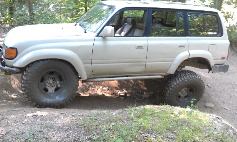

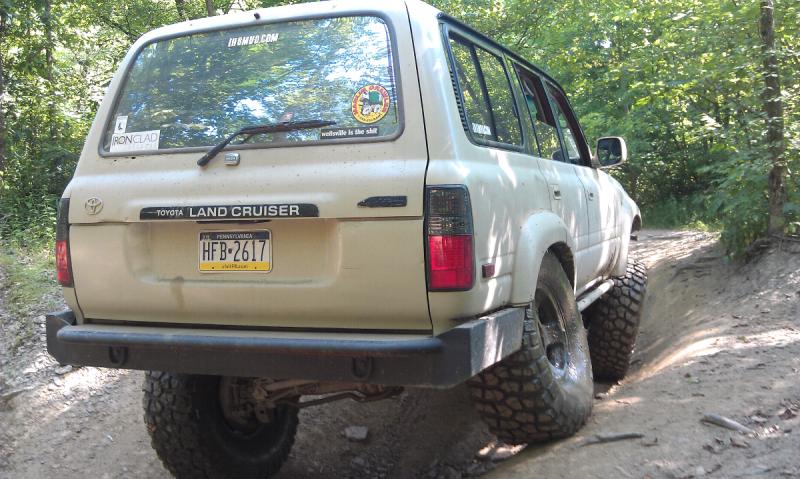

Here's my junk:
345 75 16 KM2's 1" wheel spacers
OME J's with 30mm front spacers
NO bump drops (just trimming & massaging metal) ;)
Stock rear sway bar (with drops)
No front sway bar
