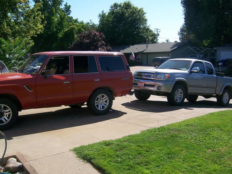

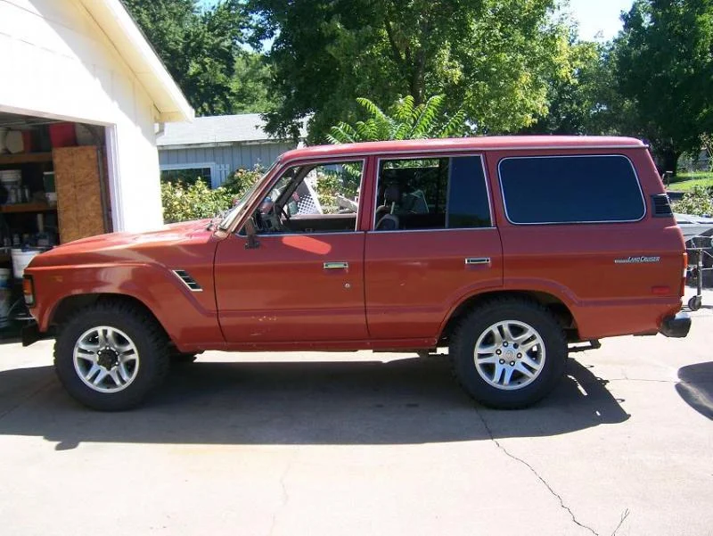

I was bored last night, bolted up my winter set of rims/tires (265/70R17) from my '04 Tundra, just to see how it looked and how it rode. WOW!! I am very disappointed in whom ever installed the wheels before, I would guess "maybe" 30-40 lbs of torque on the lug nuts. (Yes, I do realize I am missing a lug on the front and rear...)
But, the drive afterward was amazing, it felt like a whole new rig. I did notice a rub on the leaf springs at full turn. I think stock Tundra wheels are 17x8, with 4" backspacing. The ones that where on there where 15x8 with 3 3/4" backspacing. I may just adjust the stops and run it, or add 1/4" spacers as well. The Tundra turns like a bus, so I wouldn't be missing the turn radius.

You're probably also rubbing on the calipers, might want to check that out before the next drive.
Nice rig though!
Nice rig though!
I hope I would have noticed caliper rub while installing, and initial drive,but I just jacked the front end up to make sure. Wheels spin free, 5/16" or so of clearance to the calipers. Thanks for the input though!
welcome :flipoff2:
looks like the dreaded saggin wagon suspension has set in.
if you thought thread torque made a difference, wait til you get new suspension....
