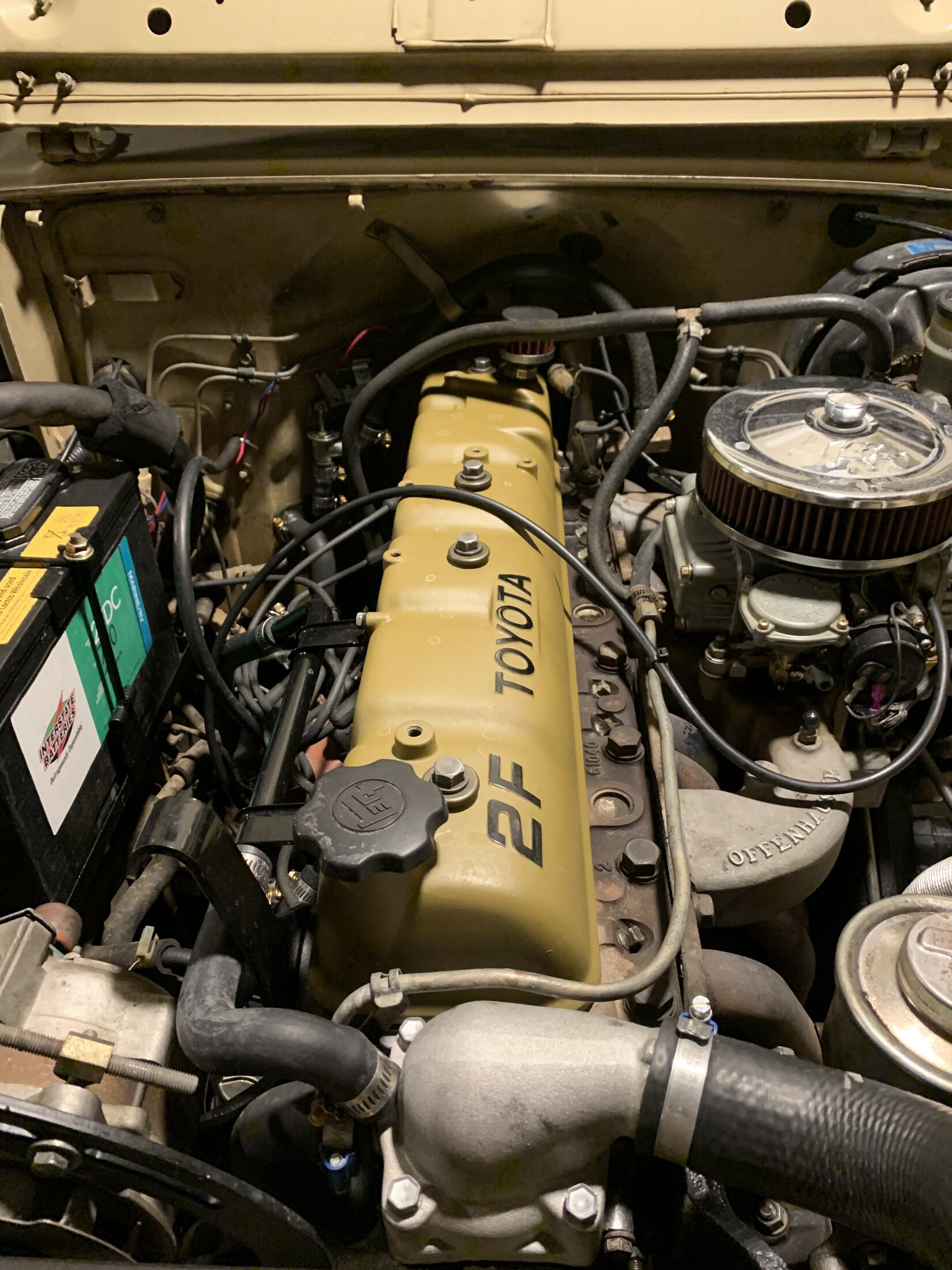

My Offy and Holley 350 set-up. Has headers, too. PO install. I’ve sourced all the parts to take it back stock, but keep debating on doing so - very reliable and I like the power. Only complaint is that it runs a bit rich.
From that, to this. Love that it’s back to stock and it runs (and smells) MUCH better

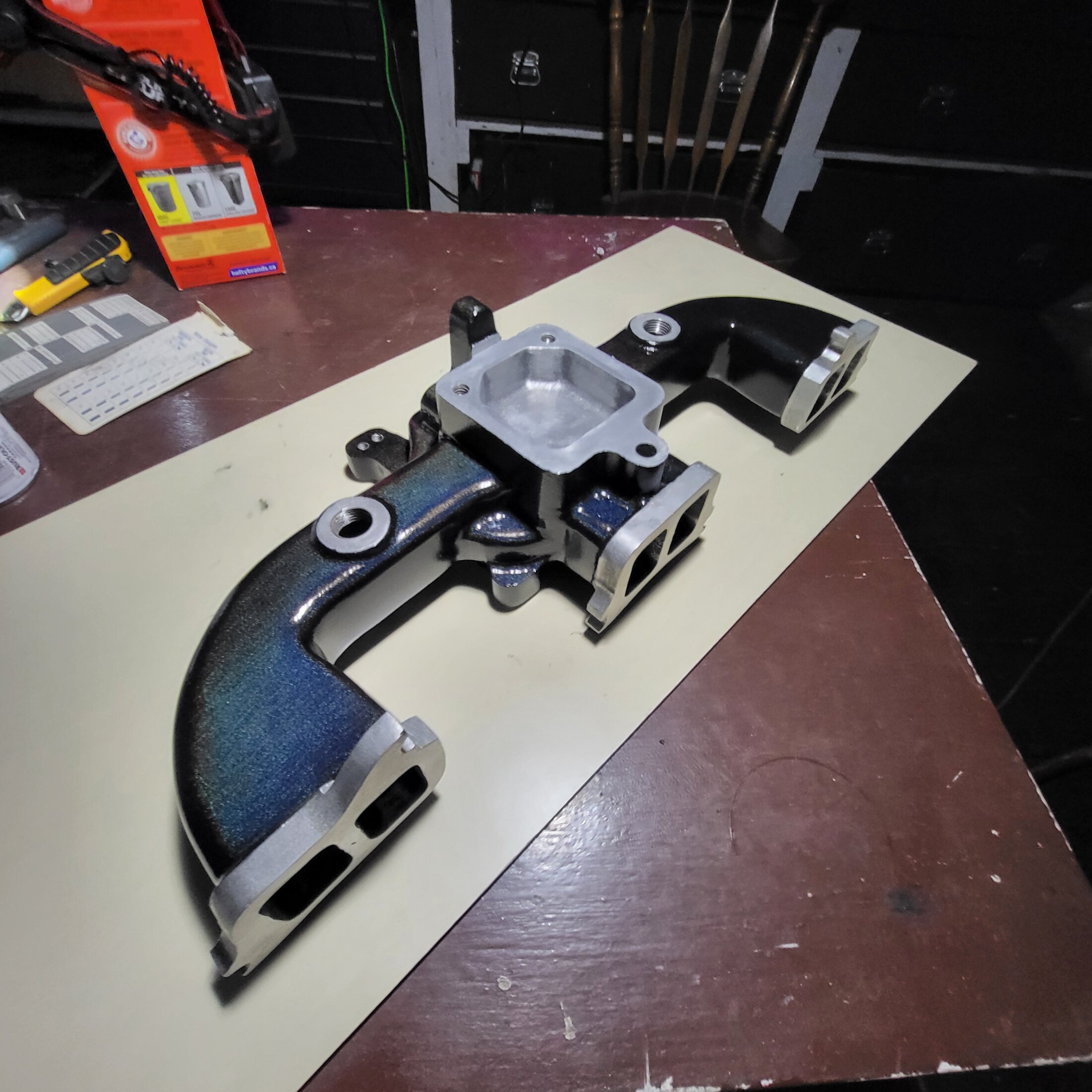

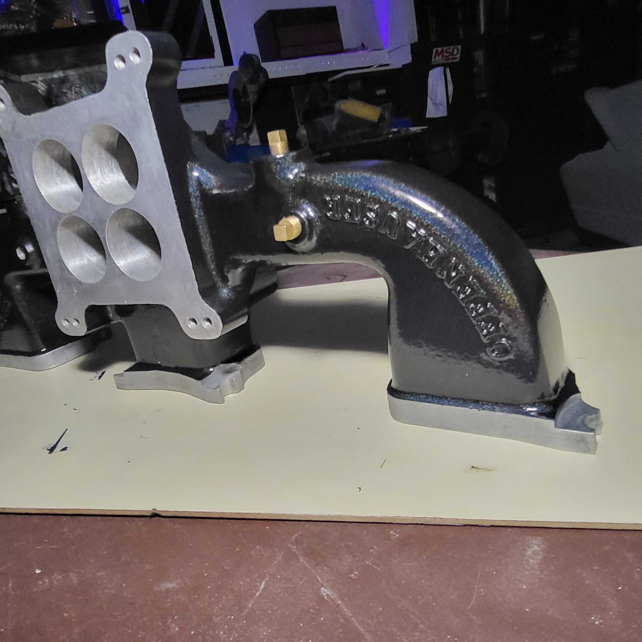

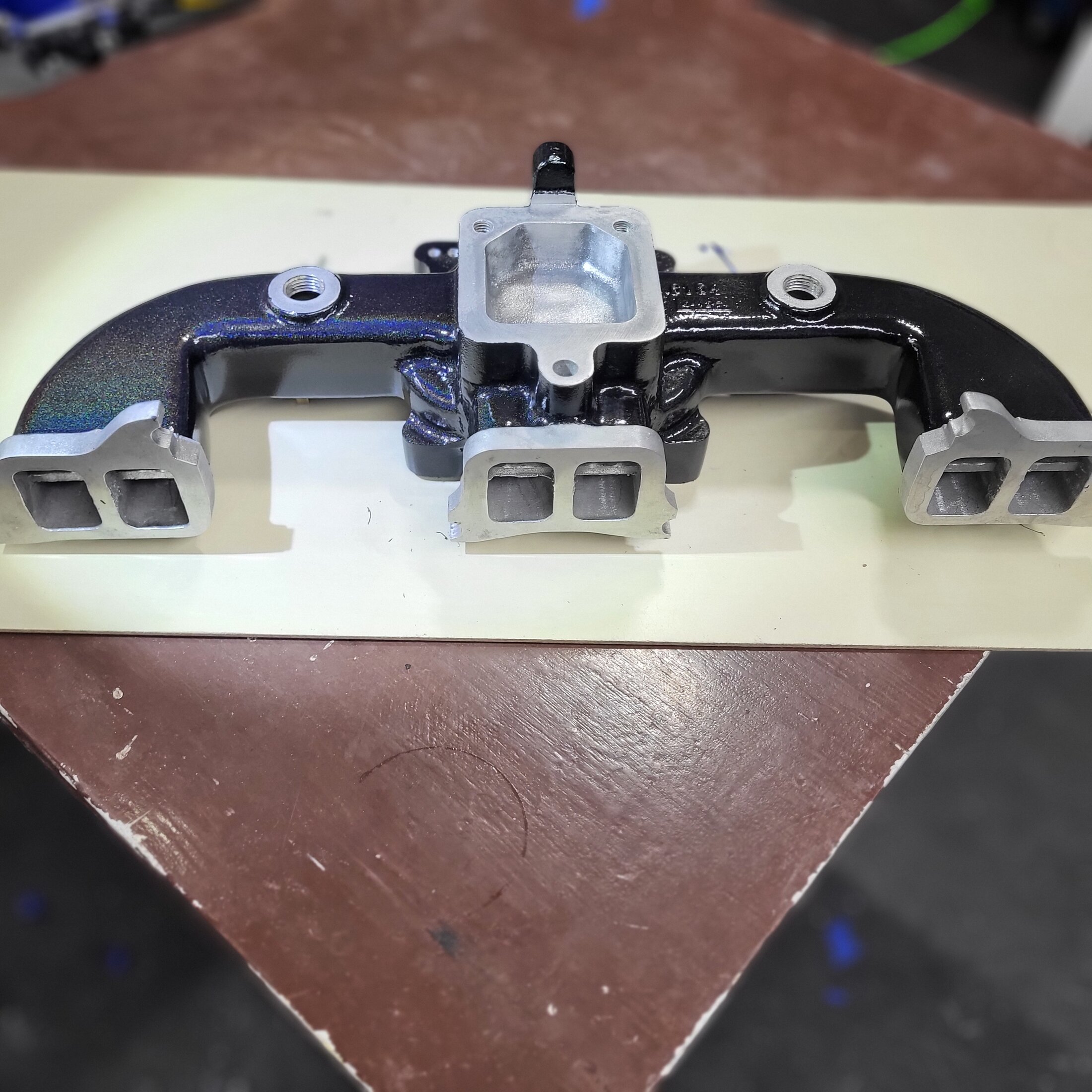

Each runner has a divider cast in it. One side of each runner goes to the primary carb ports at the flange and the other side goes to the secondary ports at the carb flange. You can see them in one of the pics above. Was supposed to be high velocity in the small (divided) port runners for the primary side and you would get the full port volume when the secondary's opened on the carb.
IDK how well they worked, but Offenhauser made the Dual Port style manifolds for many engines back in the day. Not only inline engines but for popular V8's as well.

The original carbs and manifolds were smog devices, with the heat from the exhaust cooking the intake so they could atomize fuel and work with so-so porting.
I think this manifold would run better with the factory Aisan USA, or non-USA carburetors (with headers) because the ports don't merge at the intake gasket, they go all the way to the base of the carb. @White Stripe

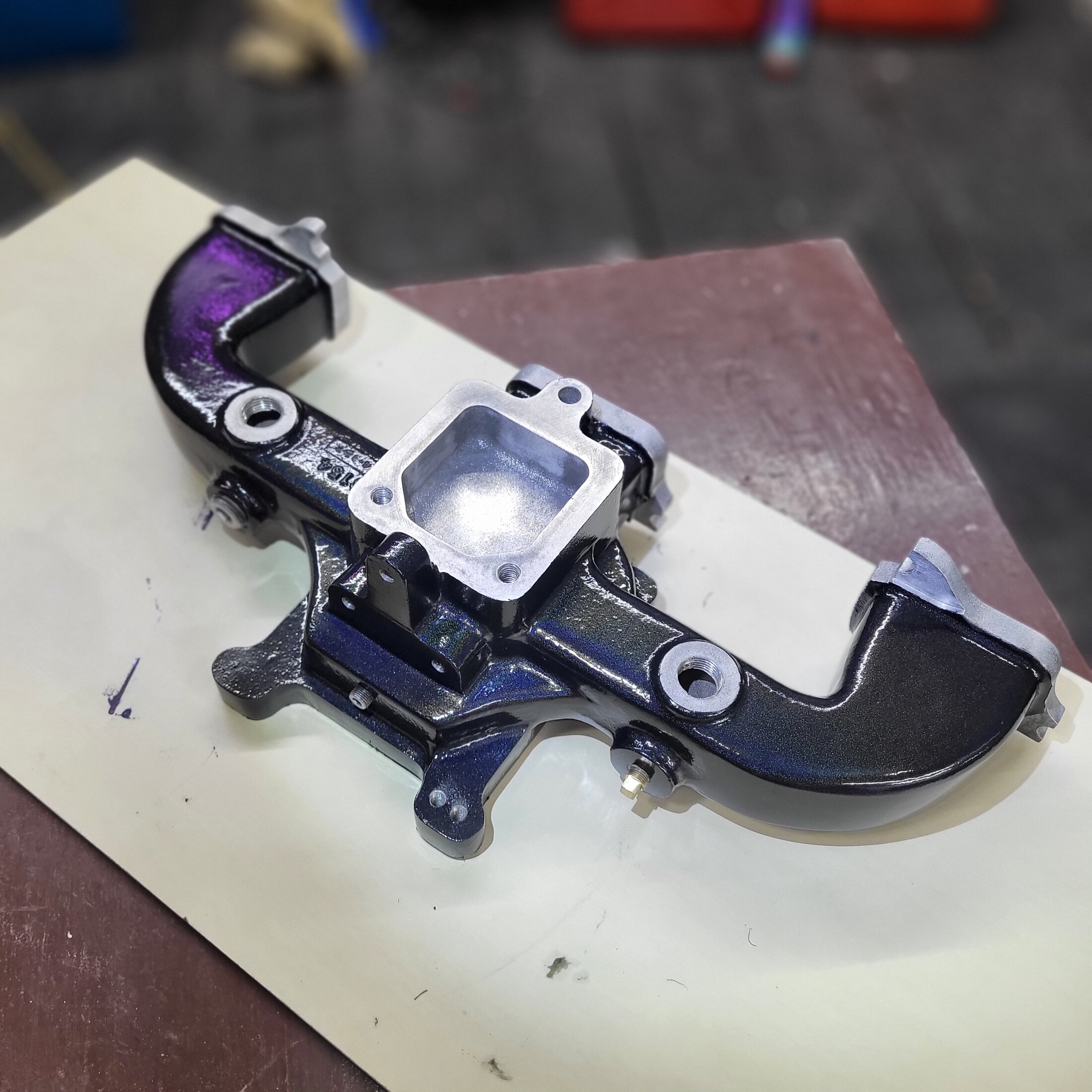

Hey, this was my dad's he had it hidden away in his shop and passed away 2 years ago and came across it cleaning up. I cleaned it up and painted it had been collecting dust for 50 Years but I know he had barely used it before doing v8 engine swap. Sorry not to familiar

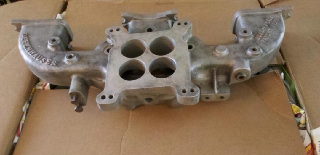

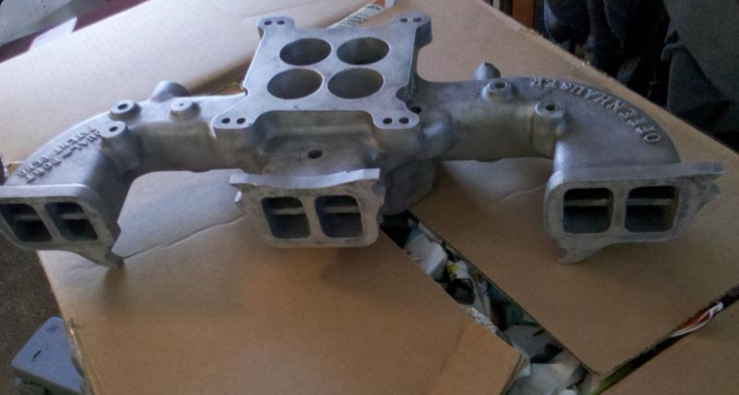

So,now I would finally like to answer you,
Well,first of all I would like to tell you that this Offenhauser intake manifold is actually not for the 2f, but for the 1f.
I'll also send two photos so you can see it straight away.
Your intake manifold fits the 2f head, but it doesn't fit with the 2f exhaust manifold, which I don't find that nice.
