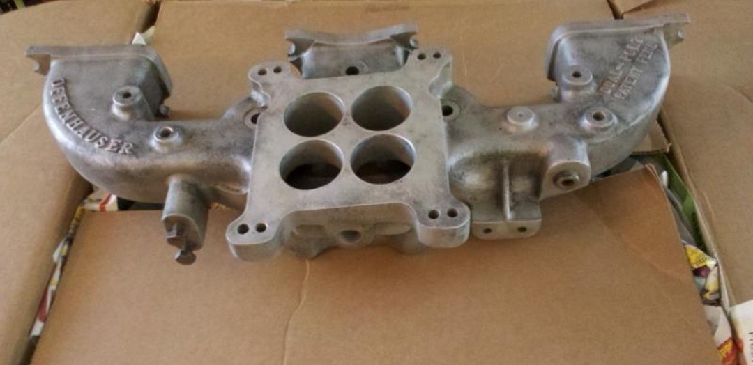

That is the DP style which is supposed to have separate runners for primary and secondary barrels on the carb. The idea was that it would run around on the smaller runner, then when the throttle is opened the secondaries come on the runner cross section would effectively double. Some people have run them with small 4 barrel carbs for that purpose.
I believe they also made another design that was open runners, but those are less common to see for sale.
If you are using a header, either the F or 2F versions could be made to work (may need to open some holes.) I have an F version in my basement I picked up with the throttle body EFI systems first came out that I havent done anything with.
Edit: had this photo saved

Clifford used to make a high flowing 4 barrel manifold for the 2F
Offenhauser used to make a nearly identical one called the " C series". I believe it may have been the cliffors design that they purchased?
Offenhauser used to make a "Dualport" manifold for the 2F. It was a sort of dual plane system where the primary 2 barrels of a 4barrel carb ran through smaller runners and the secondaries dumped into separated and larger runners.
All three of these manifolds worked very well on the 2F
For a year or maybe two, Toyota made a much higher flowing intake that was found on some of the mid production F engines. Basically separate runners to each cylinder, instead of the SMALL shared runners that were the norm.
To the bst of my knowledge, none of these manifolds are in production. I am not aware of any NOS sitting around anywhere.
With any of the three, if you find a used one, carefully inspect the "ears" where the bolts clamp the manifold to the head. these are prone to cracking. More than a few used Offys are missing one of the ears. :(
I think I still have one of the dualports here. Cracked ear waiting to be repaired. Gotta see if I can find the ear, or I am gonna have to build up some material by welding and then machine it down to shape. :(
