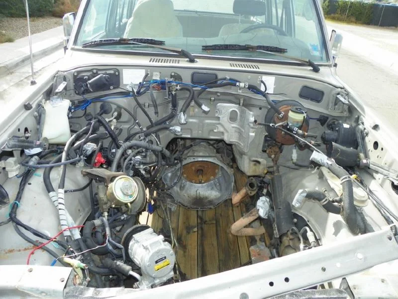

This weekend we hope to get the engine installed with new belts and hoses and then off to another shop for some minor body repair.
As I look at the list it feels like we haven't made much progress, but we still have time. At least I hope.

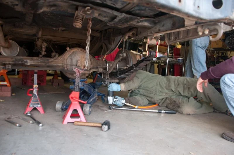

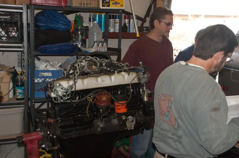

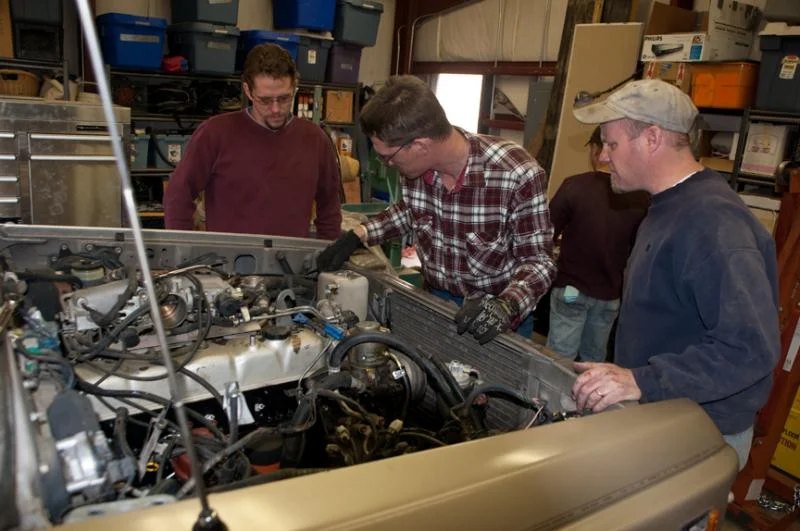

Went down to lend these guys a hand on Saturday. Good sized turnout for their workday.
Rear axle went in on springs made locally by McBride's. With rims and tires on, the fresh motor went from stand to engine bay and accessories put back on. Not bad for a day's work.
