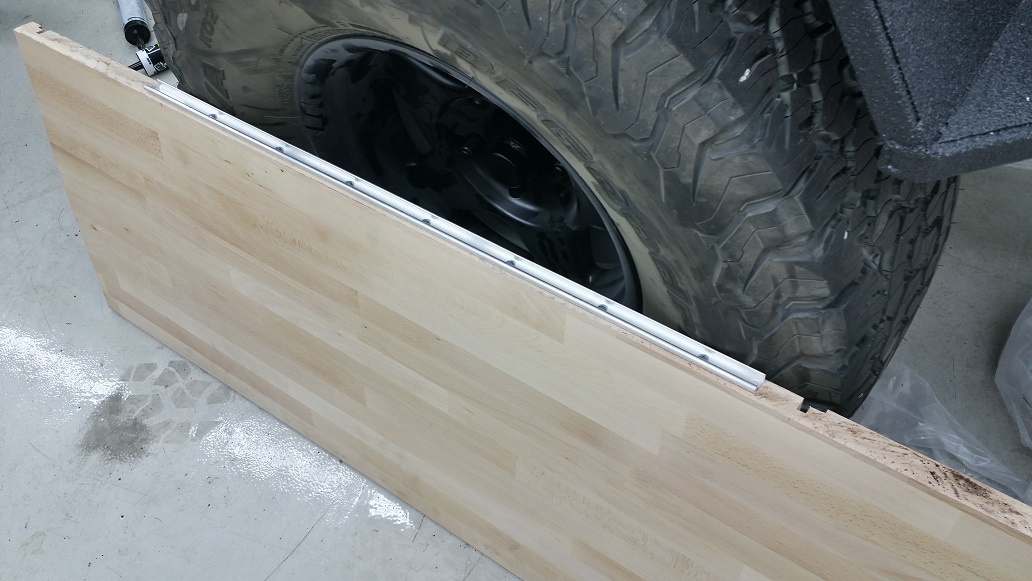

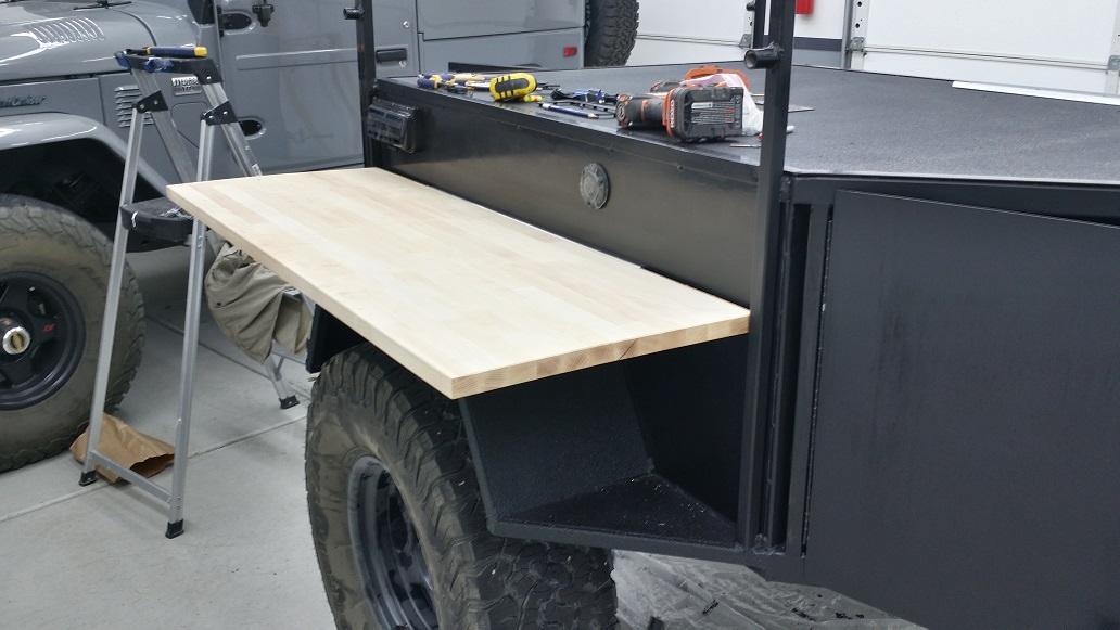

Never too much table space, so I made a detachable table/bar that stores upright in the longer storage area.
Found a wood table top at Ikea that was well built. A little big, so I trimmed it down to 19"x54"

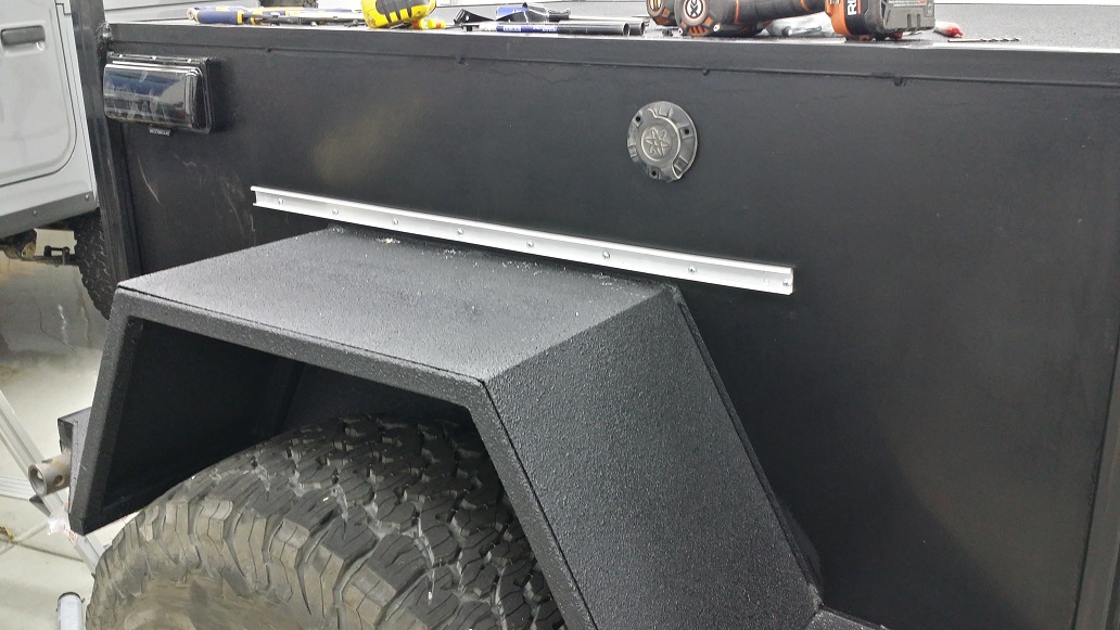

Attached one half of the railing onto the trailer
The other half to the table top
And now we have double the table surface area as before!
Where did you source the strip that the table attaches to the trailer?
Amazon
https://www.amazon.com/AP-Products-013-164922-30-25-Support/dp/B00G44IZEO/?tag=ihco-20
That mount won't hold the weight of the table, just holds it in place. I have two rubber bumpers on the bottom of the table that rest on the top of the fender.
