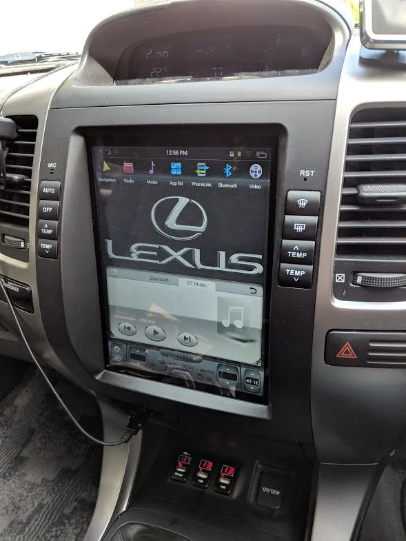

My dash is original (according to Lexus.drivers). It's in great shape. I park outside 90% of the time and it seems like the center, right above the temp/clock is starting to lift up. There's a noticeable gap between the dash and the plastic now. No cracks or shine or smell from the dash though. Anyone else get this? Can that be adjusted?
This is the best picture I have. It's more obvious looking head on.

I don't have cracking or stickiness on my '09 but I do have the lifted part that you are talking about here.
I decided to take the nav unit out and see if I could fix the bumped up dashboard today. There wasn't an easy way to tie down the dash, but I was able to stick a thin (~3mm) piece of plastic between the temp/time unit and the upper section of the plastic bezel that meets the dash. It moved it up about 1-2mm, enough to take the gap out. There's still a slight bump in the dash, but much less noticeable.
If you really wanted to get creative, you could rig up some sort of tensioner system to pull the top two navigation unit mounting bolts down toward the bottom two mounting bolts. I messed around with it and it did pull the bump in the dash down. I didn't have the time or the supplies to do the job though.
