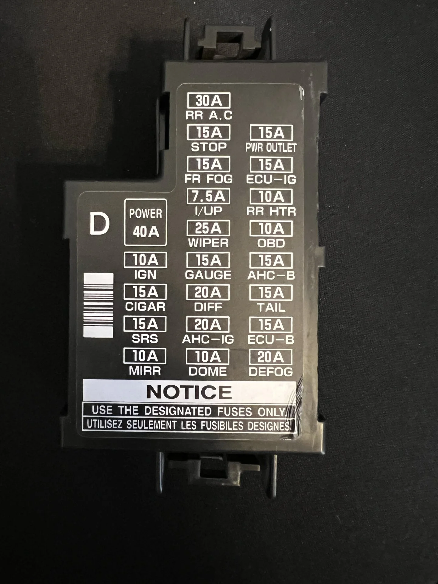

I hardwired mine to my driver side fuse box (to the left of the pedal box)
Which fuses did you tap into for the accessory power and for constant power?
Edit: as a follow up on my own question, after probing with my multimeter, I chose the CIGAR (15A) for accessory power and the DEFOG (20A) as my constant power. Everything is working as it's supposed to. This is for a Wolfbox G930 rear view mirror/dash cam.

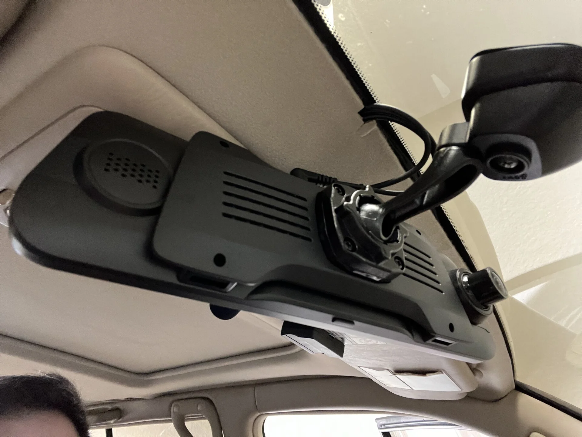

I received the bracket from ebay and I've had my Wolfbox 930 dashcam/rear view mirror camera installed for a couple weeks now. The #129 ebay bracket is definitely what you need along with the mirror adapter bracket from wolfbox. Everything is working well and the clarity of the rear view camera mirror is excellent (during the day). At night it's harder to make out details, but you can definitely see all headlights and street lights. Overall, this was an excellent upgrade over the OEM mirror with alot of added funationality.

You need three items in total (all separate buys)
1) The mirror itself
2) The mirror bracket (from Wolfbox in my case)
3) The mirror adapter (#129 from ebay)
#3 attaches to #2, which then attaches to #1.

The one I used is specfic for the G930 or T10P model mirror. They sell another one that fits more of the different models.
This is the one I used for the G930 mirror:
I did the same, just bought one that fits my particular mirror. It doesn't matter what vehicle it fits (per wolfbox) since you'll be using the #129 bracket. You just need the part that screws onto the back of your wolfbox mirror then attach #129 bracket to that.
See the 3rd picture in post #39 that shows the #129 bracket next to the bracket that came from Wolfbox. You throw that away and just use the rectangular thing that screws into the back of the mirror to attach the 129 bracket.
