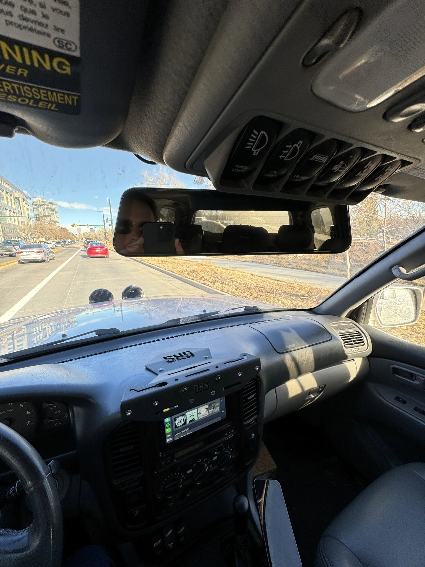

Alrighty - so two things of concern:

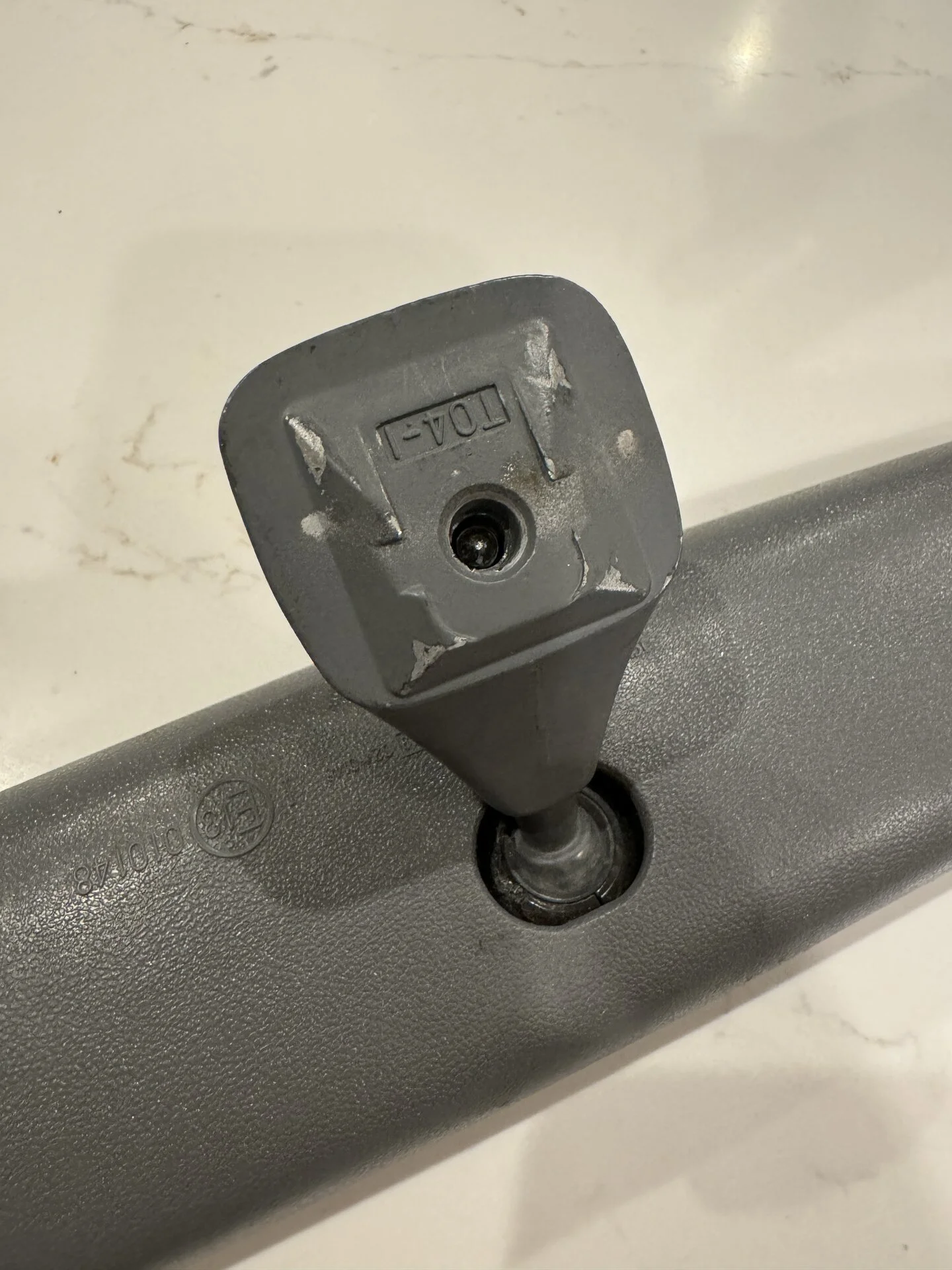

Need to reuse your original screw (or order one from wits end). Which I wasn’t ready for.

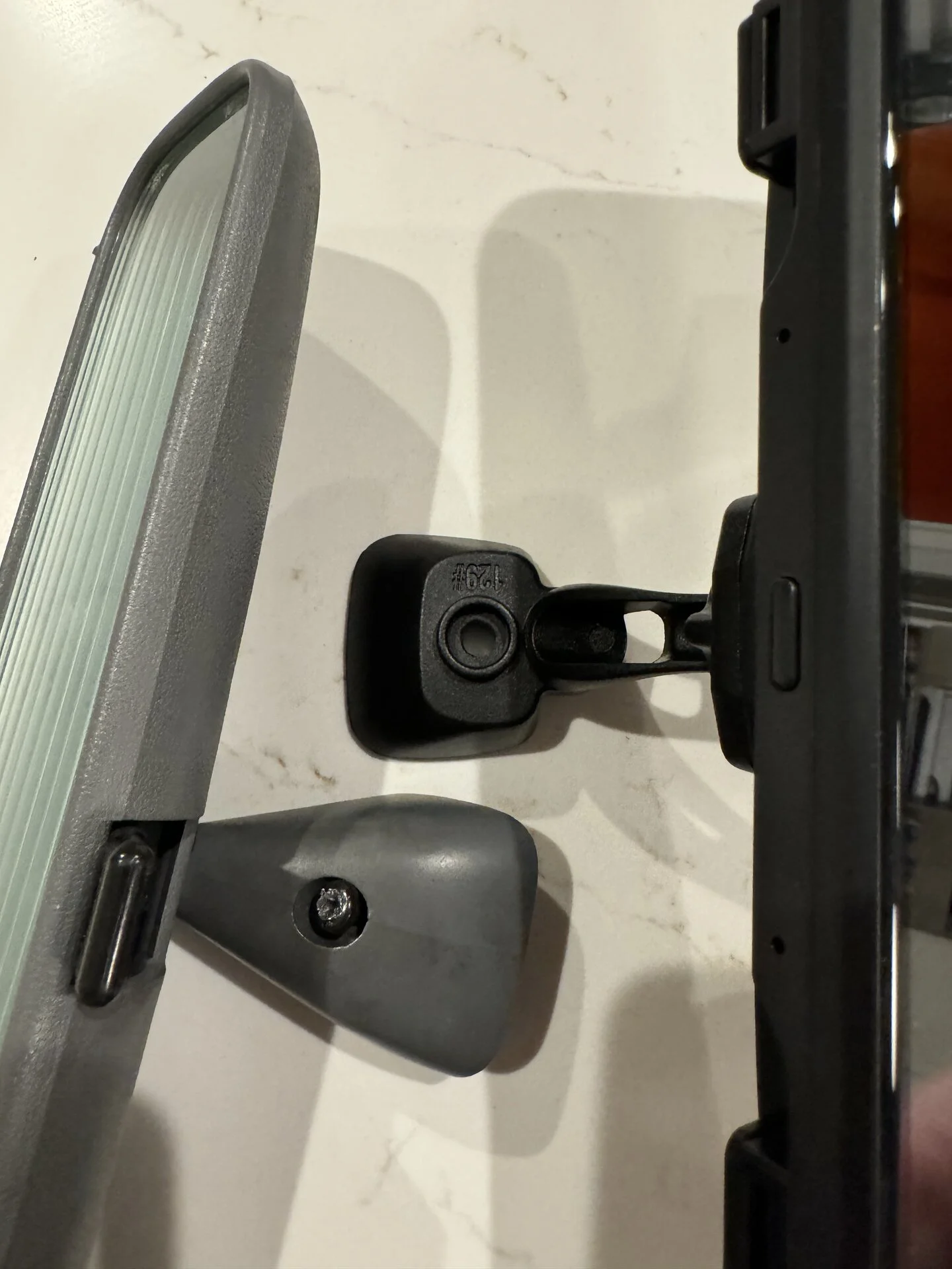

However I am concerned about how this mirror is going to be held in against the glass. Seems like zero tension in the screw “tunnel” like the OEM one, but it’s definitely the right base. I have a replacement screw coming from wits end and will arrive Friday.
See pics:
Went by ace hardware this morning to see if I could Jerry rig the right screw. It works okay , but I think I need the right screw to apply the right amount of tension onto the mount.
I receive the OEM style screw from wits end for a final test this Friday night. If that doesn’t solve the bit of shaking and little bit of looseness, the right depth 3M auto tape will solve it.
Pretty stoked. Video to follow …

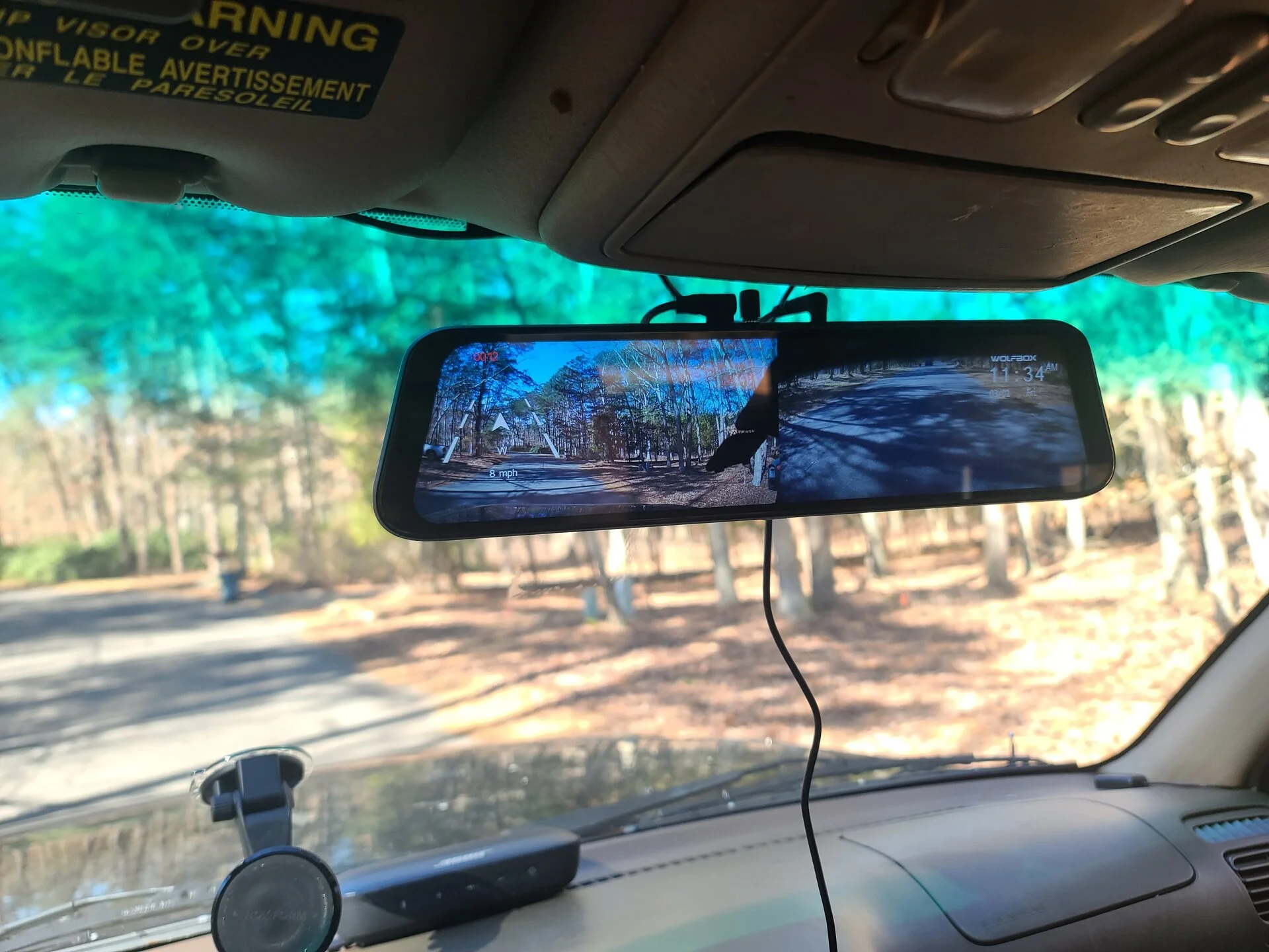

Here is test drive video. This has a ground down angled tip that I had the ace hardware guy do for me .. definitely not a great fit. 3M auto tape helped a ton though from preventing unnecessary rattle when hitting bumps/dips.

I have been rolling around with the 3M tape and incorrect screws. The setup is working perfectly.

Received the wits end mirror screw.

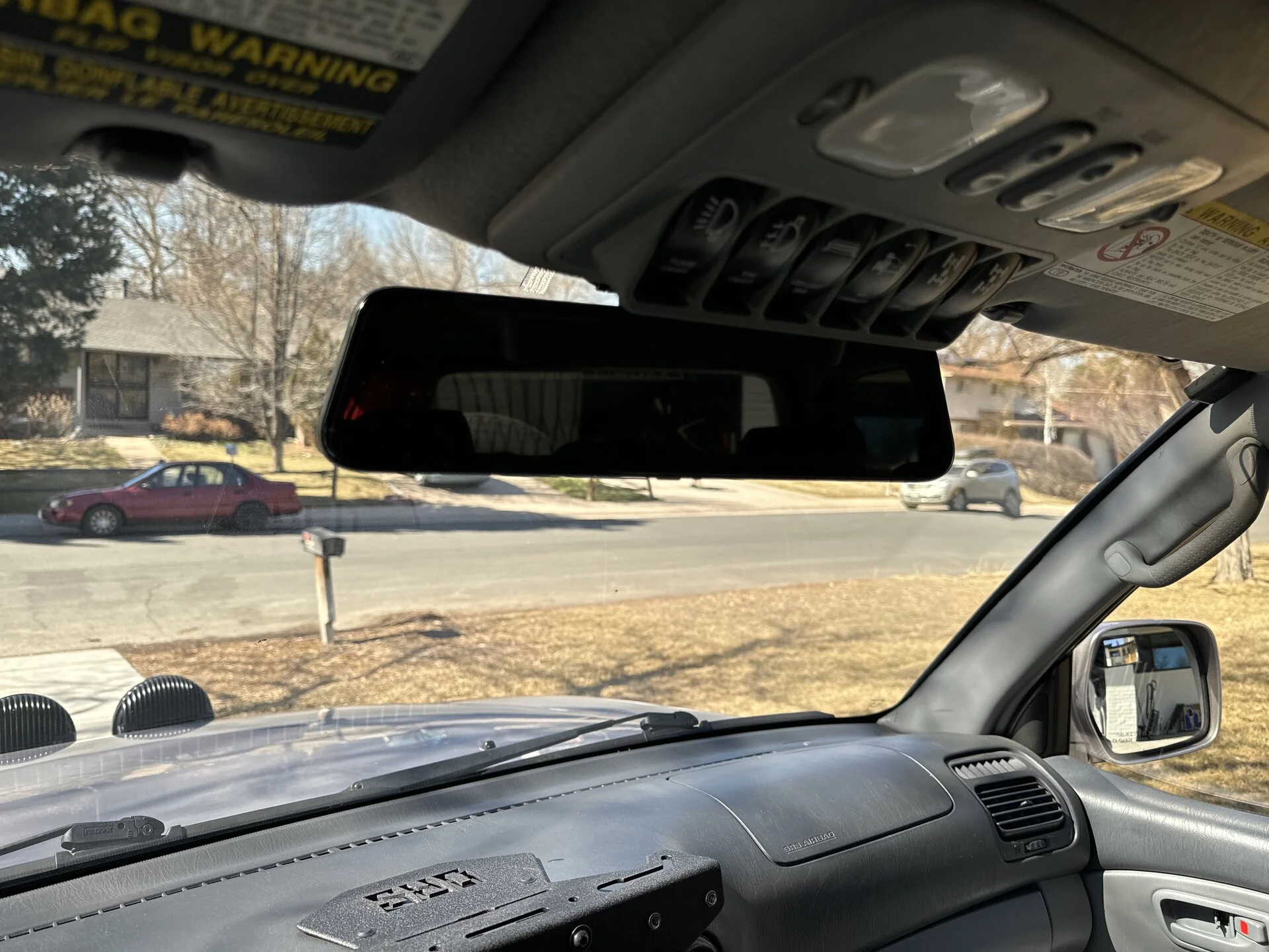

Happy to report, this is it. #129 adapter from whichever vendor overseas with a new screw. Zero wobble. Perfect fit.
Thrilled!

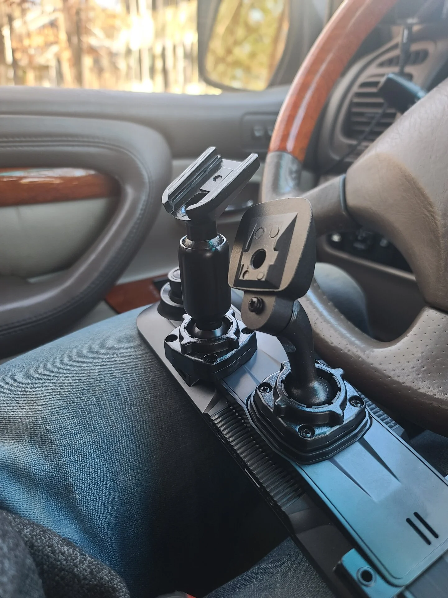

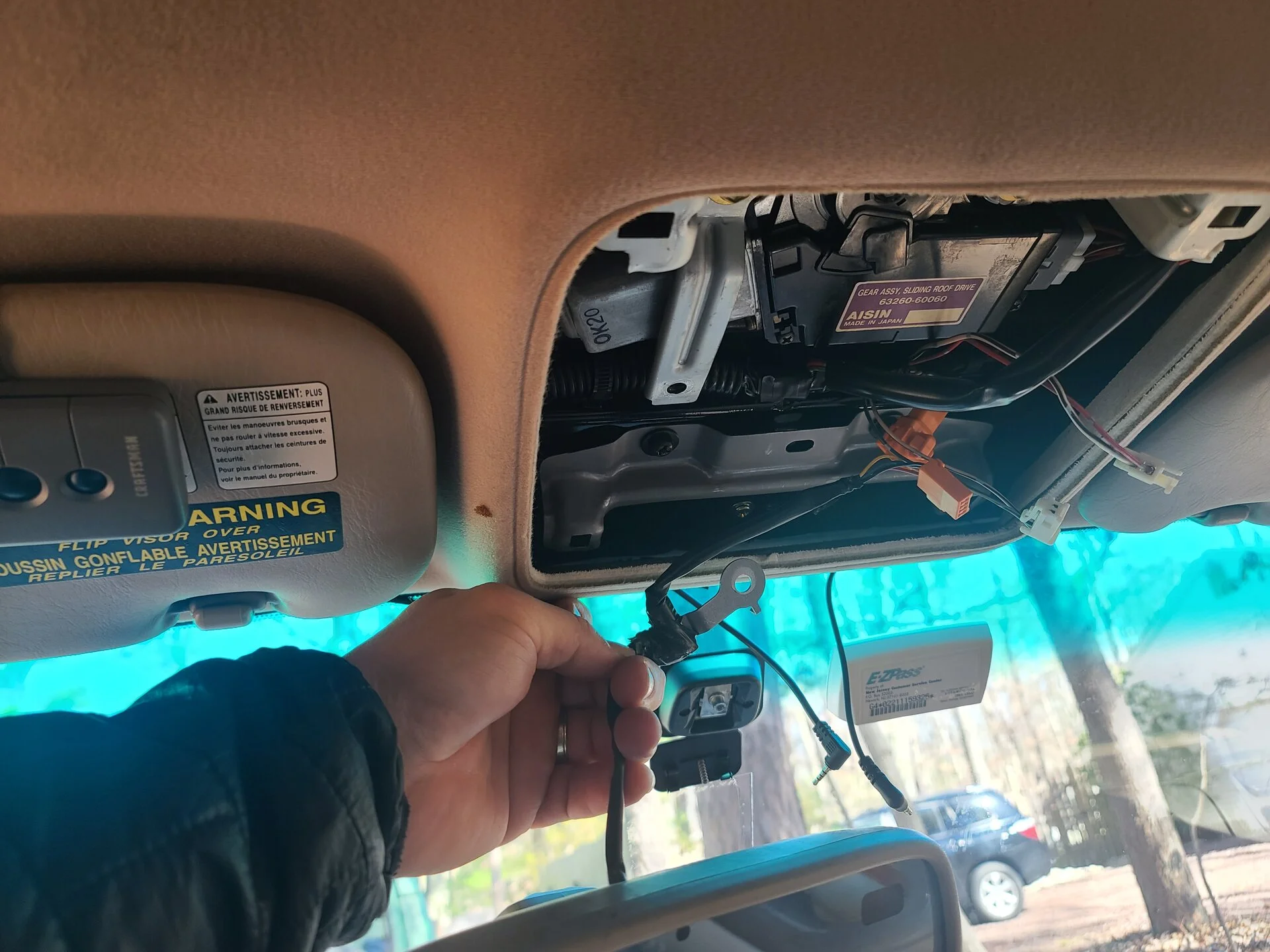

Received my mount as well. Though the ebay listing said it was coming from China, the mailing address was from Ohio. Still took awhile though. I attached several pictures from the install in my LX470. I also included the side by side of the Wolfbox Toyota mount that would not work. Overall much better than strapping it to the OEM mirror, looks much cleaner. Now just need to hide the power wire
I hardwired mine to my driver side fuse box (to the left of the pedal box)
