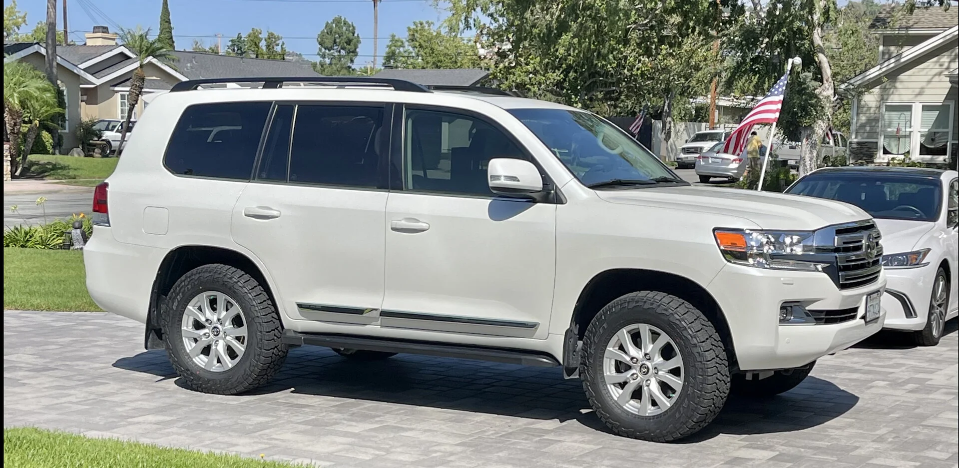

I just installed these spacers today. I got a full 1” lift out of them. We’ll see after a few days when they settle. Alignment appointment tomorrow morning. Took me about 2 hours following directions posted on these forums.
In my experience they will settle to 1/2-5/8".
man I would be disappointed if it ended up being 1/2”. That’s a lot of work for such a small amount of lift. I went for a short drive and the front seems to nosedives less. is that your experience too?
I mean they are only 10mm which equates to .39" so considering they settle to 1/2" or slightly more I'd say that's pretty good. They do help firm up the front end some which does reduce some of the dive.
The lower strut bolt hitting the LCA roughly half way out means there is a motion ratio approaching 2:1.. so a 10mm spacer should give about 20mm of lift.
Go much further and you risk bottoming the strut before the bump stops. Bad news.
I believe the ratio isn’t quite 2:1.. when I did the job the spacers added a pretty solid 3/4” to my truck after settling.
The spacers are 3/8” thick and should get you 3/4” of lift. Because of the suspension geometry every 1” of coil length gives you 2” of lift (so yeah what @bloc said)
I never netted that much, mine settled to 5/8" at best.
