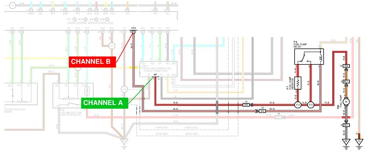

Now that I'm back from my trip and since this is still an issue I've decided to get out my new O-Scope (Pico Scope 2204a) to start testing things.
1st Test
  • Chanel A: Fuel Pump Voltage
  • Channel B: Fuel Pump Relay Trigger
  • Expectations
    • Channel A should be at reduced voltage ~8v until the ECU triggers the Fuel Pump Relay at which point the voltage should rise to ~13-14v
    • Channel B: at idle and low throttle positions should not show continuity with ground, under higher throttle inputs the ECU should trigger and we should see channel b drop to ground (continuity with ground)
Heres the EWD with probe locations noted

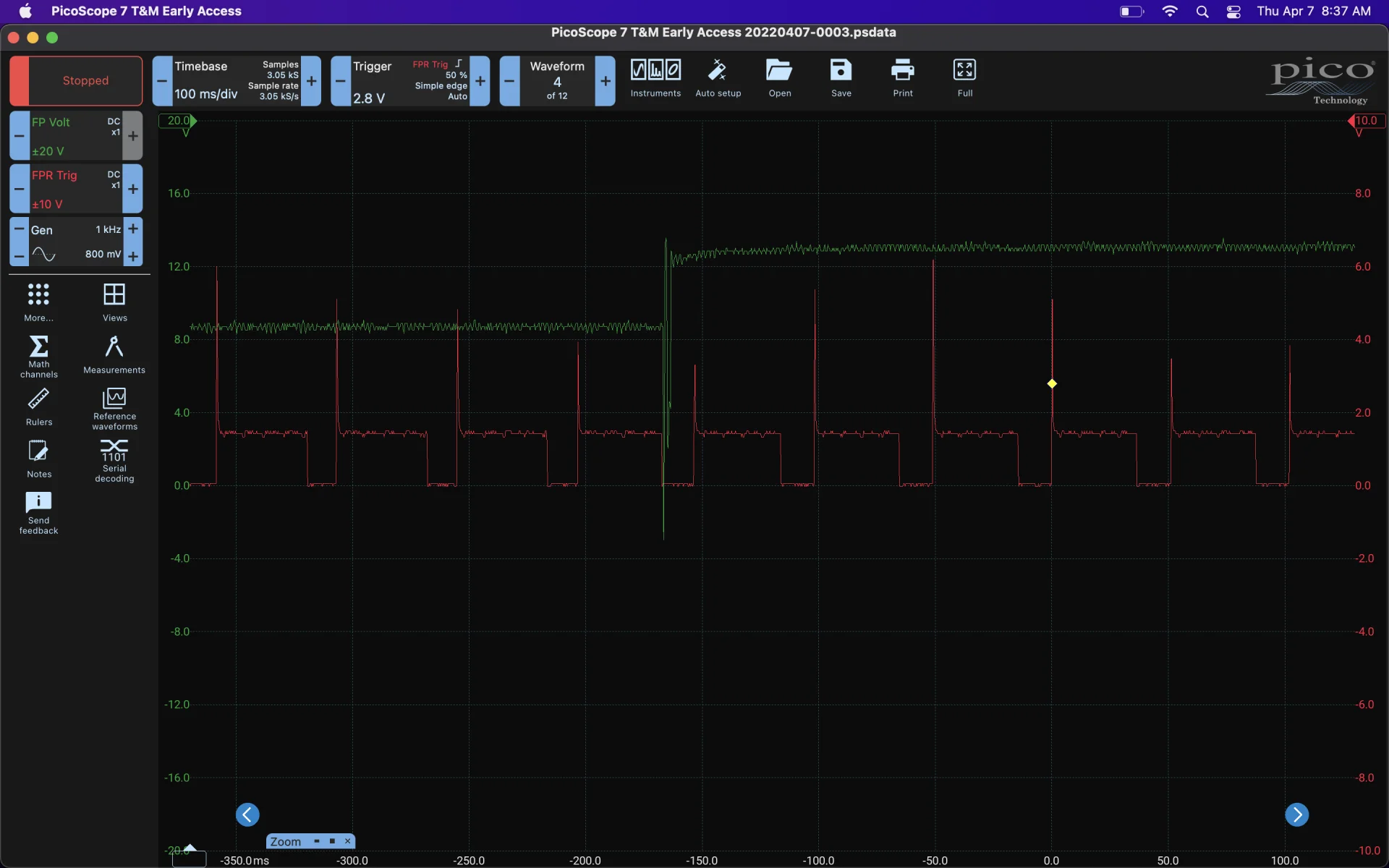

Test 1 Results
So the relay is switching correctly however I'm confused by the signal channel B is picking up for the fuel pump relay trigger. I'll have to check to see if the pin is in all the way and on the right port. I expected to see channel B drop to ground when channel A rises to 13v, but instead it seems like we are looking at one of the injector's waveform. This could also be pointing to another issue with the injector wiring, which I've already dealt with previously and can be seen in this thread: Calling all you Diagnostic Gurus | SOLVED Stumbling on hard acceleration
Update: Turns out I pinned 11A which is the injector for Cyl2 both are the same color wires... I'll need to re-run the test with the correct pin.
Yeah it looks like you're on the wrong pin at the ECU. You should see 12v with the relay off and ground with it on. But the fact the voltage at the pump changes tells you the relay is working. The Pico is great for checking sensors. Check your oxygen sensor for proper switching, and check your TPS for smooth voltage change with no dropouts. Log the VF voltage at the check connector as well. That will tell you your fuel trims. Also check your coolant temp sensor voltage during a warm up.
