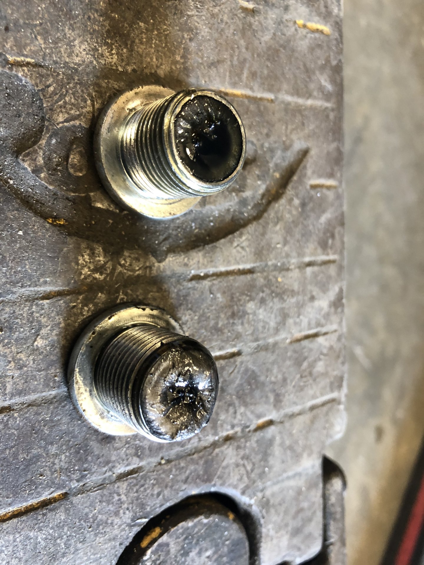

Drove over the pass(10% grade) Friday and couldn’t keep the transfer case in high range 2wd or 4wd( front driveshaft currently removed) on the way down. Got to work and drained the transfer case as a bit of a check up. Had 1.9qt in the case and a light sheen to the oil. The fill plug had a small amount of shavings and “metal paste”. Around 2500 miles on the Orion unit
Reached for 90wt and couldn’t find any, so I filled it with Librication Engineers 1605 Duotec (non GL4/5). Not wanting to play with the transfer case again in rush hour traffic, I used a bungee cord to hold the shifter in place and had a trouble free drive home.
I get home and removed the bungee cord and coast down a steep 1/2 mile dirt road. The case doesn’t pop out. Drive it some more and same thing. So what’s the difference- slightly more oil(thicker) or the tension on the shifter pulled it all the way in the position?
Also, is this an exceptable oil for the transfer case? It did quiet it some(I think). I believe the manual says it’s supposed to be GL4/5 but that’s to protect hypoid gears and synchros. If I understand the terminology, then the Orion has neither. Please school me if I’m wrong.
More info. on the oil used ? how thick is it ? The paste is normal on the plug magnent, I am interested in trying the thicker oil.
Drove over the pass(10% grade) Friday and couldn’t keep the transfer case in high range 2wd or 4wd( front driveshaft currently removed) on the way down. Got to work and drained the transfer case as a bit of a check up. Had 1.9qt in the case and a light sheen to the oil. The fill plug had a small amount of shavings and “metal paste”. Around 2500 miles on the Orion unit View attachment 2777974Reached for 90wt and couldn’t find any, so I filled it with Librication Engineers 1605 Duotec (non GL4/5). Not wanting to play with the transfer case again in rush hour traffic, I used a bungee cord to hold the shifter in place and had a trouble free drive home.
The case doesn't but your front and rear output shaft components both have a need for GL/4
So I never could find any more info beyond what I linked in that earlier post. I just swapped the oil out for some Lucas oil. I was under the impression that we didn’t need the gl 4 or 5 rating on the oil since our cases are unsynchronized, but @1MOA posted that the cases still needed it. Rather than chance needing another rebuild, I swapped the oil out.
As to the performance- I can’t say it changed much with the Lubrication Engineer product. Tcase still pops out of gear and shifting seemed the same. Hope that helps.
After a few rebuilds and different oils I am now running standard 90w and it is quiet , little bit of gear whine in low 4th. The pics of silver dust are exactly what I get. I have found that when the rear drive line has spline loosness , slight rattle at deceleration at certain speeds, otherwise not noticable, that loosness under deceleration and the ensuing vibration on the output dont help. I would add that the orion has worked since install, other than the interior bolt coming out and wrecking gears the tcase has worked.
