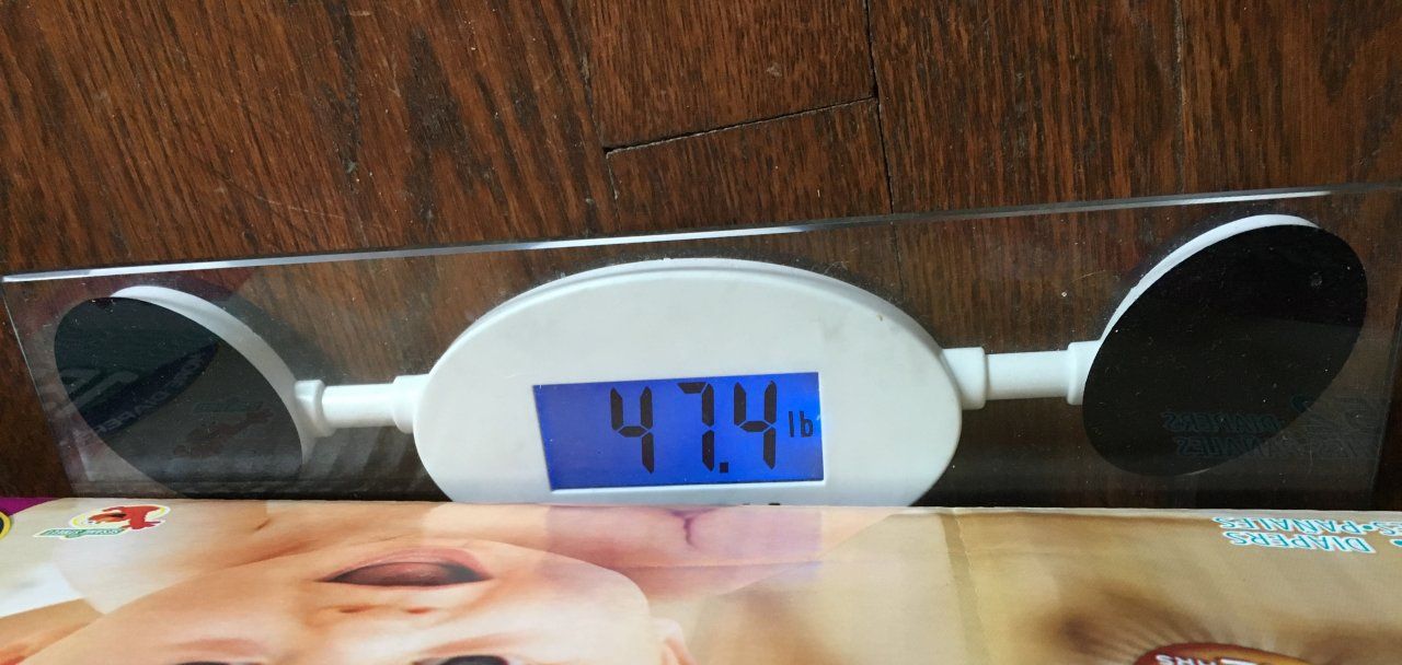

Finally got all my hardware prepped for cadmium plating. Woohoo. I would say I've got at least 50 hours in those alone.
The whole box came in just under 48 lbs. Damn.
I took the box to Jackson Plating this morning. They said it would be ready in a few weeks. Now, I wait...
