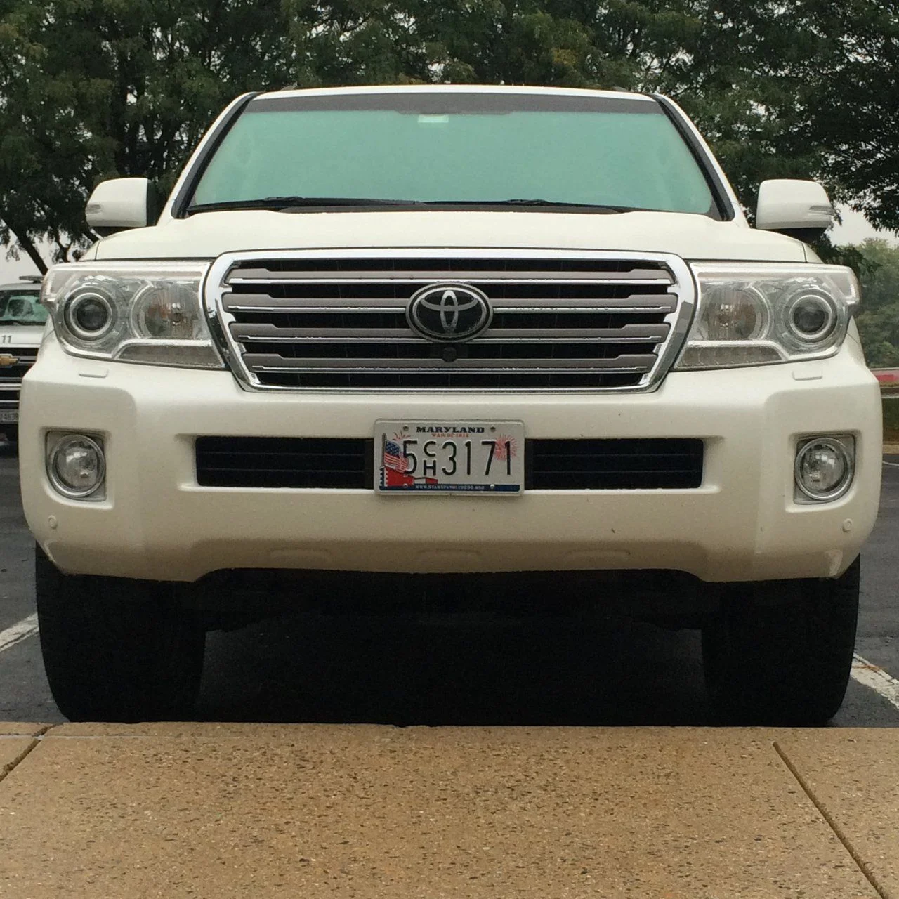

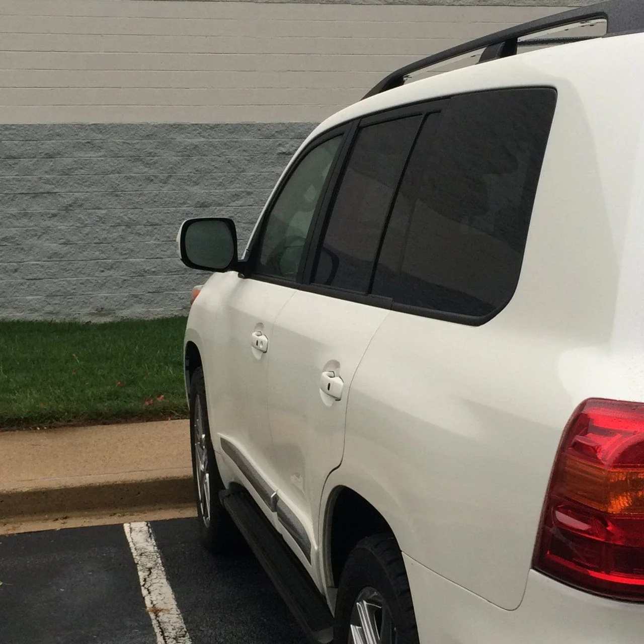

Notice anything extra or out of place?
original here on the forum we thought that 2013 and newer LC's came with it from the factory, that has pretty much been proven false. I have yet to hear of any new Cruiser coming with the spacers on it. You can kinda see if it's on there already(which it's not:)), see pic below. Tell him to order them up and slap them on the truck, it will lift it almost an inch!
original here on the forum we thought that 2013 and newer LC's came with it from the factory, that has pretty much been proven false. I have yet to hear of any new Cruiser coming with the spacers on it. You can kinda see if it's on there already(which it's not:)), see pic below. Tell him to order them up and slap them on the truck, it will lift it almost an inch!View attachment 1223005

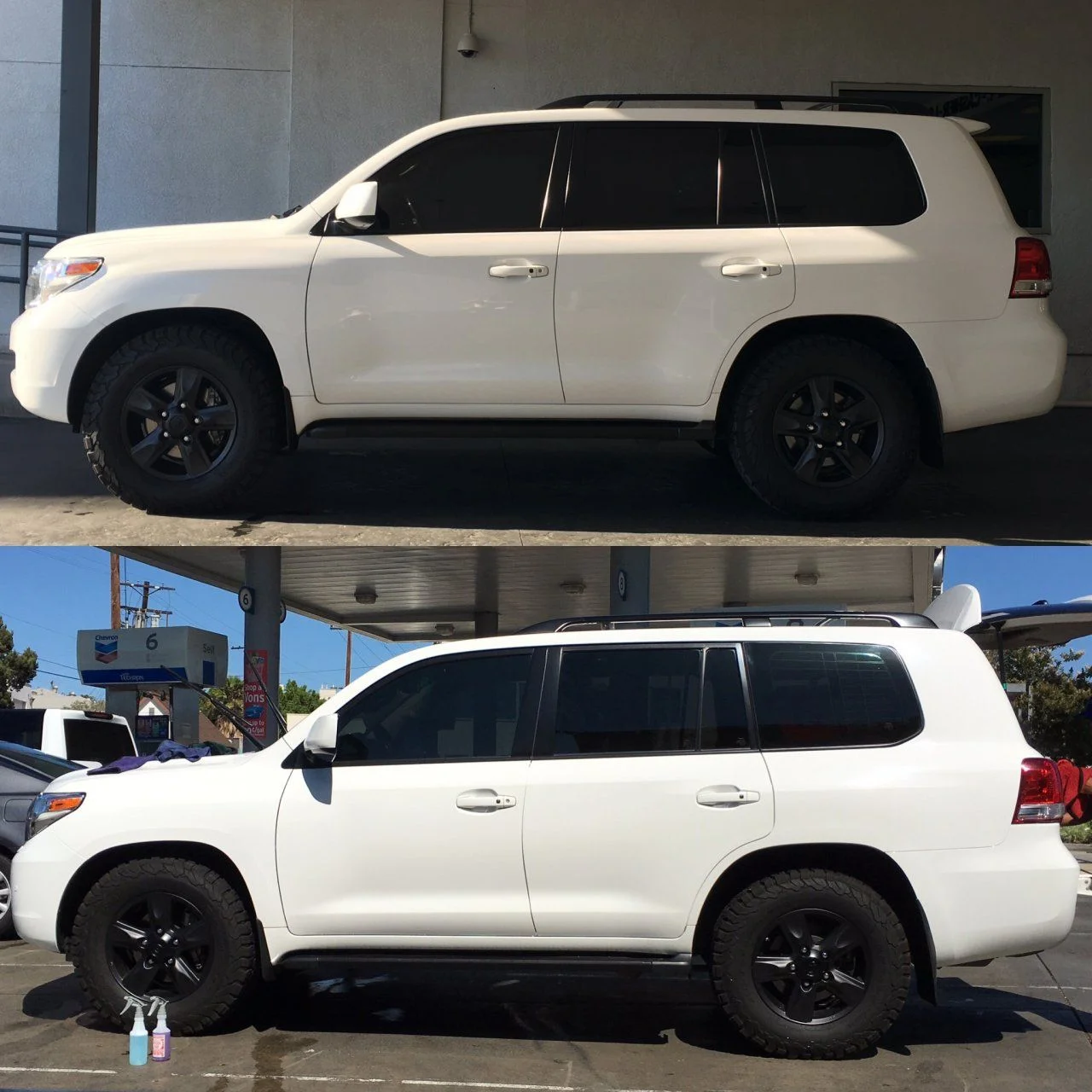

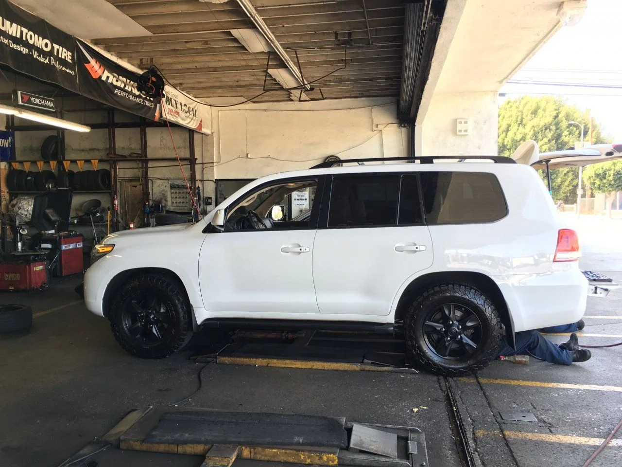

Dropped off my truck last night and picked it up today. Kreiten was correct - no spacers already on the truck. Didn't have the foresight to measure ahead of time, so I don't know exactly how much it lifted. I'm only 1/4" lower in front than the rear now, as measured from center of wheel to top of well - level enough for me. Extremely minor rubbing of the tires on the front wheel well at full turn. I will plan on trimming a bit plastic in the next couple of days.

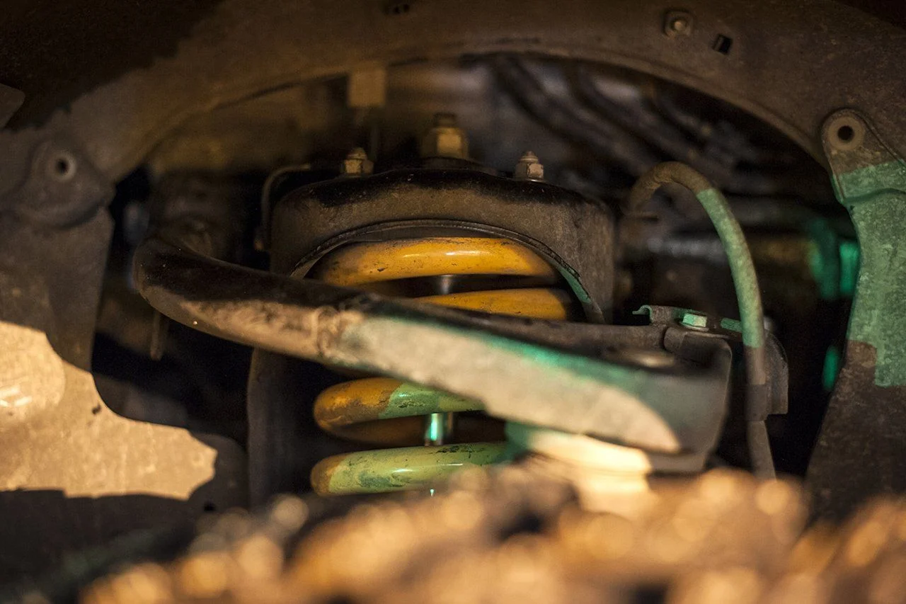

Not really a hard install, only issue is if your valves are rusted shut which is the problem I ran into installing my spacers. I plan to get fixed under warranty.
