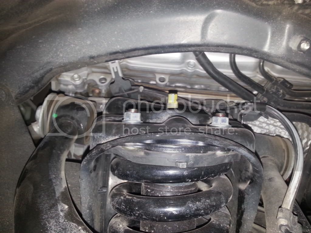

Finally I got it done!!
I got about 3/4 of and inch. I am now 20.5 inch from center of hub to fender lip. I'll post a pic of how much thread is left. Not much.

Beautiful and EXCELLENT NEWS!
