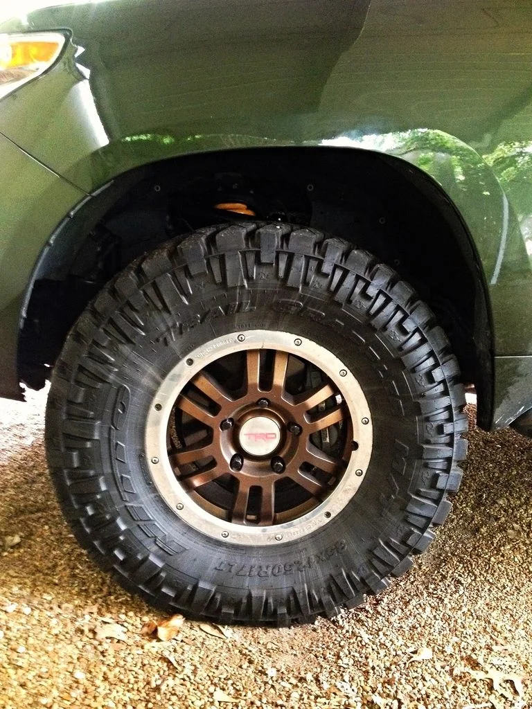

Notice anything extra or out of place?
Before, this is the only one I have from the same location.
Another before
I don't know but I'll get it aligned this week.
The LX570 has adjustable height and doesn't have to get an alignment everytime the owner changes height so why would it be different in a LC?
Another post spacer install. It's better but needs a little more lift. It will be more noticeable when I install the airbags in the rear.
