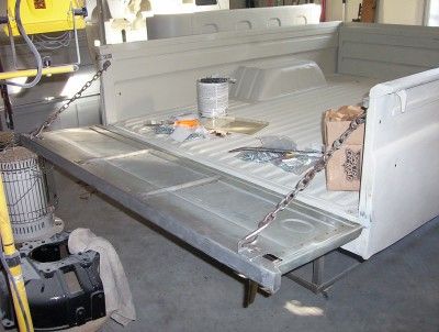

Here are a couple of pics from today.
first one of the tailgate being on and down
