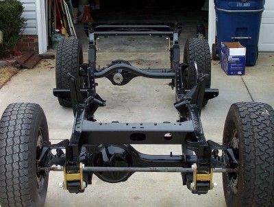

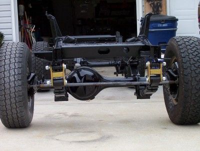

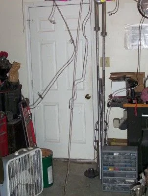

Got another couple of coats on the frame and then went thru the axles completely and built them. Cleaned the brake lines up and built the wheel cylinders.

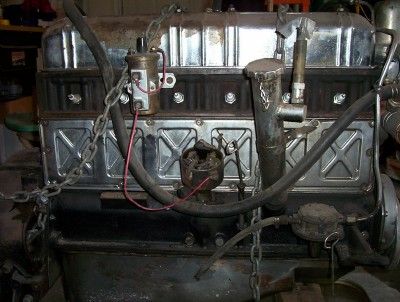

Started tearing down the engine, it was built before just shortly, so i am just going thru it and resealing it and checking it all out. Right now it is disassembled in the garage. Hopefully putting it back together tomorrow.

Just got done loading the engine in the dually for the trip to the machine shop. Engine needs to be rebuilt, cam bearings are shot, cam is shot and if i am rebuilding everything else in this thing, going to build it now also, even though PO said it had been gone thru.

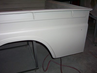

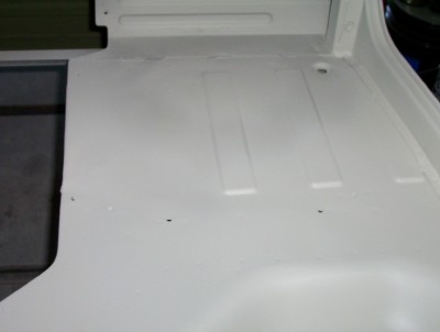

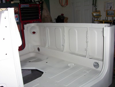

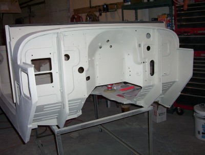

Well again it has been awhile since i have posted something, not because i have not been working on it, have just been doing a bunch of body work. Not something i think most of you really want to see.
Not too sure if i posted this on here before but here goes. Got told by the PO that the engine had just been gone thru not too long ago. Ya right. Wanted to replace all seals and gaskets and freeze plugs. So i go and pull the cam out because you need to to get the one gasket done and it needed it the worst. Well long story short, cam is cracked and cam bearings were shot. Going to pick the motor back up from the machine shop this week, and then rebuild it. They tore the bottom end apart and they said the main bearings were flaking apart, so i guess i got lucky kinda. Makes sence though, rebuilding everything else on here, might as well do it also.
Ya right now that is just primer on the body, got about another 2 - 3 coats on it before i will consider it enough. I am going to go with one solid color thruout the entire cruiser, both inside, outside ,inside the bed, and under it totally. I am going to go with the mustard color that was on them later on.
