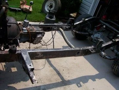

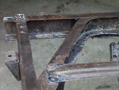

Ok , sorry to keep you all waiting for an update on this thing. :) :)
I have been doing a bunch of work to the frame for the last few days and is it ever hot out there. I think tomorrow I have to go get a new air compresser, this small 30 gallon one that i have had for almost 10 years now is on its last legs, esp when i am trying to sandblast with it and it is just continually running. Right now it is just sending water out . I wanted one of those 60 -80 gallon ones anyway. :) :D :D :D
As you can see the frame is not that bad at all. I just got done ordering a gallon of that rust bullet also for this frame. I guess we shall all see how this works on our side of the states. It says you don't have to do much prep for it but i am going to prep as much as i can, ya'll know what i mean.
