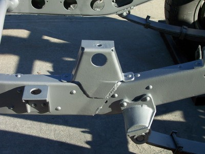

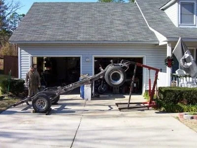

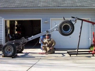

Well, I am starting back up on this thing again, Been working alot on the frame, dang things are a pain to get just right. Spent all day yesterday sandblasting it for like the third time,was going to again today but it looked relly good so i went ahaed and put some rust bullit on it to try and stop the little bit that i sould not get to. Wish we had a chemical dipper around here big enough for a frame sometimes though.Last saturday ordered 4 grand worth of parts for this thing so hopefully soon they will come in and i can really get going on this thing steady like.Don't have pictures from the last few days but here are some from today. Am still thinking about painting this thing black for the final coat on the frame.

And yes before any one comments about my redneck way of hanging the frame. Yes i am a redneck, and yes i can still move very fast when i need to. Dang thing wanted to go for a little spin on me yesterday when i was under it. Good thing it never went all the way but did i move fast and the neighbor came out of his garage real fast when he heard my brace fall. All in a days work.

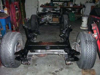

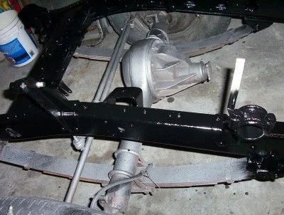

Well here are some shots of the frame. After the frame dries for a couple of days i will put some stands under it and start removing the axles and work on rebuilding them.:) :) :)
