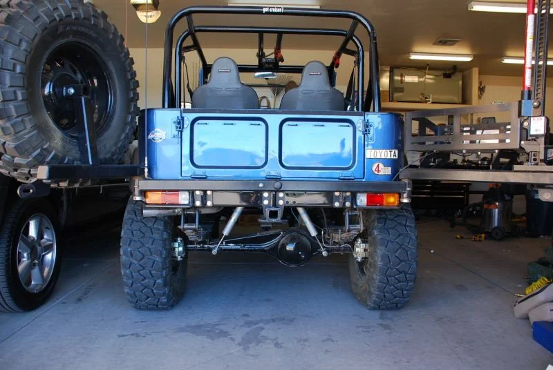

I'm glad I didn't know that when I started the project on my BJ74. I thought the frame width was the same as a 40. It must be a tiny bit wider because my 60 series axle is dead center.
Hey lowenbrau, That doesn't look too bad. But how did you bolt the spring on the inside of the passenger leaf? pics?
"official" trackwidth of a 70 series is 20mm wider than a 40 series.. That being said, I do not trust the numbers I just spouted.
LB, can you measure the inside to inside dimension of your leafs as close to the pumpkin as you can?
