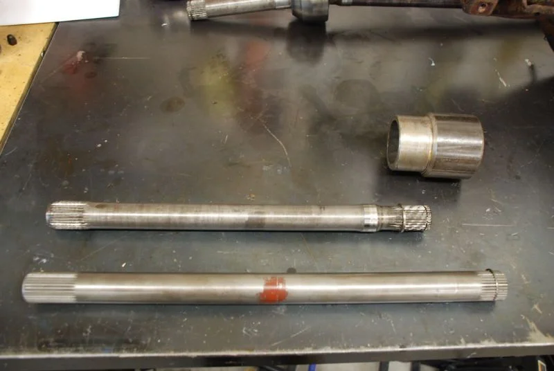

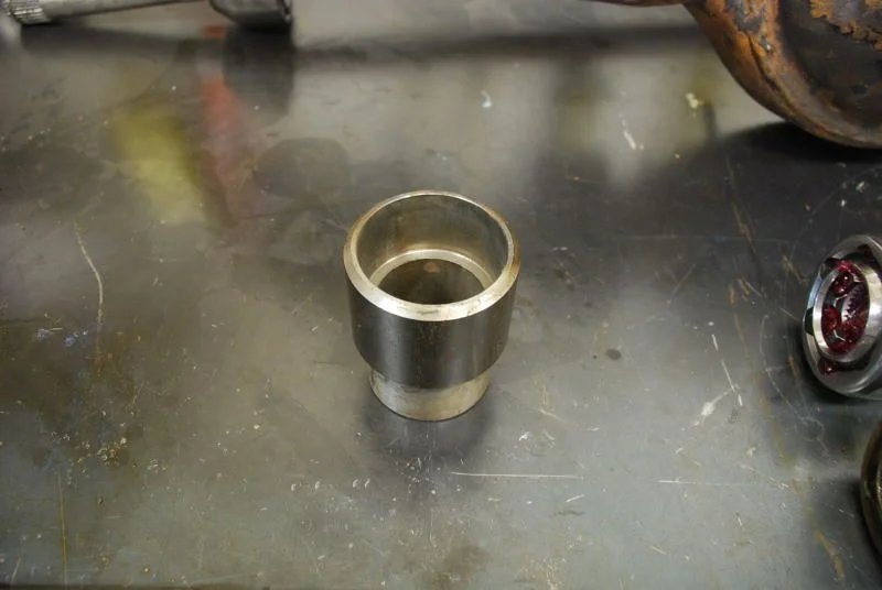

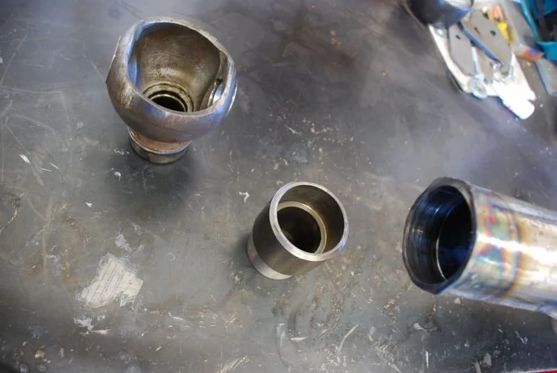

Hey zcruz I have what I think to be a perfect solution. Dave Gore makes an extender sleeve machined from 1/2" wall DOM to extend an fj60 land cruiser axle housing about 2 3/4"on the short side, Longfield makes a custom length 30 spline super axleshaft for the short side. Now you can put your perch where it belongs on soa w/ a fj60 front housing. (no knotching) Yields about 5 1/2" wider housing than a fj40.
You can also use your fj40 housing and do this to both sides and use a stock length fj60 super axleshaft for the long side.
This is not my idea, its Dave Gores creation and I think its awesome!!

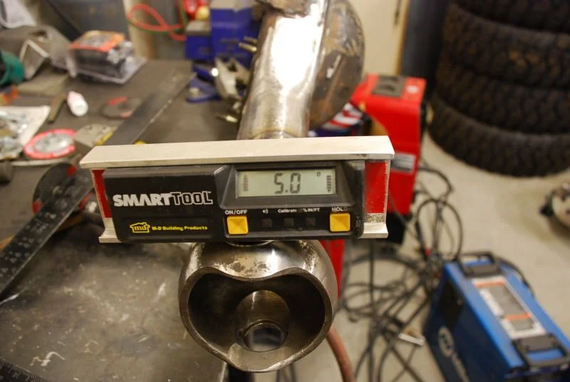

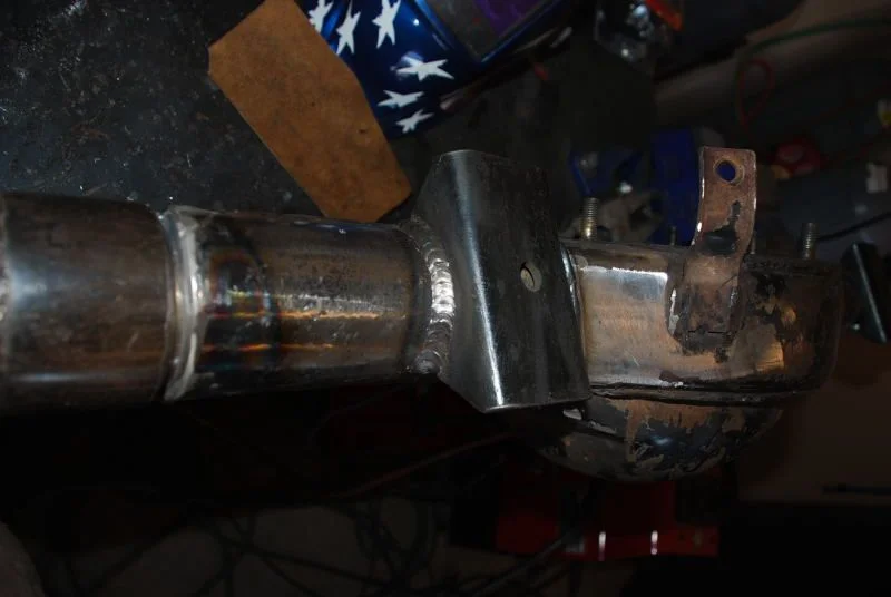

fab up truss for top of housing. gonna remove the factory truss on the bottom when i'm done welding. Its a fj62 housing
Its at the sand blaster now I put up some more pics as I go:beer:

Wow! That was fast! And a much better idea than notching. plus I was planning on using the 1.5" wheel spacers with the 60 axle, and with the sleeve I wont have to run any. I'll take two, where did you say you got those?
I've already got an 80 rear. It's wide! I'm running a 70 front but its too narrow and I'm planning on running 39's so I need the right front axle to build and put money into. The 70 has the 8" high pinion and it hits my exhaust on full stuff. Not much room to move the exhaust. I'm going to long, lock, cut and turn the 60 anyways so the sleve will be just one more weld in my process.

It is sweet! As mentioned in this thread it is 2 3/4" long. Same length as the difference in a fj40 vs. an fj60 housing.:bounce2:
