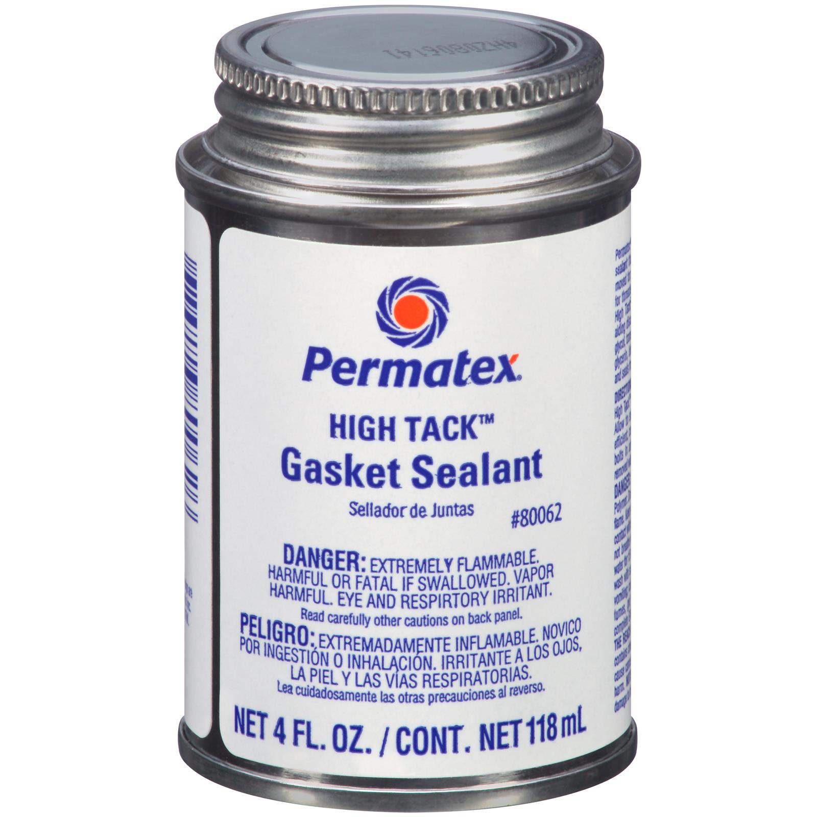

How much tolerance do you think the gasket gives you when installing it correctly (@F226continental method)? I mean, it's a refined tractor motor from a 1939 GM, not a Ferrari... The file method seems pretty solid to me.
What do you guys think of using permatex's gas resistant gasket sealer in conjunction with the toyota gasket?
That stuff will burn off in 50 miles and leave leaks. If you're gonna use anything at all, use K&W copper coat High temp in a can with a dauber swab.... NOT the spray stuff.
It's a lacquer based sealer and cures rock hard and won't burn/blow out.
Amazon product ASIN B000M8IGVU
I second the copper coat good stuff for a quick fix, but after filing it will be better than new. ( because it is seasoned, aka it’s probably done most of the moving it’s gonna do in the first 30 years of life) Put a new gasket on and Trust it for 250 k
