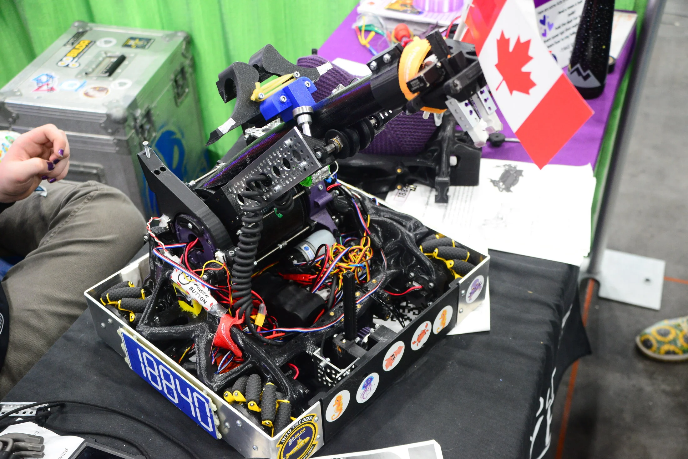

First FTC competition. Reynolds Reybots came to Texas on an Inspire award, and are leaving world finals with a 1st place Innovation award.
They put everything they could into it. The 3D Printed chassis was created using generative design and it is extremely strong. The carbon fibre arm was the only one like it. They had problems in almost every match that they worked to overcome.
In their last match, an opponents robot hit their mandatory power switch and they were unable to demonstrate their third level ascent.

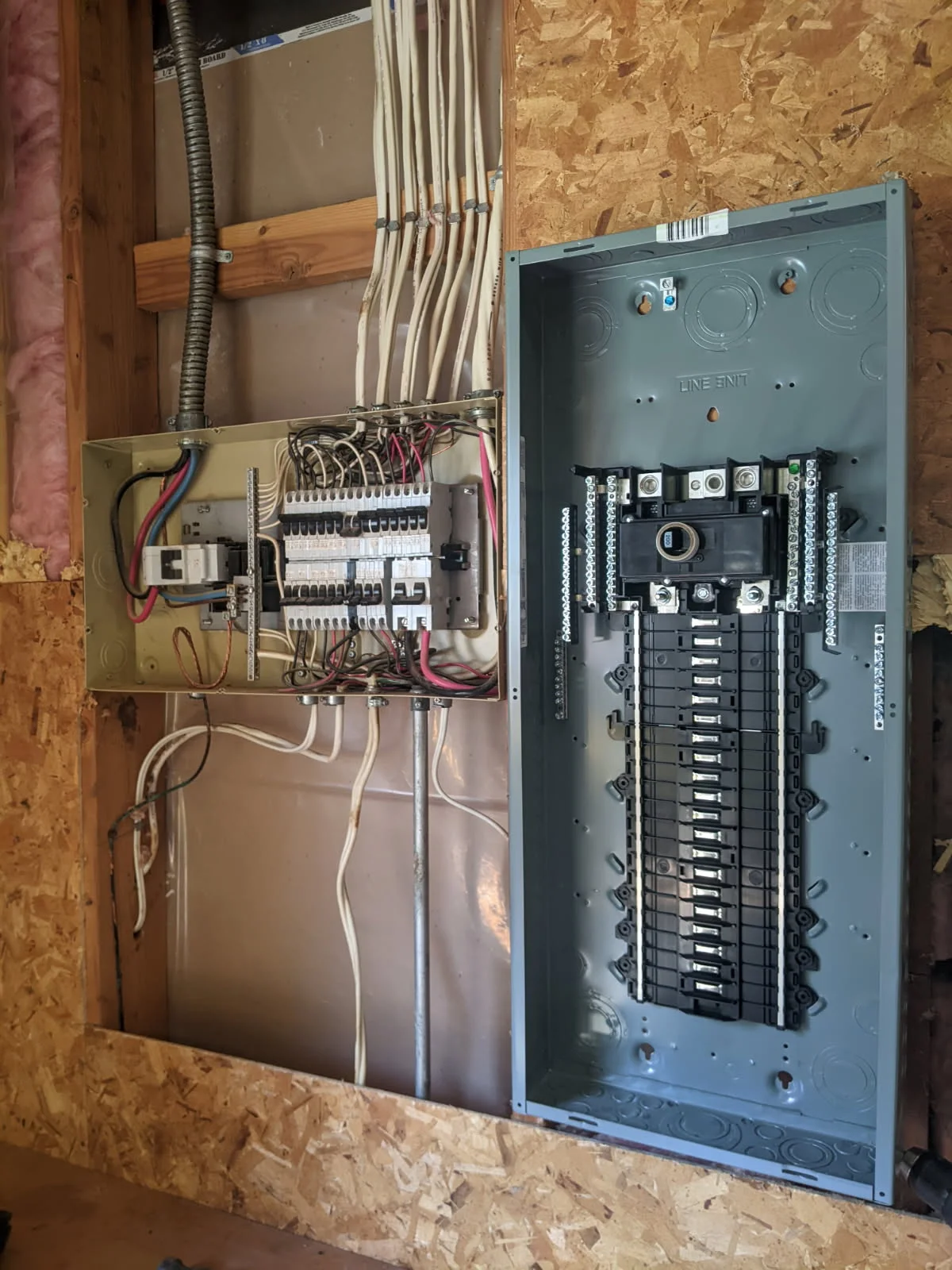

Mmm. Rat poop.
Out with the fpe stablok death trap.
Table saw breaker is getting weak, not worth replacing on this scary old piece of crap.

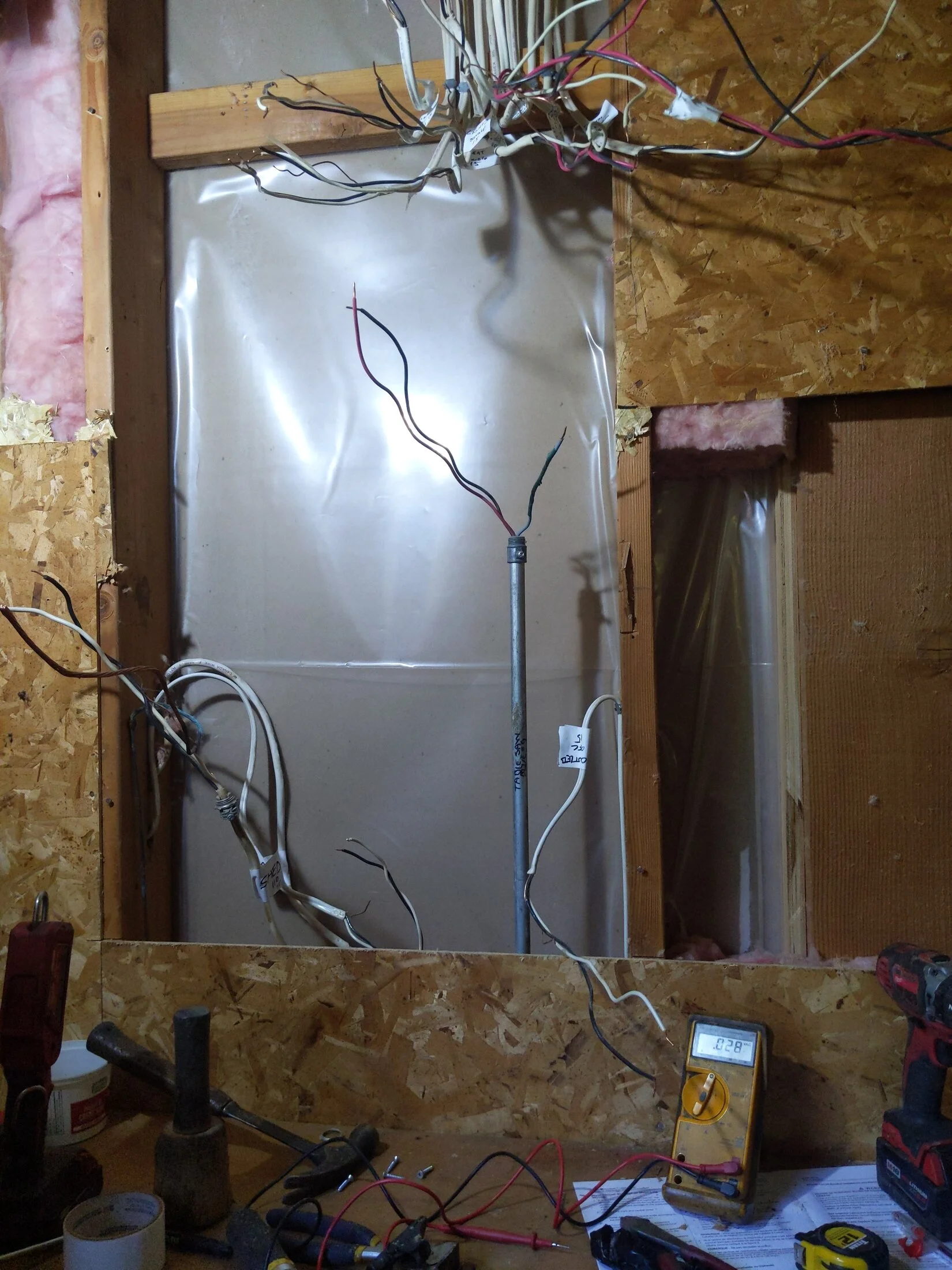

Had hoped to mount the new panel vertically, but I think I'll have length issues, so horizontal it is I guess. Unless my wire stretcher becomes more effective 🤪
Special thanks to whoever decided to use that 1 piece of EMT conduit I'll have to shorten without cutting the wires.🤬
Finally will get a proper welding circuit too. Suspect I've had some pretty brutal voltage drop at the end of miles of skinny wire.
Totally explains why I'm a sh!t welder 🤣🤣

You could add a gutter box above the panel and splice for length…I’m with you on the damn sideways panel board being “wrong”

Yeah once I got it in place and laid things out, I realized I'd need a junction box even if I put the new one in horizontal .
So if that's the case, ****it.
Putting it right way up. What's a few more connections.
