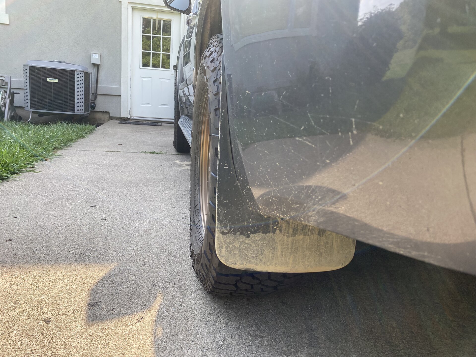

@nvsmythe Do you have any pics of the side showing how far the tires extend past the fenders?

You can use a heatgun and some massaging to make more clearance. Here's what I did on my previous 2009:
Front is just a hair outside the fender, the rear you can’t see behind the mud flap.
Ignore the dirt and Mud, I just got back from the Kentucky Toyota Trail Ride last weekend and haven’t washed it.
