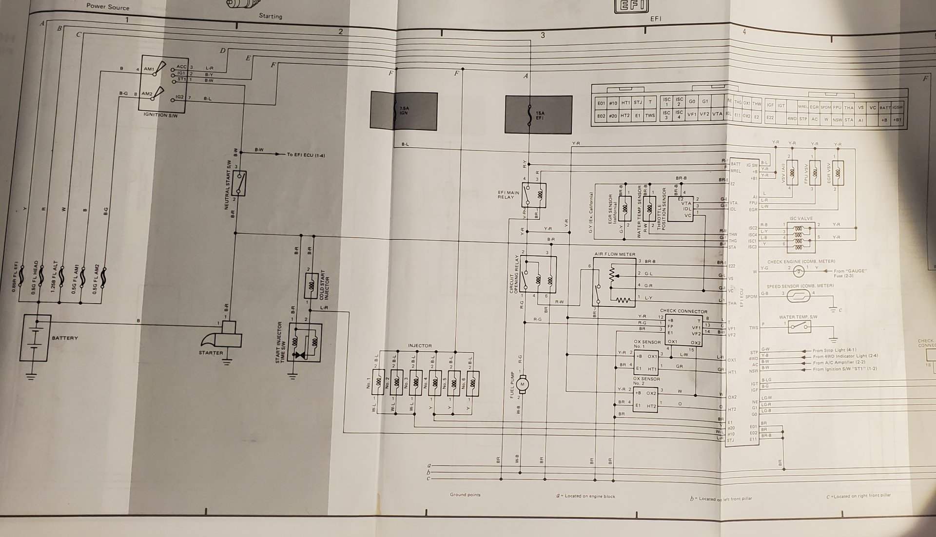

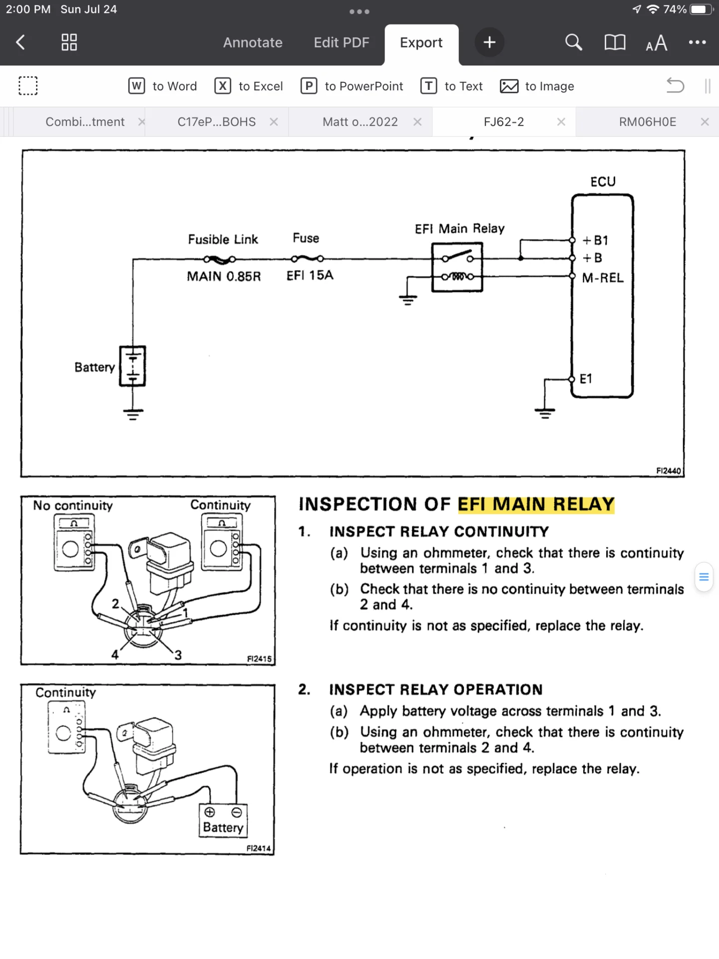

I would start checking continuity from this wire diagram and work my way down. theres probably a cleaner version of this diagram online lolView attachment 3064680
I used my headlamp and the advantage of cooler weather to go outside and fully disconnect my battery, separate out the fusible link (had to put some pb blaster on a nut and let it sit overnight) and I managed to disconnect the EFI relay as well. Tomorrow morning after a job interview (so I can continue to afford my Cruiser habit) I’ll get back out there and test the fusible link connections, the EFI relay and if I don’t die of heat stroke I’ll remove the AFM and finish the plate testing on a bench.
I’ll also work my way down the continuity testing chart.

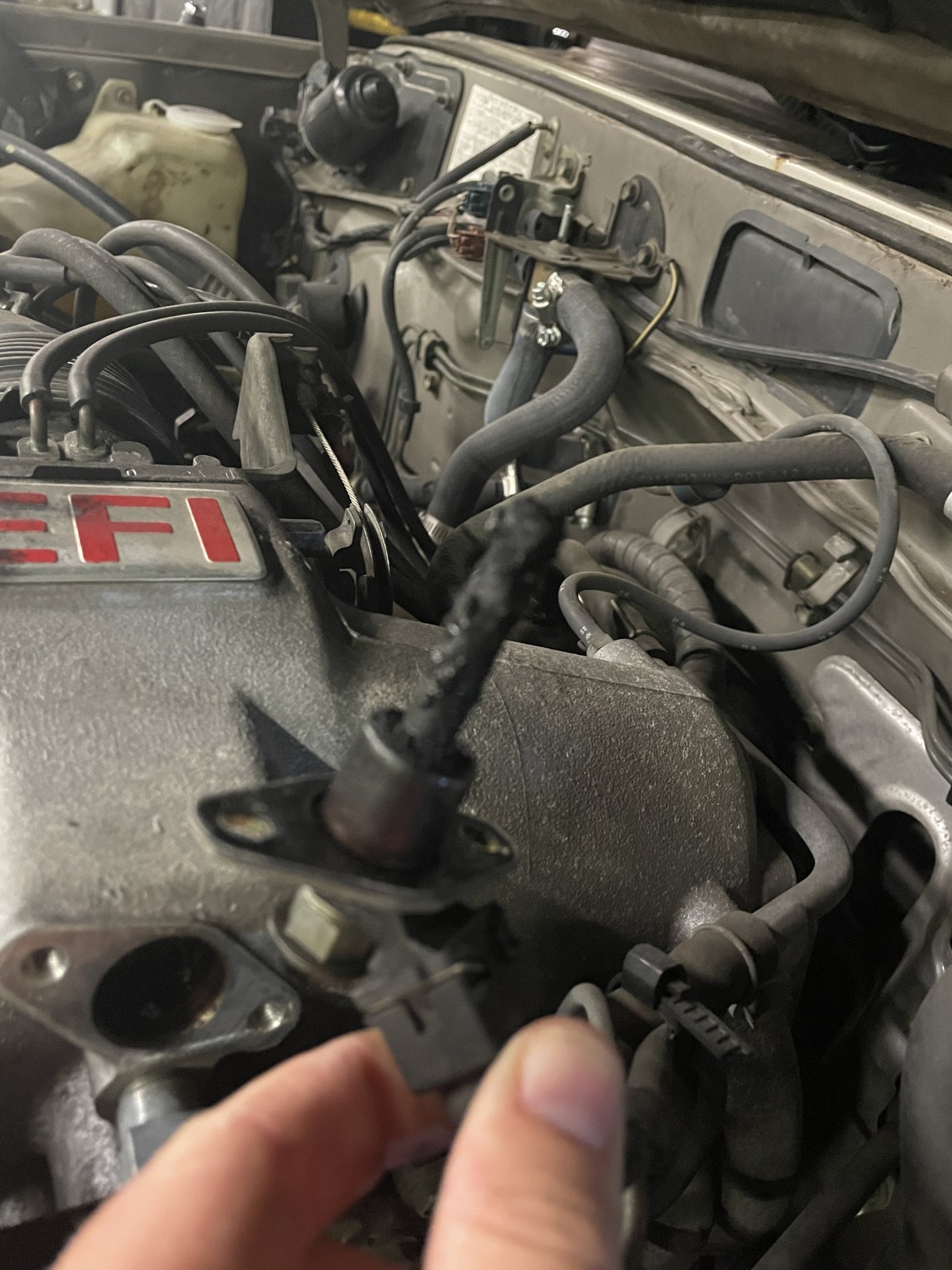

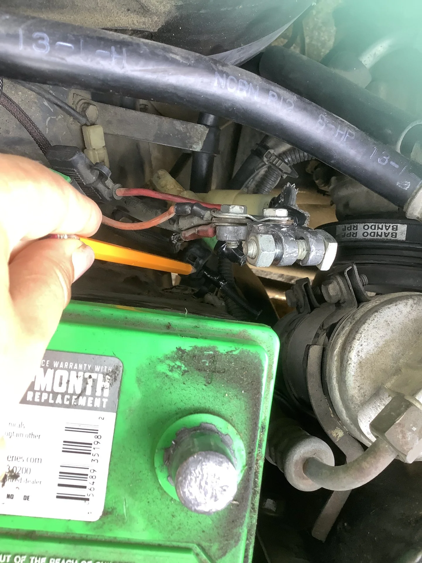

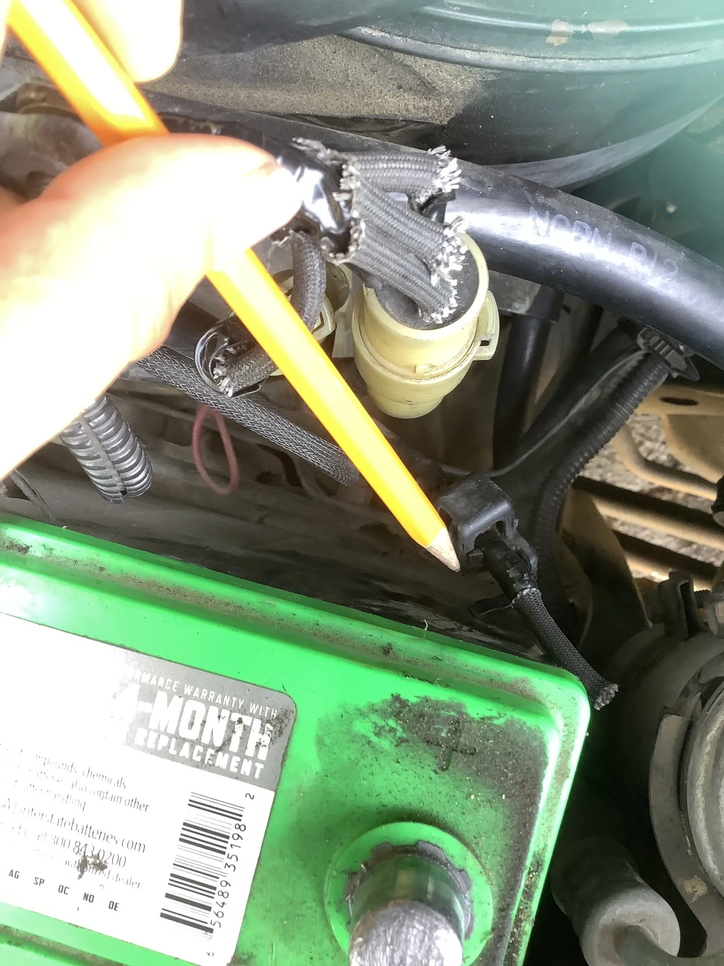

Update time: I've been lazy because it was so hot but I finally got back out there today and did something dumb. There was continuity between the fusible links...until I decided to disconnect them to make sure they looked good and clean it up a bit. Of course, in doing so, I broke the terminal lead that connects to the alternator. Yay....
Continuity exists between the COR and the fuel pump. Connectors look good. Continuity also exists between the AFM connector and the COR. All fuses tested okay.
Going to check all the grounds and order new fusible links.

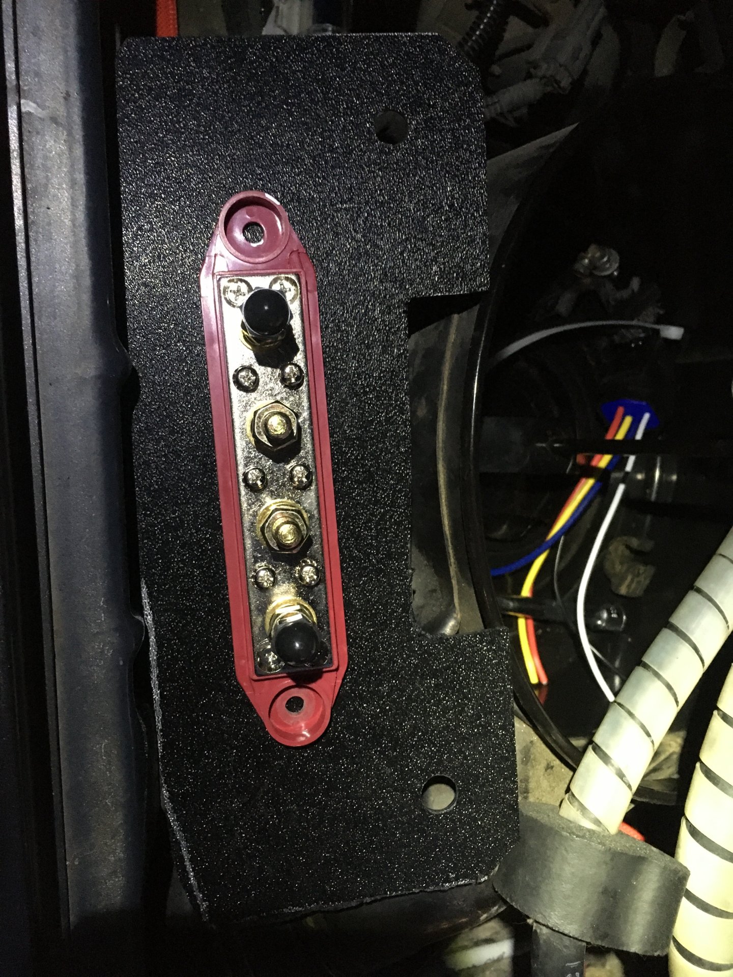

Update: still waiting on fusible links. I jerry-rigged a fix to my broken alternator fusible link connection with some 14 gauge fusible link wire from autozone just to get it started for diagnostic purposes. Going to replace my grounds as well and clean up the electrical mess with a tinned copper bus bar.

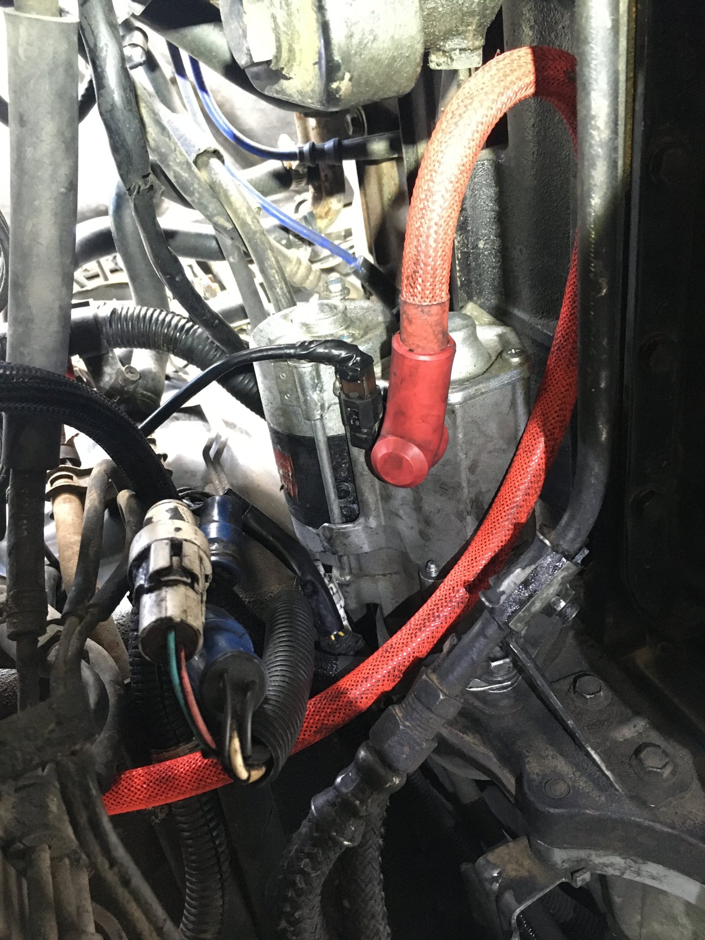

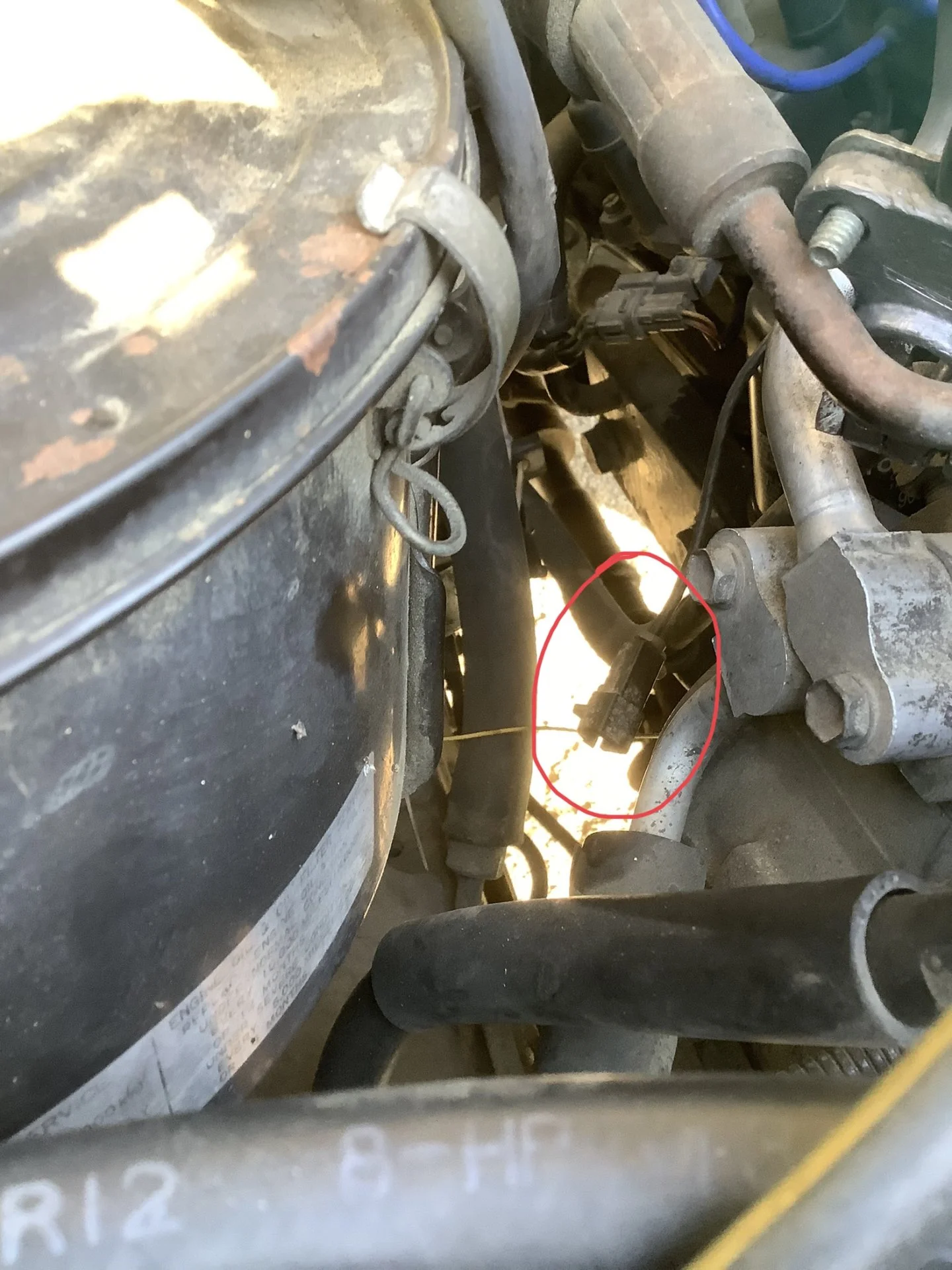

While poking around the engine I’m learning and absorbing. I’m also finding connectors that are unplugged and I’m wondering what they are for - I don’t think they are related to my issue but maybe! Any ideas?

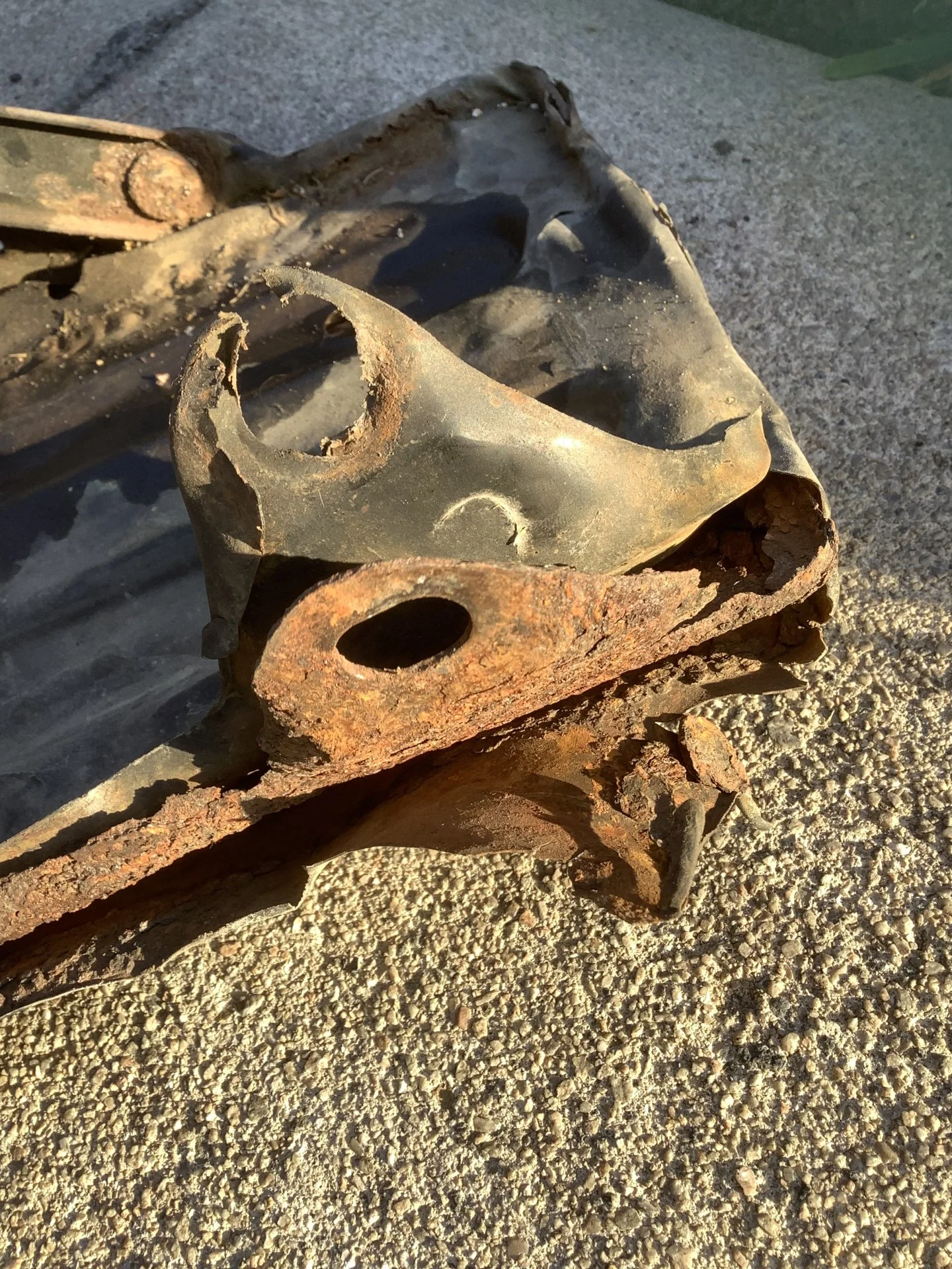

Also, hoping to start my new job on the 8th and really need it running by then. While trying to make sense of the wiring I found out my battery tray is not long for this world so I’ll be sourcing a new stainless steel tray soon.

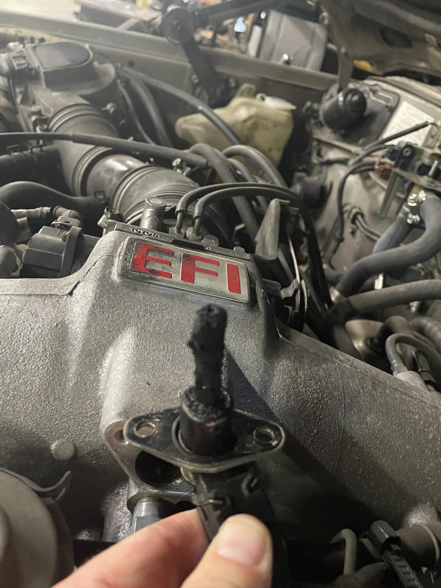

Ignore that electrical tape near the fuel pressure regulator - new air check valve is being installed. Soaking that 22mm fastener in pb blaster as well.

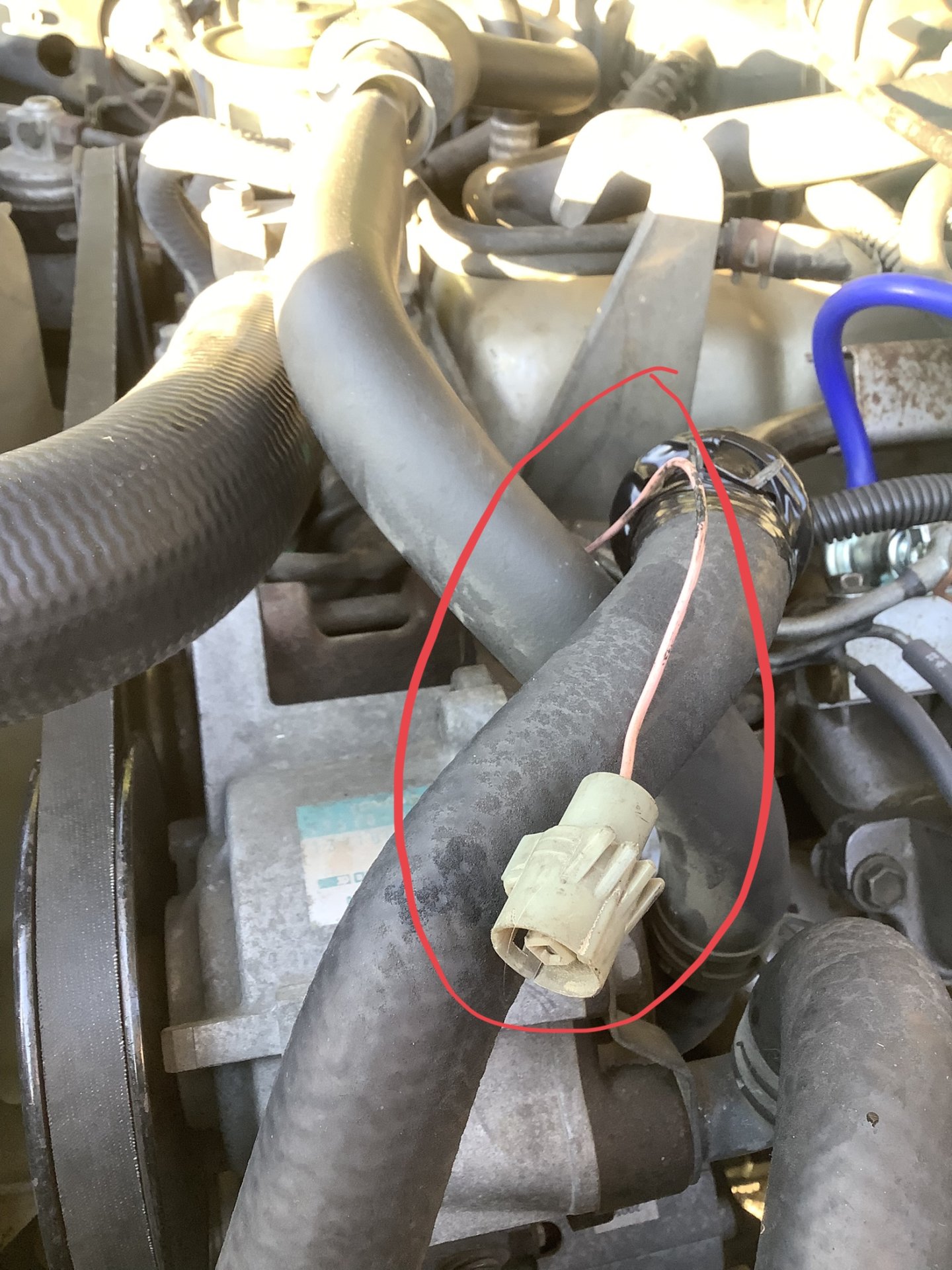

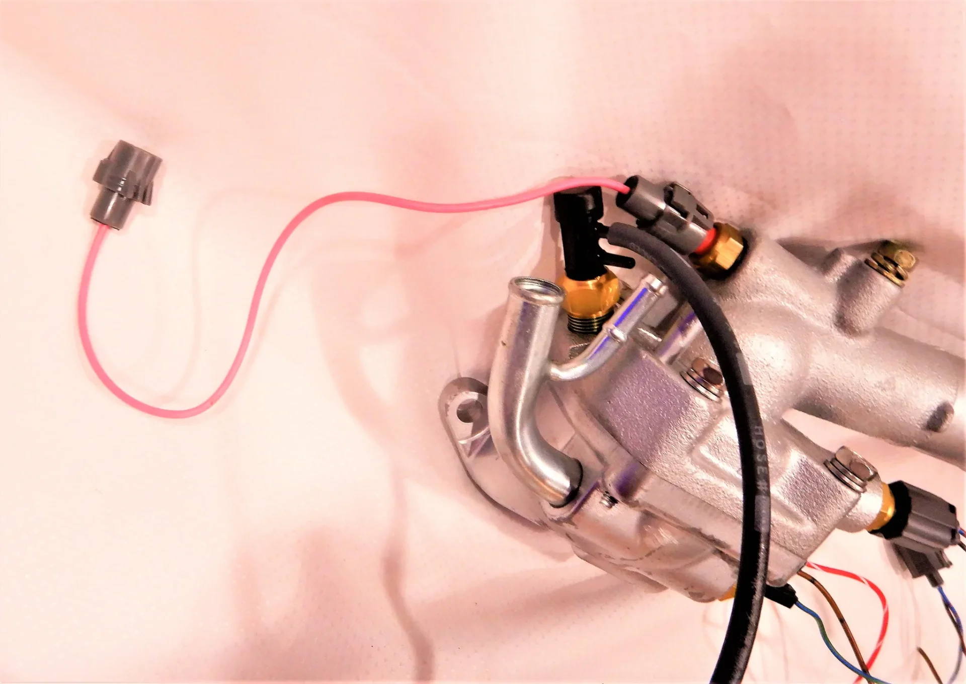

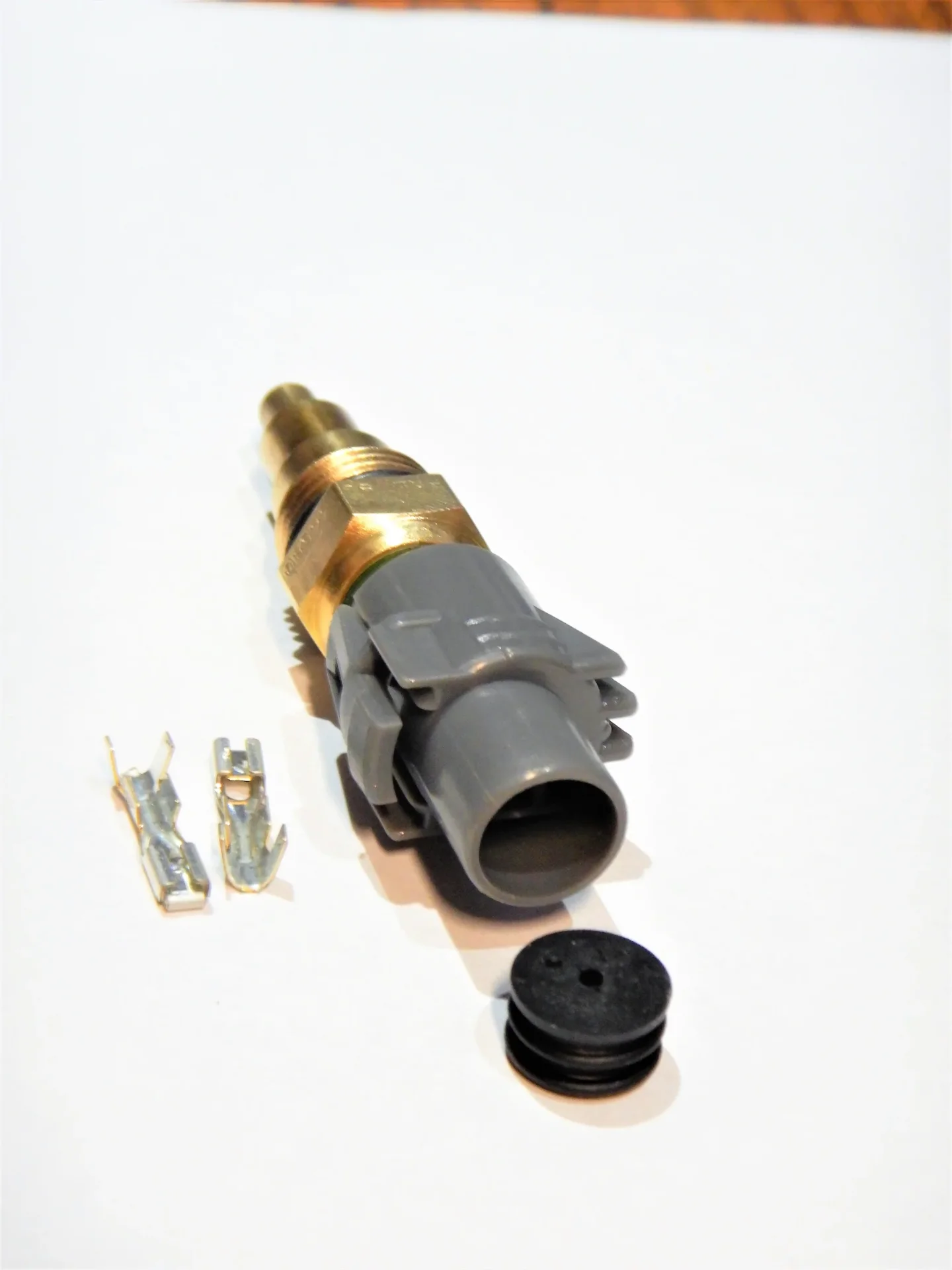

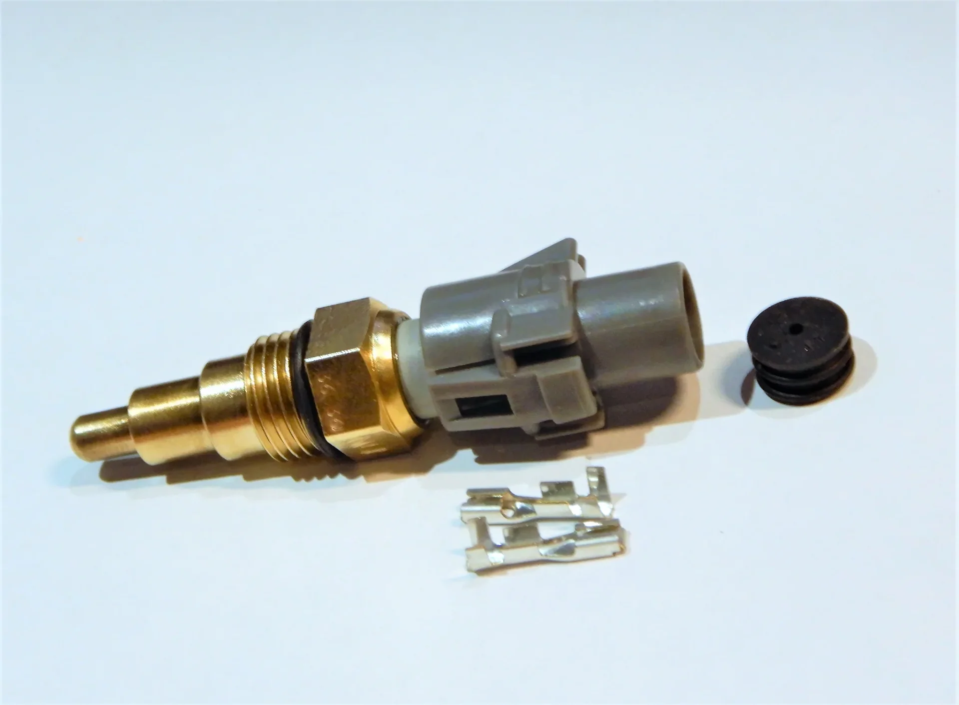

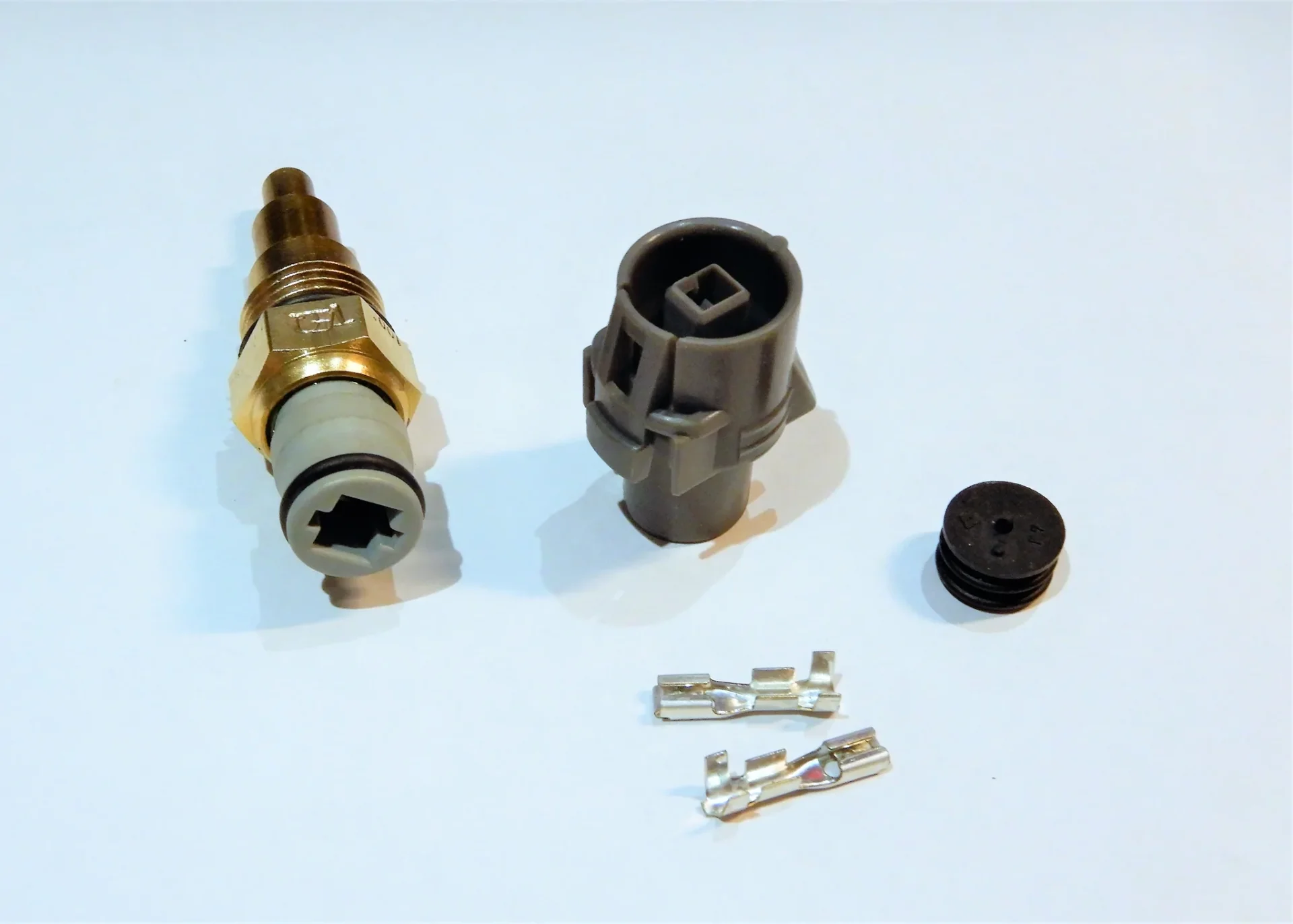

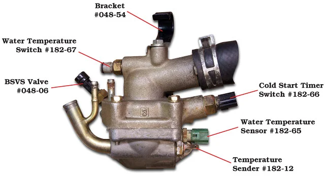

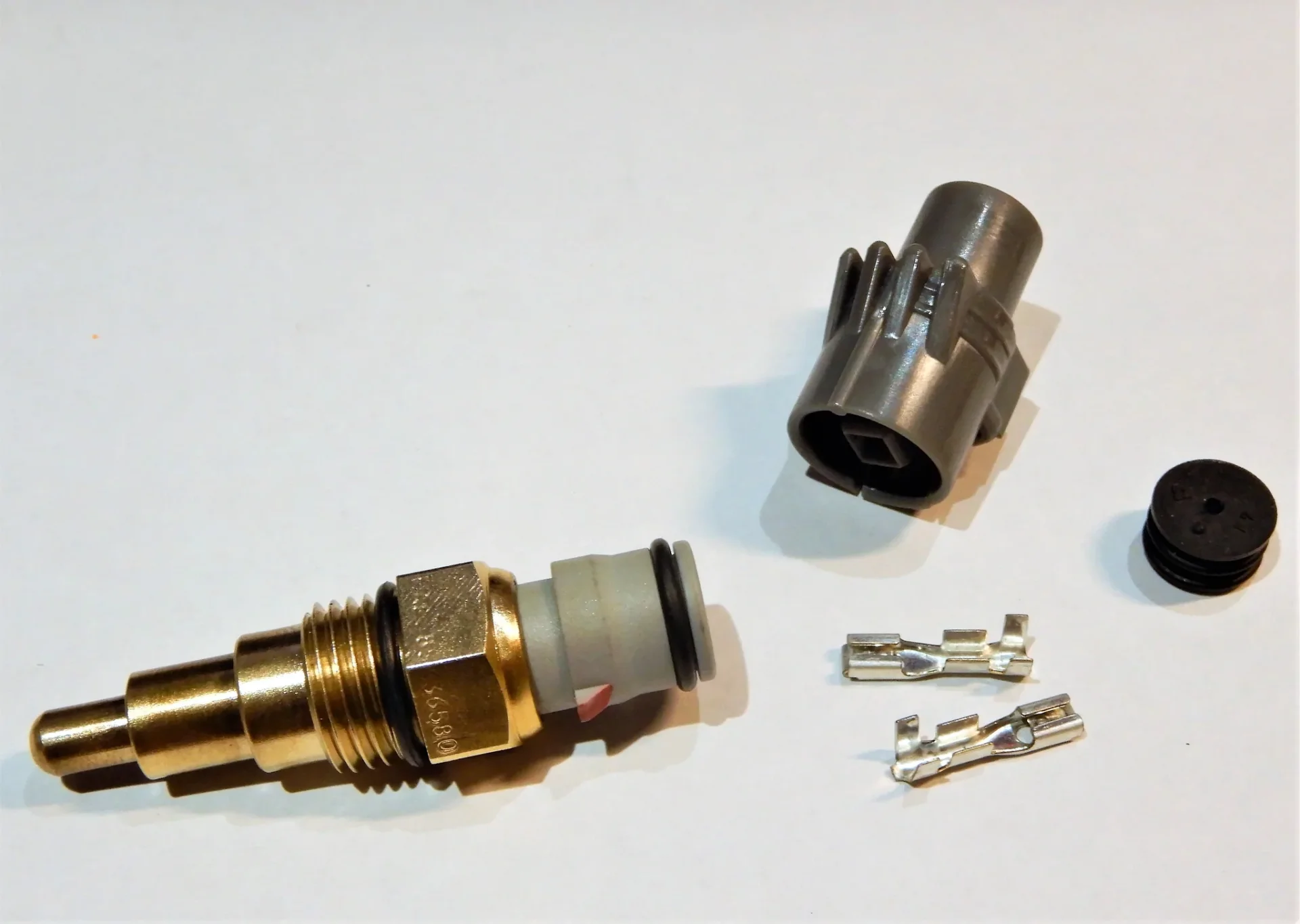

The pink single wire you have circled is your coolant temp switch. Super important for stating the truck. It goes in the top of the thermostat housing on the right (US passenger side) of the car. I bet that helps.
Dyno
Wanted to give everyone an update. I cleaned up the contact in the coolant temp sensor and put some dialectic grease on there. I re-attached the sensor to the top of the thermostat housing and made sure it was snug.

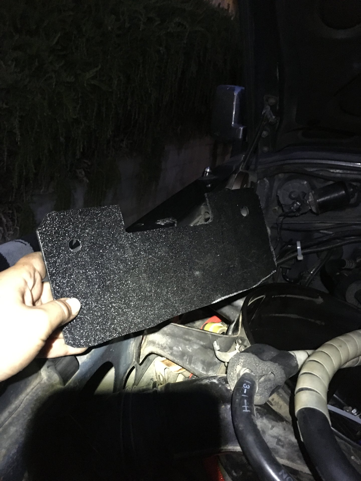

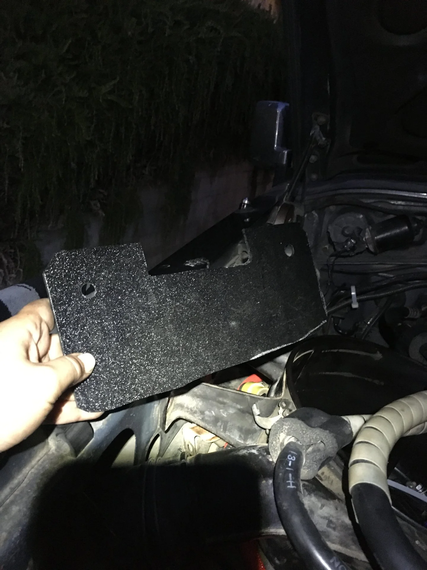

I can’t check to see if the engine starts just yet because I’m making a bus bar mounting location using some scrap ABS plastic to clean up the nasty wiring near the battery. I also replaced all the ground wires because I figured if I was cleaning them up by removing the bolts, scrubbing with a wire brush and adding a thin layer of dialectic grease then I might as well replace the original ground wires. The body to the passenger side motor mount was, as everyone says, a real pain the @**. I hope this solves a bouncing voltage issues I’ve been experiencing on and off.

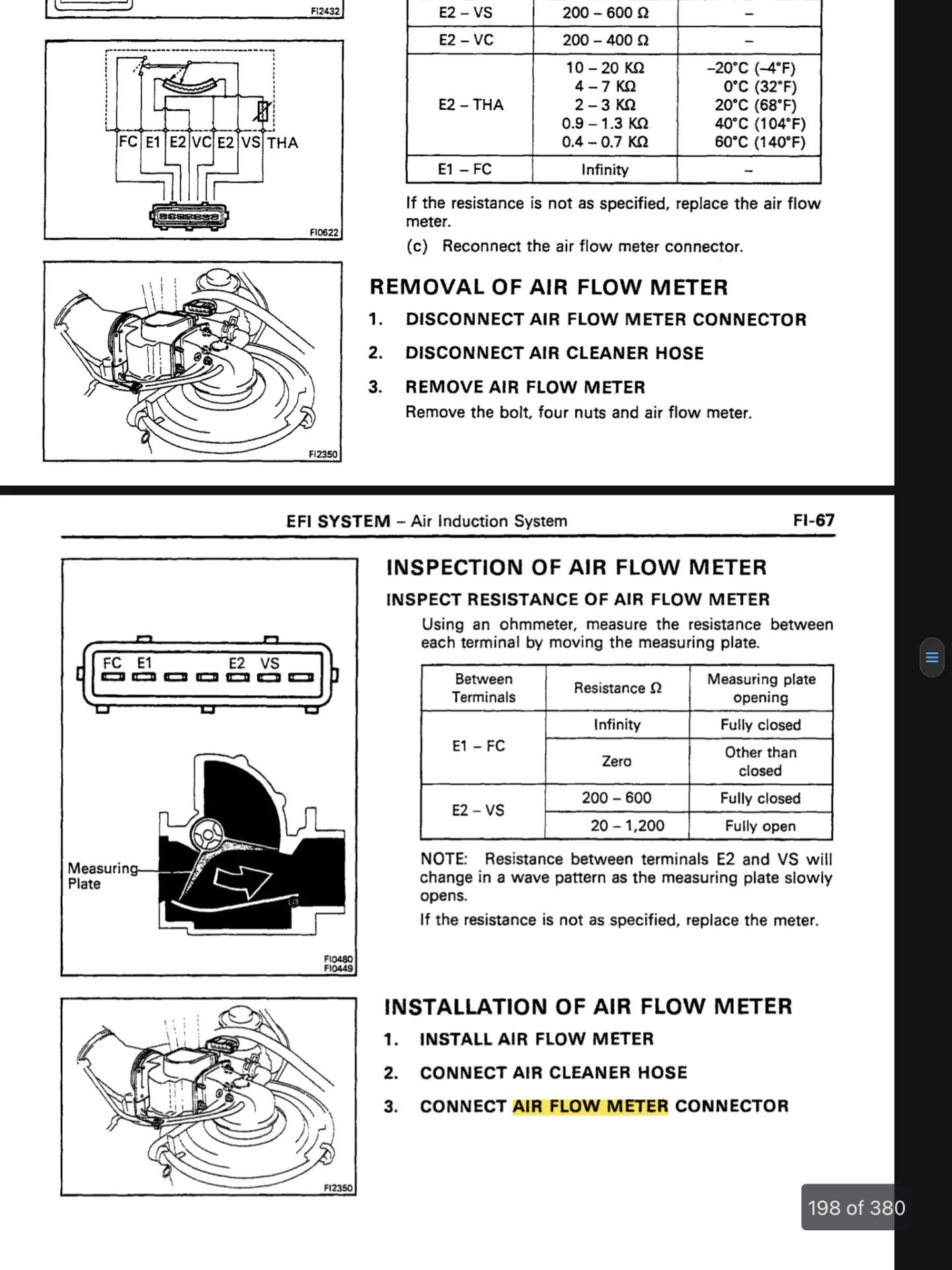

I bench tested the AFM today - here are my results
It looks good but where it should have zero resistance it seems to have a tiny bit then goes back to 0.00. It was a hot day though. What do you all think?
if there's any sound on your video, I can't hear it. When you say it goes back to 0.00... is that while you're still holding it open? My understanding of the E1-FC circuit is basically like a light switch - it's either on or off. So on the meter, you're going to see OL if it's off and some kind of reading (other than OL) if it's on. Which I think is what you're reporting. In which case I'd call it good. That circuit is telling the ECU the engine is running (air is pulling the flap open) or it is not (spring closes the flap).
I notice your meter is auto-ranging from M ohms to K ohms, which might make the reading seem odd. On mine I would turn off the AUTO ranging function and set the meter fixed to K ohms so I can better see what is actually happening.
Does the fp operate when you manually open the flapper on the afm?
The cor has two pulling circuits, one for cranking, gets power from the key switch. Tbe other is operated via the afm switch.
Sometimes one side dies.
Not sure why the sound didn’t come through on the video. Basically the AFM tested well and I think it’s good to go. @toy_tek I noticed the auto ranting was messing with the readings too. I’ll have to figure out how to turn it off for future testing.
@Dynosoar I think the coolant temp sensor was the culprit!
I put everything back together again today and the engine fired right up! Let this be a lesson to everyone - just because you‘re not getting any codes doesn’t mean there isn’t a loose connector somewhere. I checked codes first thing and none popped up.

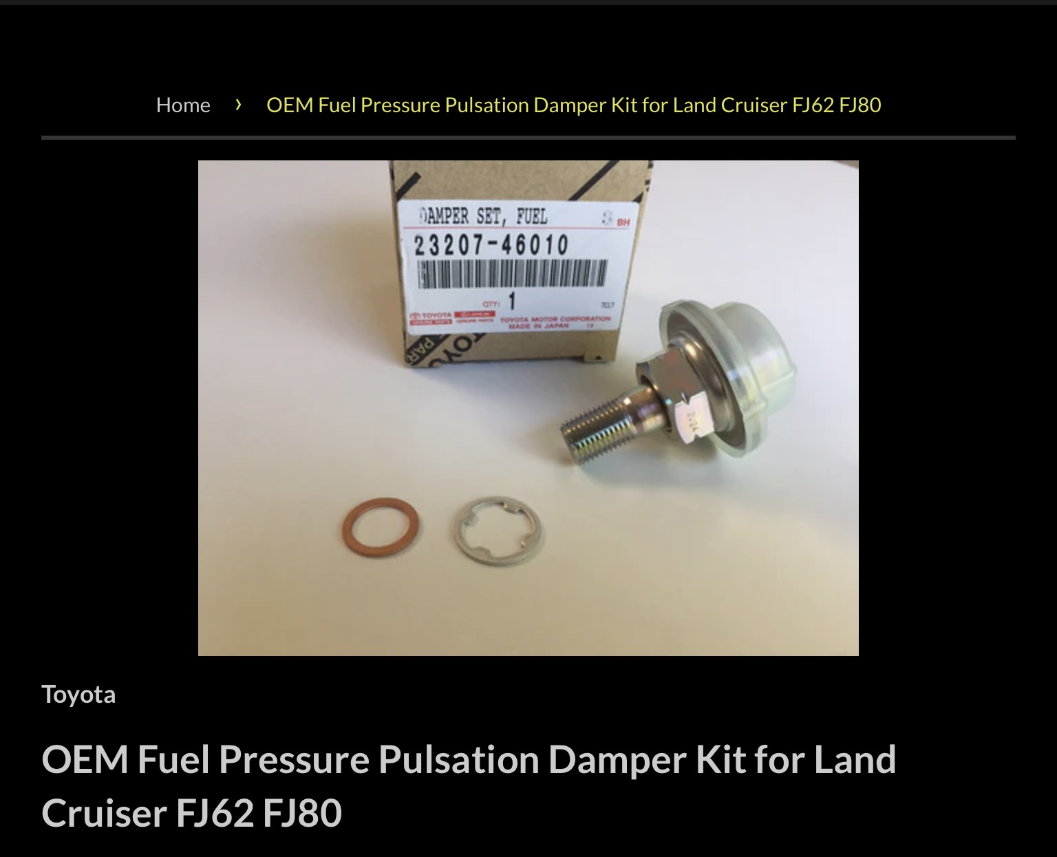

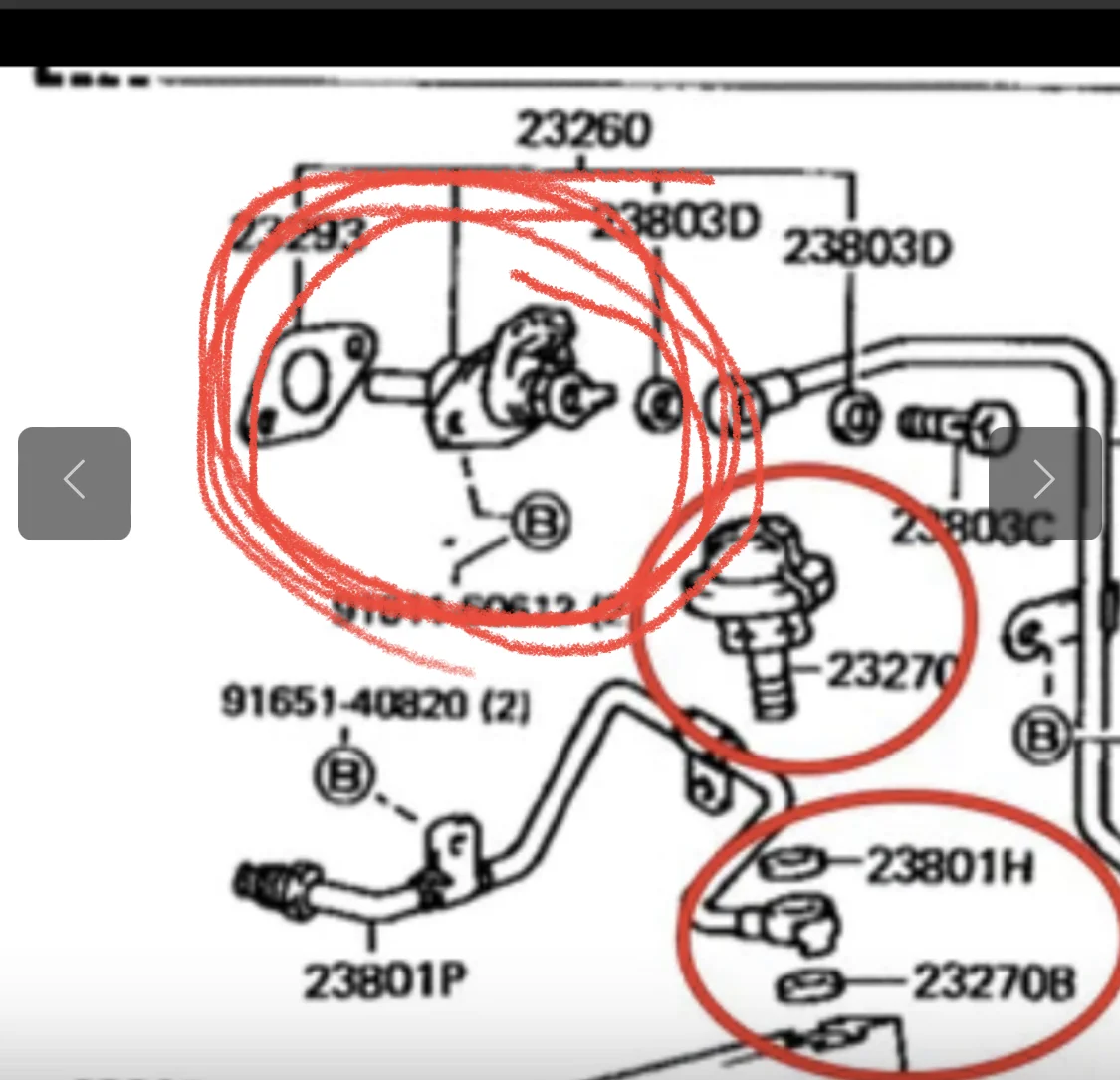

You can flip the copper washers over that seal the fuel pressure dampener.
I bet that's where the leak is. Potentially it may be the dampener as well.
flip them?

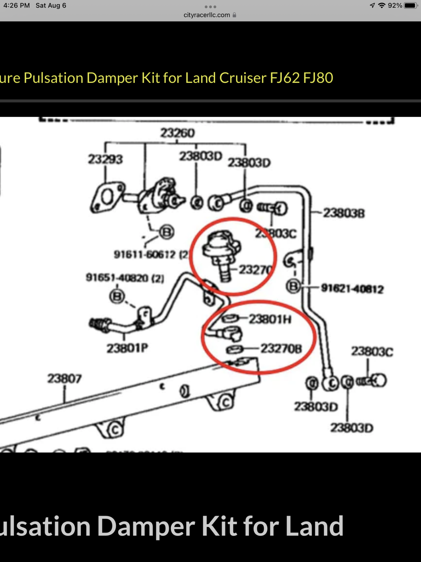

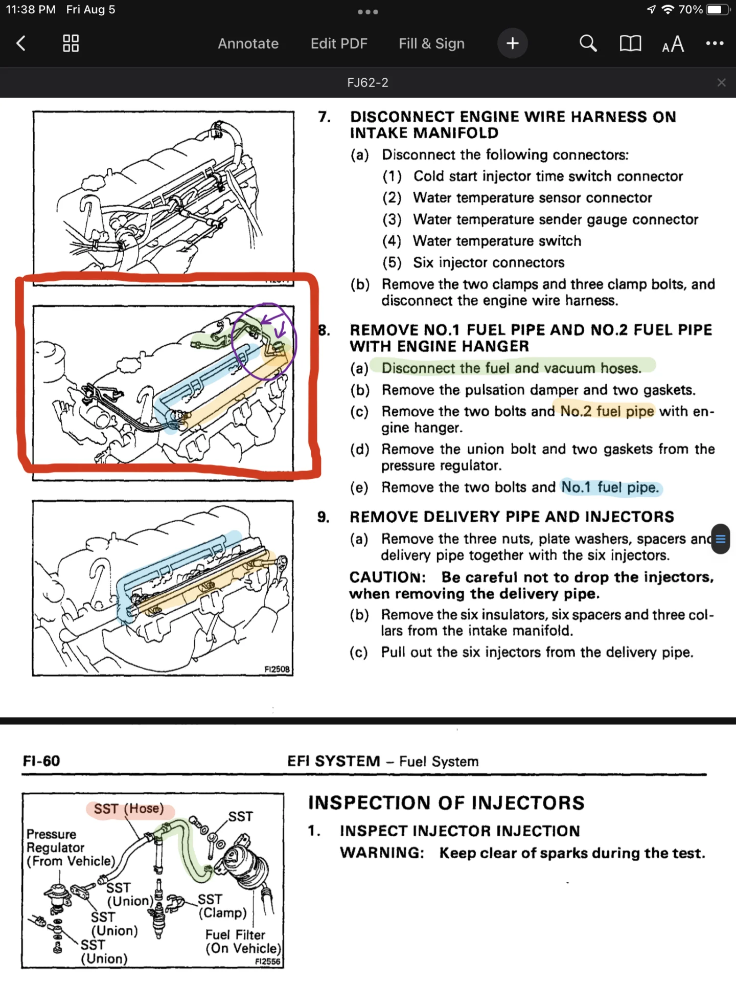

Should I remove the pulsation damper (using a 22mm crow wrench…gotta find one maybe harbor freight) and then remove the copper gaskets, literally flip the copper gaskets over and reinstall to 22ft pound torque? Or do you mean switch their positions? Does it matter which is closer to the rail and which is closer to the damper? I’m using the below picture for reference.
CityRacing has a kit and I’m not sure which copper gasket belongs to which part number. One looks tinned with an inner pattern and the other looks to be pure copper with a smooth inner and outer. OEM Fuel Pressure Pulsation Damper Kit for Land Cruiser FJ62 FJ80 - https://www.cityracerllc.com/products/oem-fuel-pressure-pulsation-damper-for-land-cruiser-fj62
Might be worth checking your cold start injector. I circled it it here. I did mine today and it was disgusting. Now it fires up at the first turn of the key.
@banieldowen Good thought - I actually cleaned it up a couple weeks ago. It was filthy but now it’s shiny clean and tightly secured.
