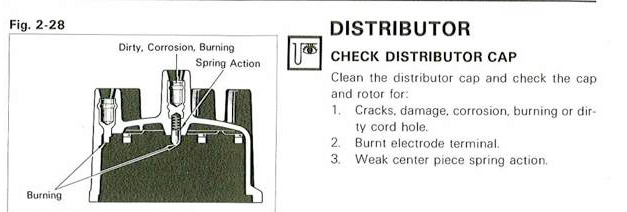

Check the dizzy cap. Pull it off and looking at the underside of the cap, check the contacts. Make sure nothing is burned/corroded. Make sure nothing is broke inside the dizzy.

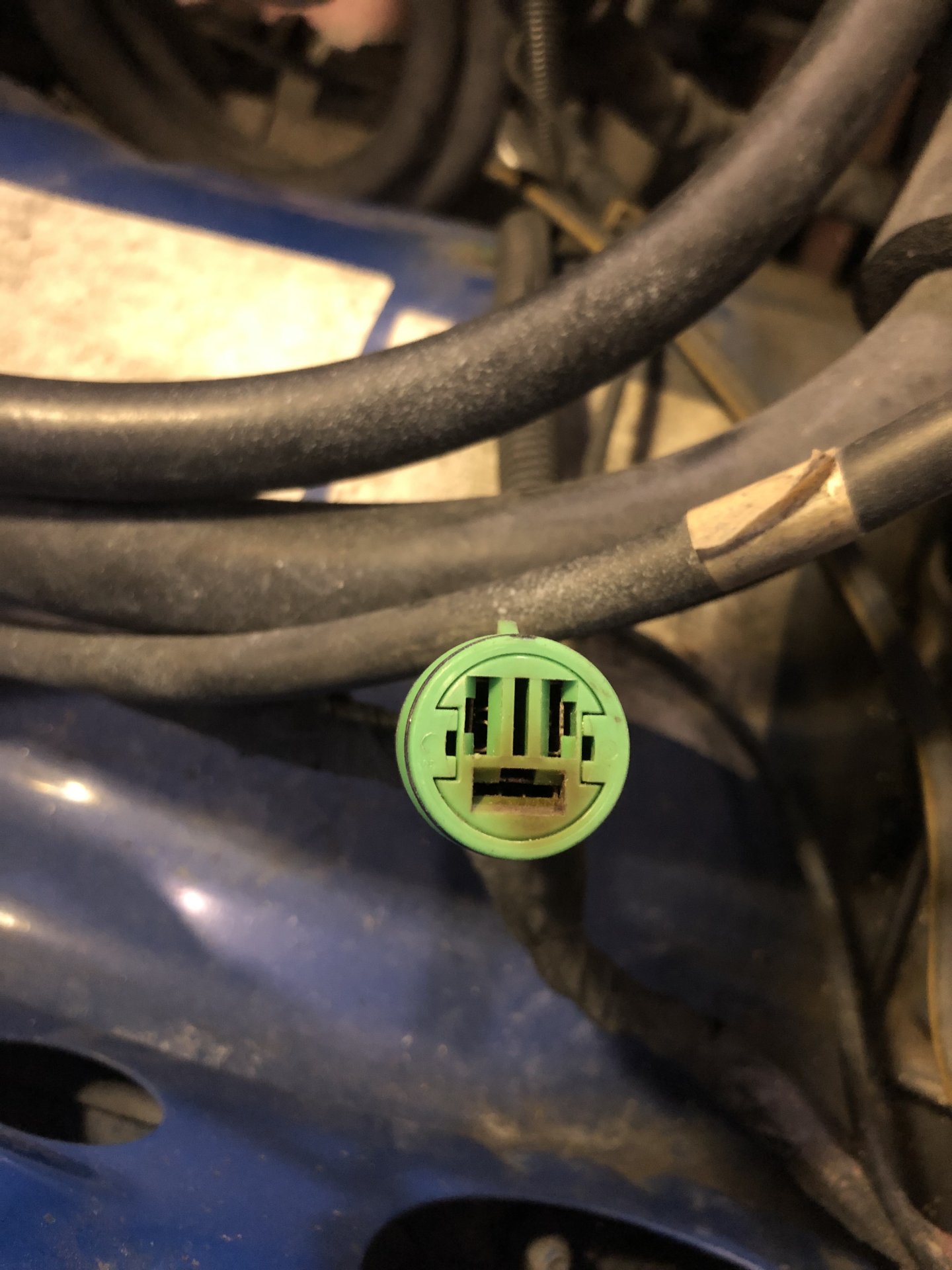

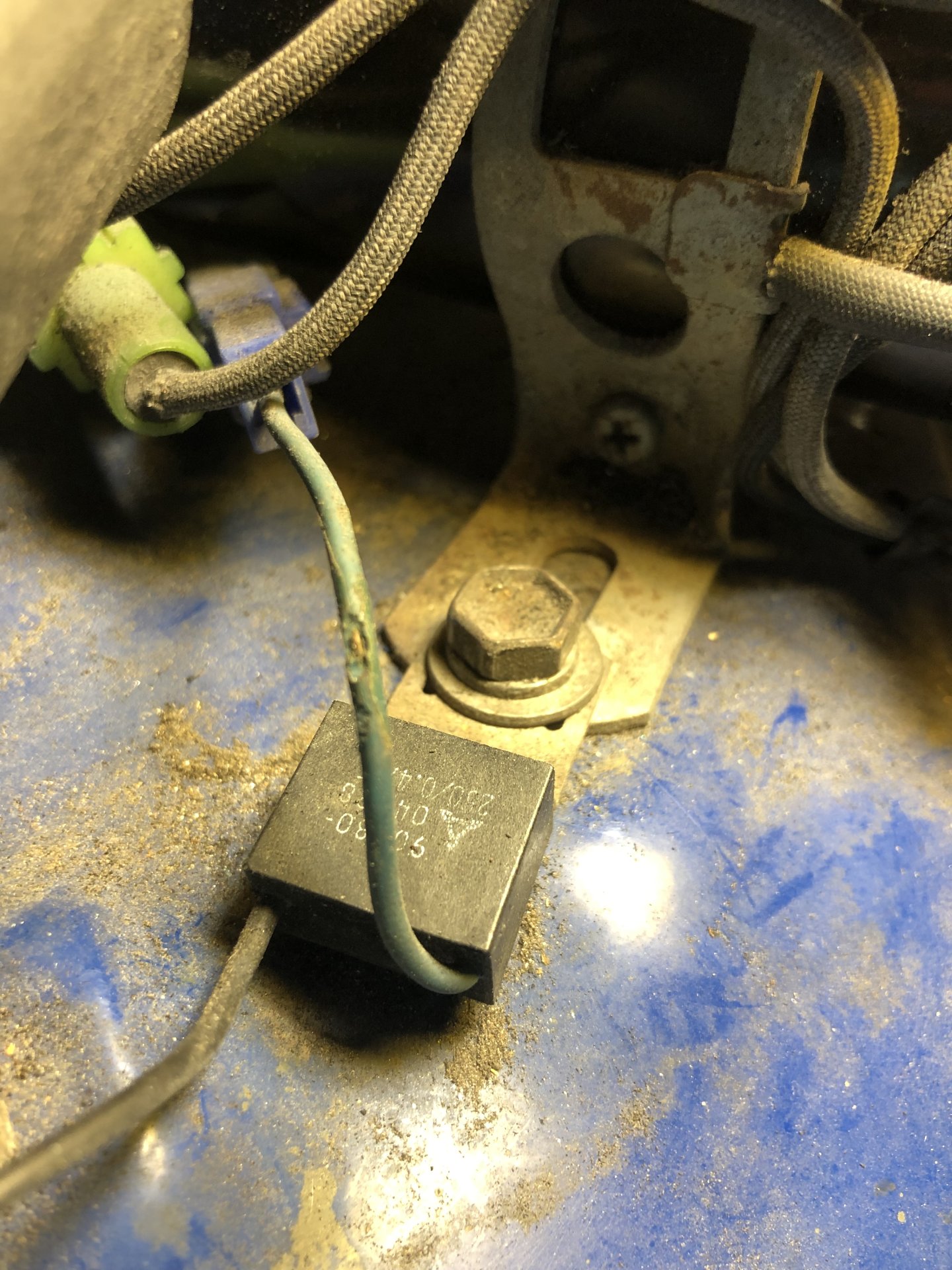

Hey guys, so… I ran through everything earlier this morning. Made sure the spark plug wires or going to the correct cylinders. Tested for spark again no spark. Checked fusible link (pic attached.) no noticeable frayed and/or melted wiring going into the link. Pulled the link, you’ll notice it seems a little bit burnt on the bottom could this be the problem? Found another slightly frayed wire close to the coil (pic attached.) removed and cleaned the ground behind the battery and tighten back up. Checked every other electrical wire and all fuses that I could find on the truck everything else looks good as far as I can tell. Gonna test for spark again as soon as I can get a second pair of hands🙂
The fusible link metal spade connector has overheated in the past from high current and it’s smoking the plastic plug housing. That smoke (carbon) coats the metal to metal electrical contact between the connector, increasing resistance which creates even more heat.
I’d replace that plug entirely — even though it may not be the root problem.
The little bit of fraying on the insulation of the green wire coming off the coil to the square thingy is not a problem. That square thingy is a noise filter for the radio.

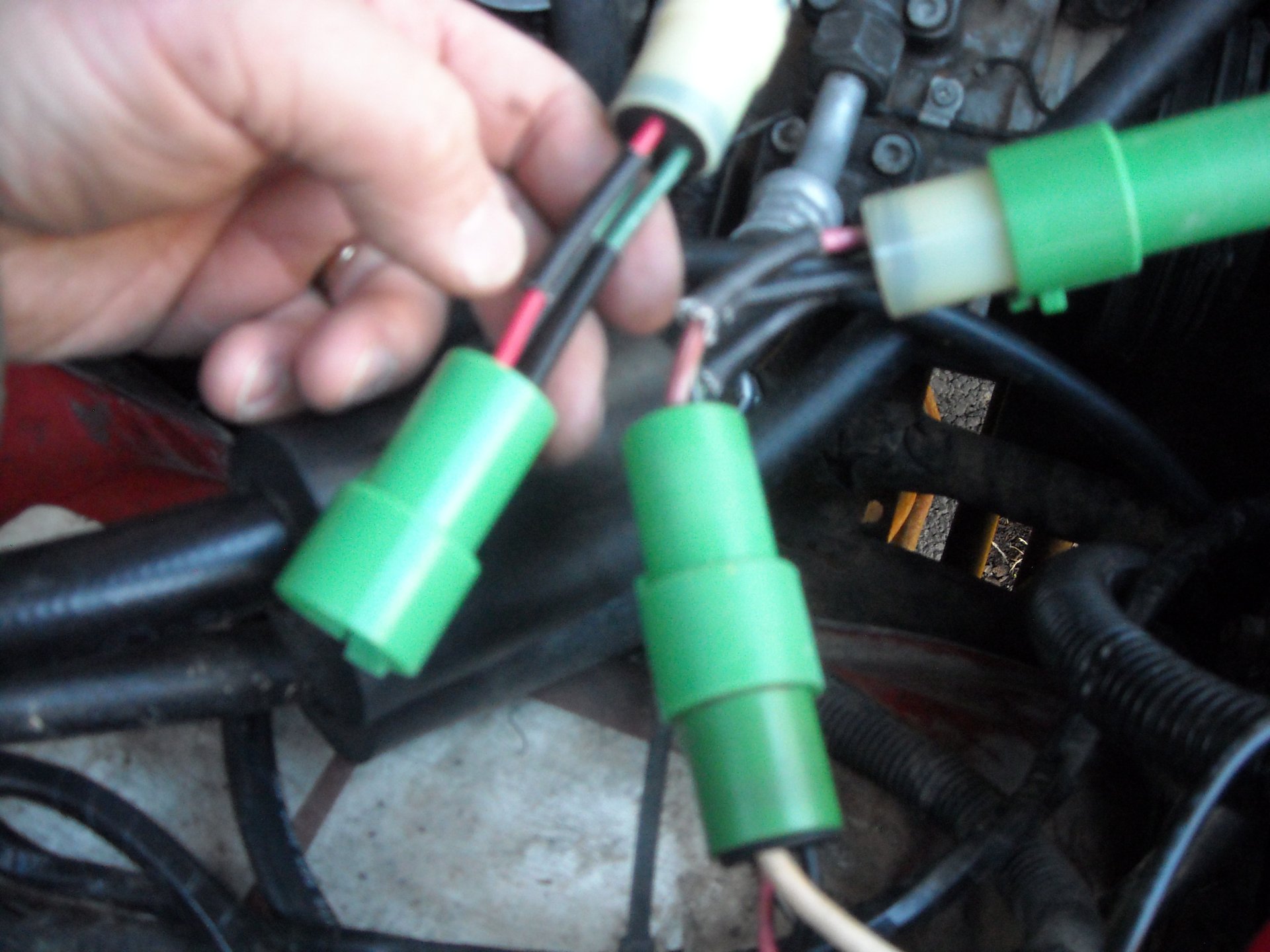

That plug is NOT the fusible link. It is the connector on the harness side of the fusible links. The fusible links are wires that run between two connectors about 3 inches apart. These "wires" are designed to burn away in the event of an overload. You should inspect the fusible links. My trucks fusible links burned up by the previous owner aka "PO". And he just ran wires from the connector you are showing to the battery. Not good. Here is a pic of fusible links:

So what do your fusible links look like? You may need to pull the tape of the back side of that connector and inspect the wiring that is crimped to the metal connectors that go in that green plastic plug.
Use a multimeter to check your fusible links, not a visual examination. Unplug the fusible link and check for 12v at each terminal of the link. A fusible link could be fried but still visually appear good.

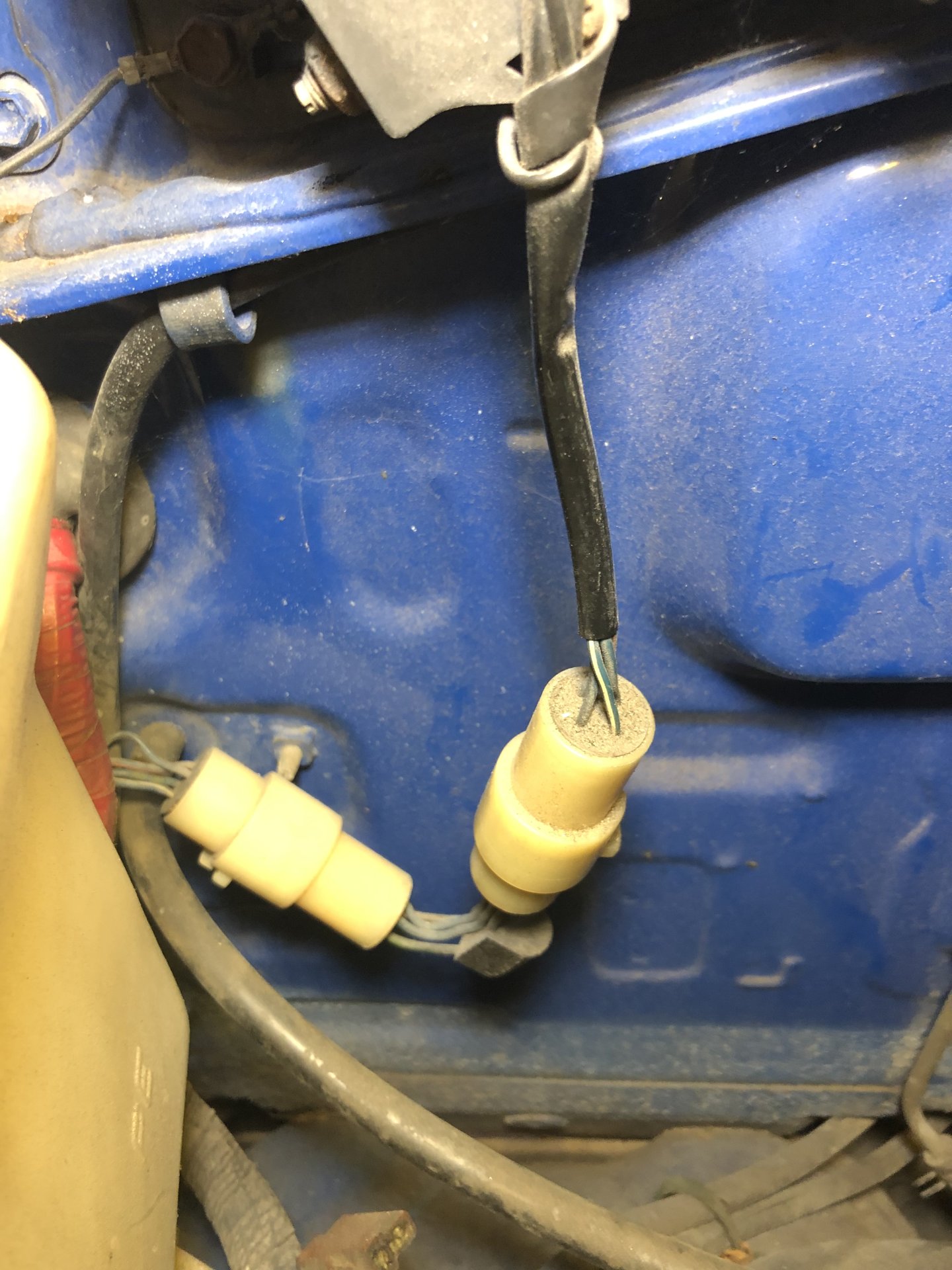

The only connections that look like your pic that I can find look like they are for the windshield wiper motor. (Pic attached.).
