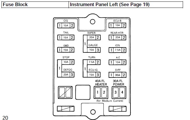

Check the 10 amp fuse marked GAUGE in the fusebox by the driver's left knee.
Thanks! ...But I've checked and there are no blown fuses.
There is 12V power to the fuse slots. So I assume the disconnect is deep under that dash between the fuse block and the gauges and A/C buttons.

Reporting back... Yup, 10A fuse labelled "Guage" blown and I just couldn't see it. Fuse replaced and gauges, dash lights, A/C, etc appear to function normally. Lesson learned.
