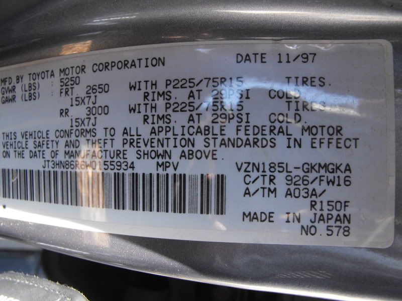

Sounds like you likely have a bad ECM. What is the build date of your truck? Look in the driver door jam.
I couldn’t find any dates inside the drivers door jam. I looked on the door and on the pillar aswell, nothing.
Would be in sticker that looks similar to this. Date is on top right in example picture.
I'm sure its late 1992/early 1993. Know bad ECU in that time frame for fzj80s. Lots of threads for that.
03/93 March 1993
Yup. The early 93 is known as a failure and it typically gives those codes and they seem to be insurmountable.
A 94 ECU will resolve the issue.
Order one (used) from @slow95z as he stated. You're in Canada, so it may take a bit.
