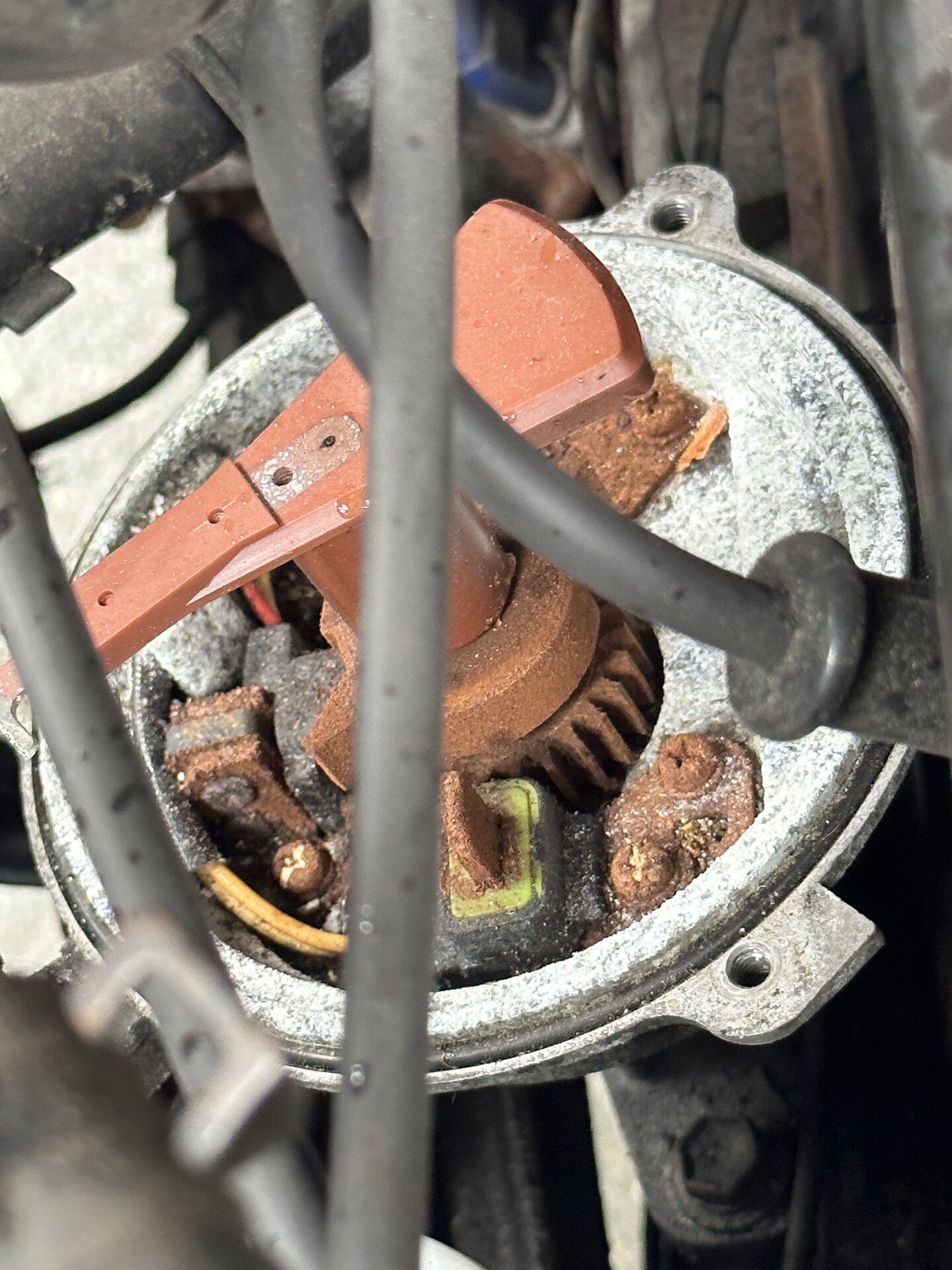

SOABBBB. Man I just went and unplugged the AFM and sure enough the CEL came back. What are my options now to get one of those. Damn it I could shoot myself for messing with that. Can I drive it at all without that if I get it running? Fun side note look at the distributer attached
There's a lot of oxidation in there, but nothing that is a deal killer.
Obviously this has sat for a while and had a lot of condensation.
You can spray WD40 in there to help with that.
Make sure the contact points UNDER the rotor are clean (emery cloth or plastic pad). Make sure that the tip of the rotor is clean and shiny as well as the contact points on the inside of the distributor cap. In other words, remove the oxidation on those points.
