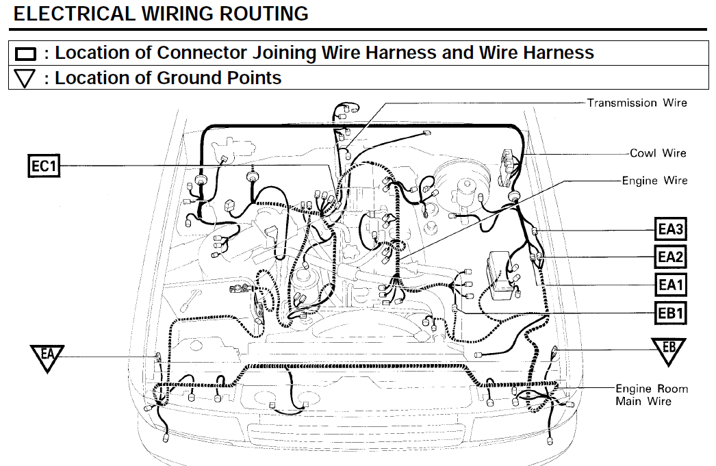

Below is a full schematic of the 3FE ECU and related components. Wire colors are accurate.
Connector EB1 in the engine bay. All ECU +12 runs through this connector.
Location of EB1

Wow thank you jon. Im curious what am i looking for in the EB1 connector? Sounds like that is a very important spot. Unfortunately I did not hear from the shop at all today I'm hoping its because the truck is outside and it rained all day and not because he is sick of this stupid toyota in his lot. At this point i wish i had it at home to troubleshoot it myself. I feel like i have learned enough from you guys to possibly tackle the job. I am DYING to pull the AFM and see if check engine light returns. If i had a spare key I would do it now. I am also DYING to replace the corroded fusable links to see if that does it. Toyota said they could have them next day but I am trying to not be a know it all and let this mechanic do his thing. Trying not to step on toes so to speak. He did tow it for me for free and agreed to help me fix it. Im worried at the same time he views it as a nightmare and it will fall on the backburner. Im suppose to leave town tomorrow and still not sure what I am going to do. This sucks I just want my new truck back.
Corrosion, poor connectivity, burn marks, anything that does not look healthy. If you have the ability to use a multimeter, it can be your best friend.
