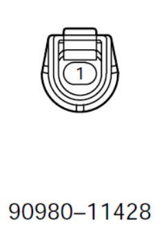

Connector or Knock sensor?

I've really liked the experiences I've had with corsa technic. Just bought this the other day for 7 bucks, most of that was shipping and it looks like oem.
11428 is not the OE connector for the knock sensor.
EDIT: However if you search that site for 11166 it appears to show the correct connector.
