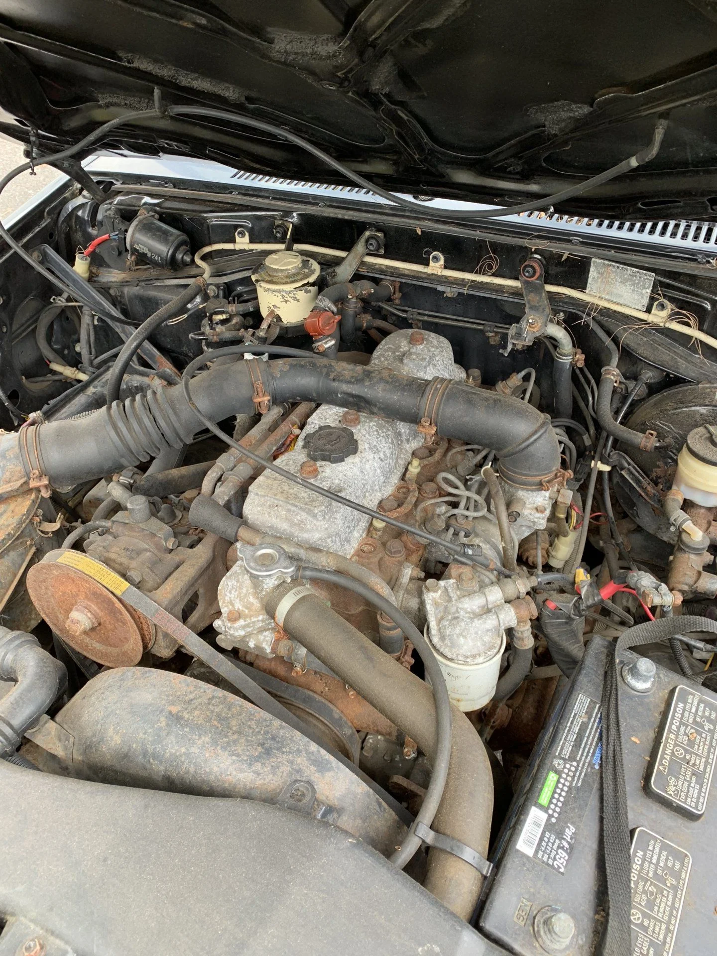

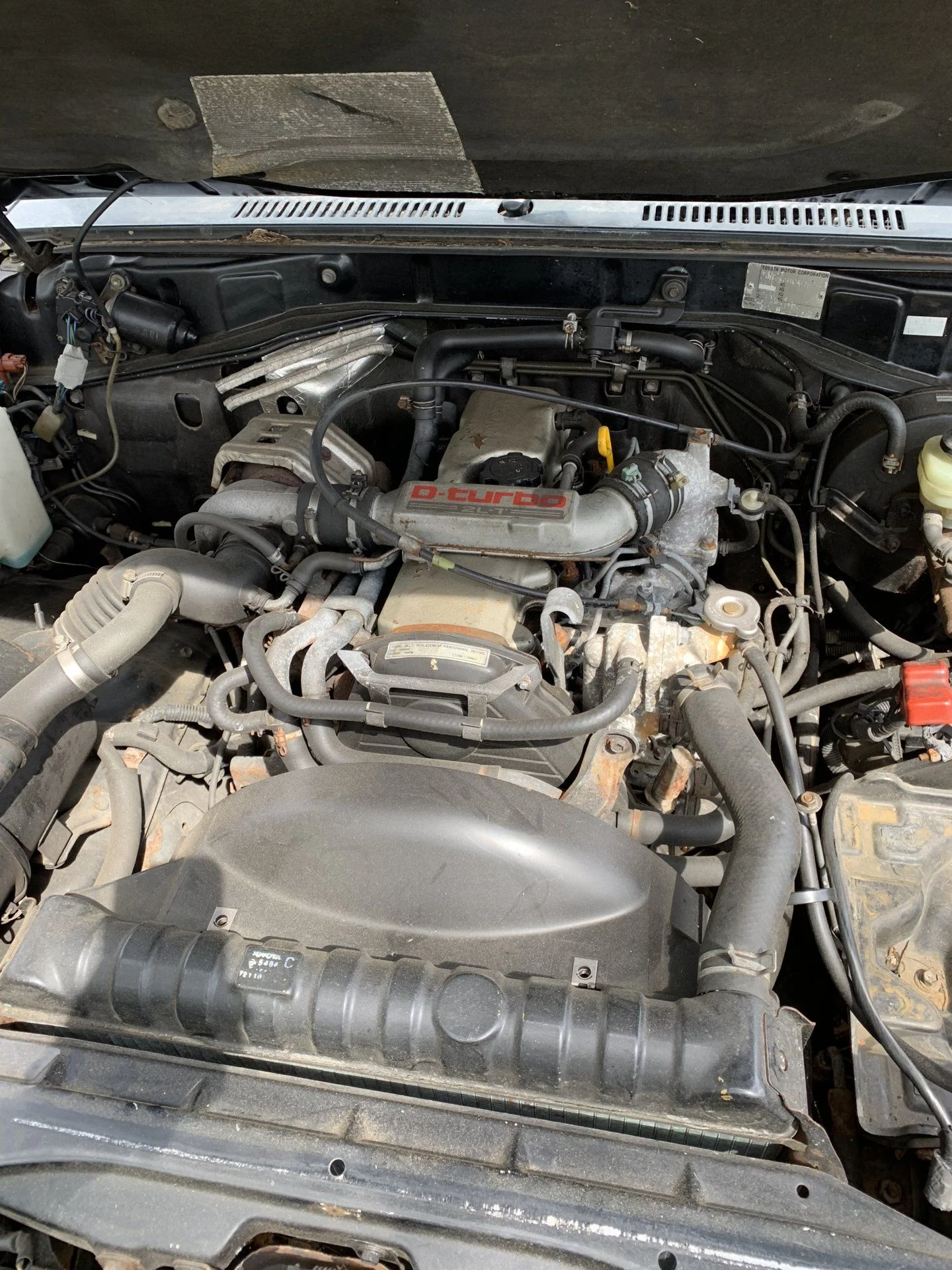

Just acquired 2 new Land Cruisers that need some work. One is an 87' BJ71 (trying to figure out which motor is in this one as there's not a lot of markings) and the other is an LJ70 with the 2L-T (I know there's 2 versions of this and I'm assuming this is the earlier model). I've bought them in non-running condition, the previous owner let them sit for 5 years (were running without issue when parked like they all say) and of course the batteries didn't have a charge and with him having health problems couldn't mess with them so I got them for what I think is a pretty good deal.

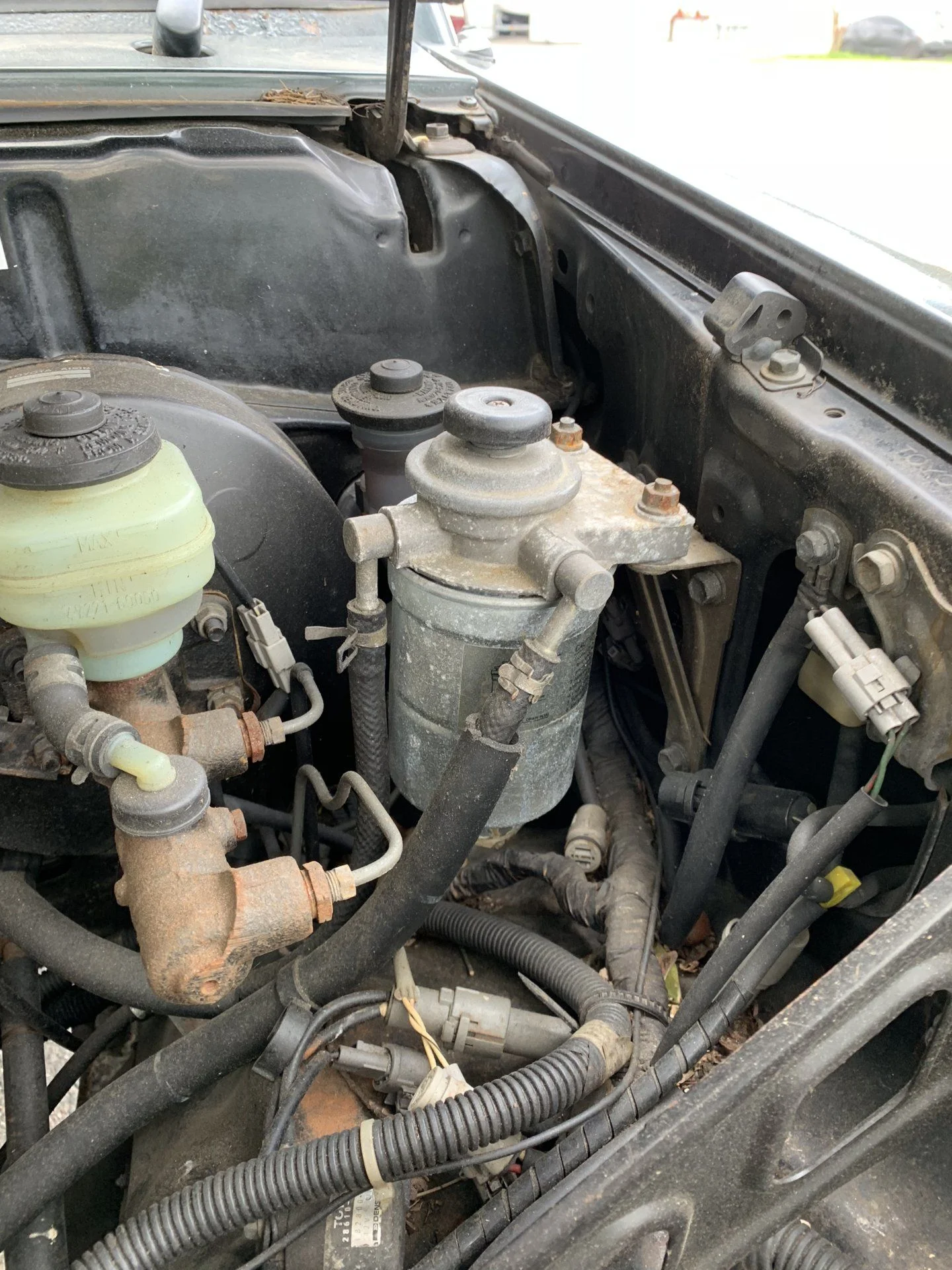

I'm looking to find out what I should do before trying to start either of these, the 87' has some rust issues starting with the fuel tank having a pinhole and leaking diesel. I would love to find a replacement fuel tank to put in instead of trying to doctor up the old one.

Cool! Any exterior photos? That first one is a 3B engine, which suggests to me that it’s probably a BJ70 since I believe that the BJ71 came with a 13B-T. (Might not be the original engine either). I would hold off on injectors till you’ve gotten them running since they can be a bit expensive and you may not need to do any more than run some cleaner through them. Also, it would be good to just go ahead and replace the timing belt and water pump on the 2L-T.

I generally go to www.back40imports.com for stuff like that. He stocks much of the routine maintenance parts, and it takes the guesswork out of digging through part numbers.
The 2LT is 1989 plus (technically it's a 2LT-II). The rust around the rad cap/coolant fill neck would concern me. Good chance the head is cracked, or was cracked and repaired already. Check the coolant mix/color. Fire it up and watch for bubbles in the expansion tank, or overflowing expansion tank when driving.
