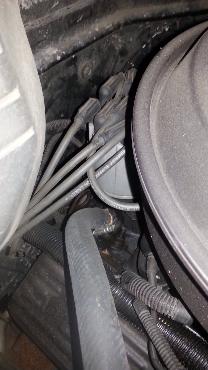

This is one flavor of a GM TBI intake for 5.7, there are various intakes and versions of 5.7. So anyway there is a threaded boss just above the thermostat housing on the front of this intake setup for coolant hose fitting or plug (front is to the far left in this picture). and while its hard to see there is another threaded boss at the far rear of the intake just above the distributor hole in this picture which is also setup for a heater hose fitting or plug or some versions use a heater control valve.
go here and use the "zoom" feature on the pics for close up view
https://www.amazon.com/Edelbrock-3704-Performer-T-B-I-Manifold/dp/B00062YAT4?tag=ihco-20
likely will involve some custom setup...but thats easy....need to see top of intake without the air filter and good view of water pump top to make further recommendations.
google is your friend
5.7 TBI heater hose setup - Google Search
Again....heater hose setup unique to engine configuration. I forgot but some also had one of the heater hoses running to radiator. So not to be confusing....best choice is to mirror the setup of the Stock GM configuration that matches your engine model/version, sometimes thats not possible and you have to improvise.

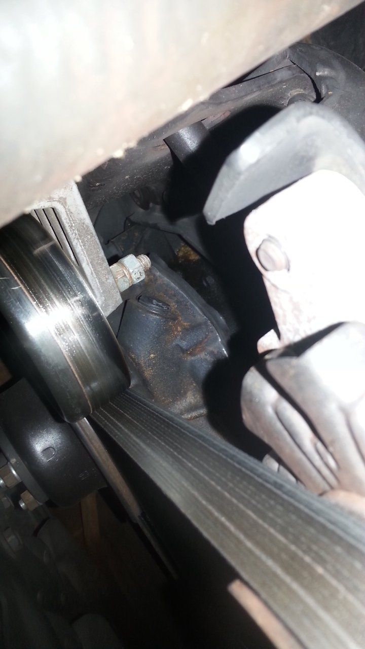

Same set up in my 60 also but the reverse rotation pump doesn't have a return port. The fabricated inline return will work as long as it's plumbed to the valve correctly and the heater system isn't blocked.
Ok guys my buddy just got here got some pics of his truck that use to be mine the output of the motor is on the back passenger side of the intake the return goes into the radiator the aftermarket water pump he installed has a threaded port in the water pump.
heater hose setup not super critical....you need heater control valve functional and you need coolant flow. I would mirror the stock OEM configuration as noted where possible ( from the GM donor/engine setup).

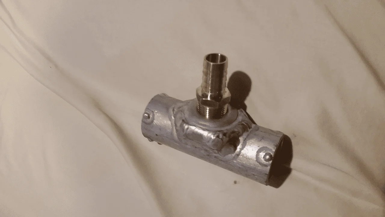

@Brent82FJ60 Good job with getting that little coupler built. Ya even went and did some small dimples/nubbins for the hoses to bite on. Hopefully this will resolve the majority of your issues and you can get to driving the truck more. However, you stated back in the beginning you went from a "faulty TBI" to a carbed solution. Why the drastic change?

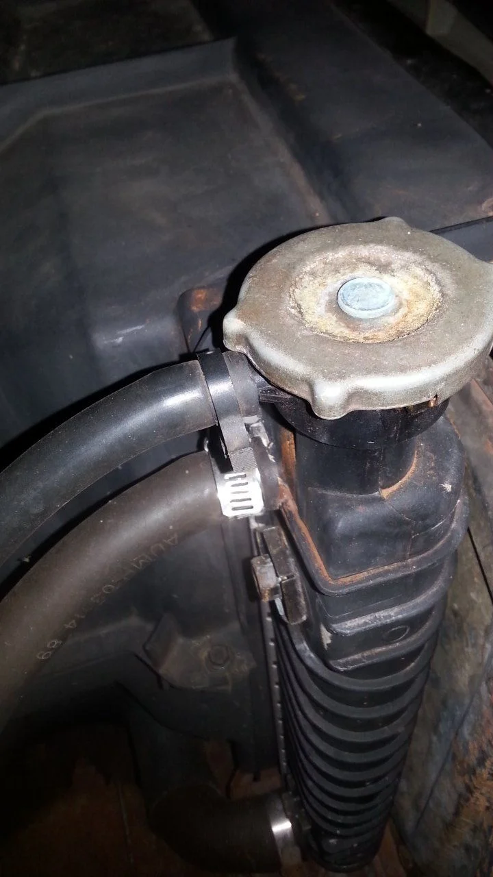

To the OP - RE: heater performance - your radiator cap looks old and tired in the photo, so if you're unsure of its age and condition, replace it. The proper cap pressure will help ensure good heater performance.
