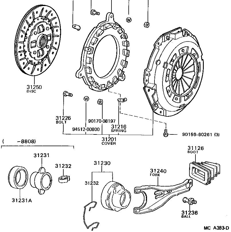

What all is needed? The fork, throwout bearing and boot?
You will also need the hub/clip. The TO bearing seats in the hub, and the hub mounts in the fork.

Note that there are several flavors of the clutch hub and spring. I seem to recall they interchange. In this drawing 31231A is the bearing, 31231 is the hub, 31232 the clips (specific to the hub?), 31230 is the bearing and hub as one part number and listed as 1989+.

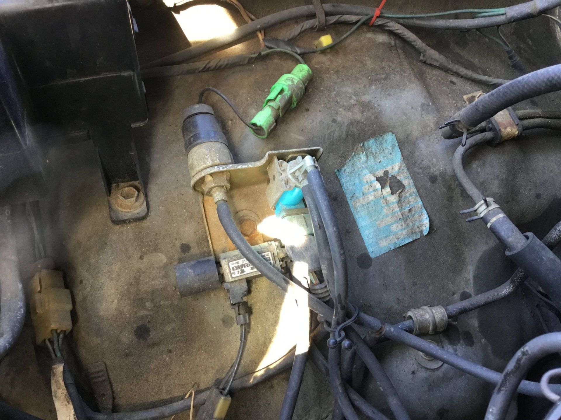

I found this picture online. None of these do-dads are hooked up anywhere on my project. The two lines on the right hand thingy and the one line on the left hand thingy have no hoses attached. What are they and where do they connect to?
Thanks!
Dang, I was hoping it was the big clue I was looking for.
Where is the fuel cut solenoid valve? From the manual it looks like the one with the hose and single wire going to the green connector.
And supposedly there's a connector or device that affects idle at the driver's kickplate? Do I have to remove the plastic cover to see that?
