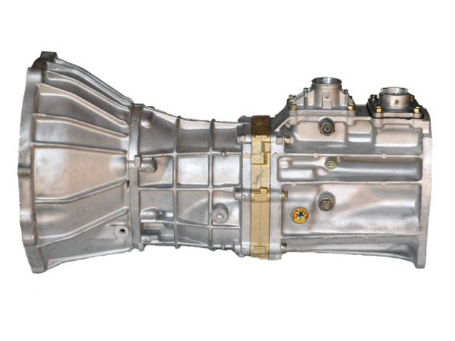

Good Morning All! I am new to the Toyota world. I have some Jeeps taking up space, but a friend needs a hand and he's got an 85 4x4 standard cab pickup. I was able to find a running 22r for him, but his G52 needs replacing too. They're impossible to find, but I have seen others for sale from different years. I've seen all the tables showing what came with what, but any transmission that bolted to a 22r would fit, wouldn't it? Would it just be a matter of altering sheet metal for a different t-case shifter?
His truck needs a lot of help, so you'll see me here often. Look forward to learning about these trucks. Thanks
Welcome to Mud. I can't help you directly but MarlinCrawler and it's forum are great for all things first gen powertrain. Someone will likely come along here more knowledgeable than me but you might want to check over at Marlin in the meantime.
I'm pretty sure any W56 will bolt right up. W56-C,D,E are also forward shift like the G52 as far as the transfer case goes. I'm sure someone will chime in that knows more

What Chris said. The W-series transmission should be more available and easier to source. If you get the tranny from a 1989-1995 truck it will have the forward shifter for the transfer case. According to Marlin's site the G52 and the W56 are the same length (25.5") so the W should bolt right up. The only major difference I see on Marlin's table is the reverse gear ratio on the G52 is much lower (4.713) than the W56 (4.091).

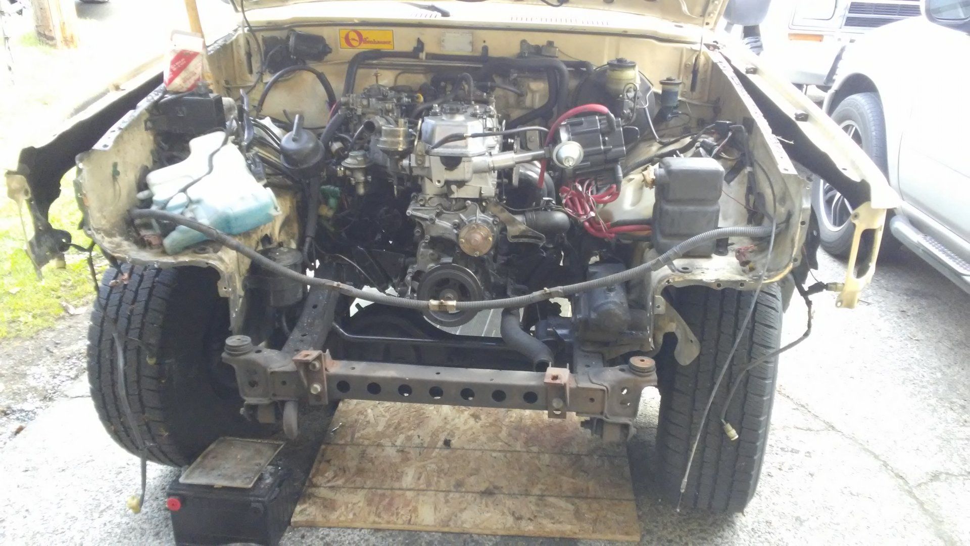

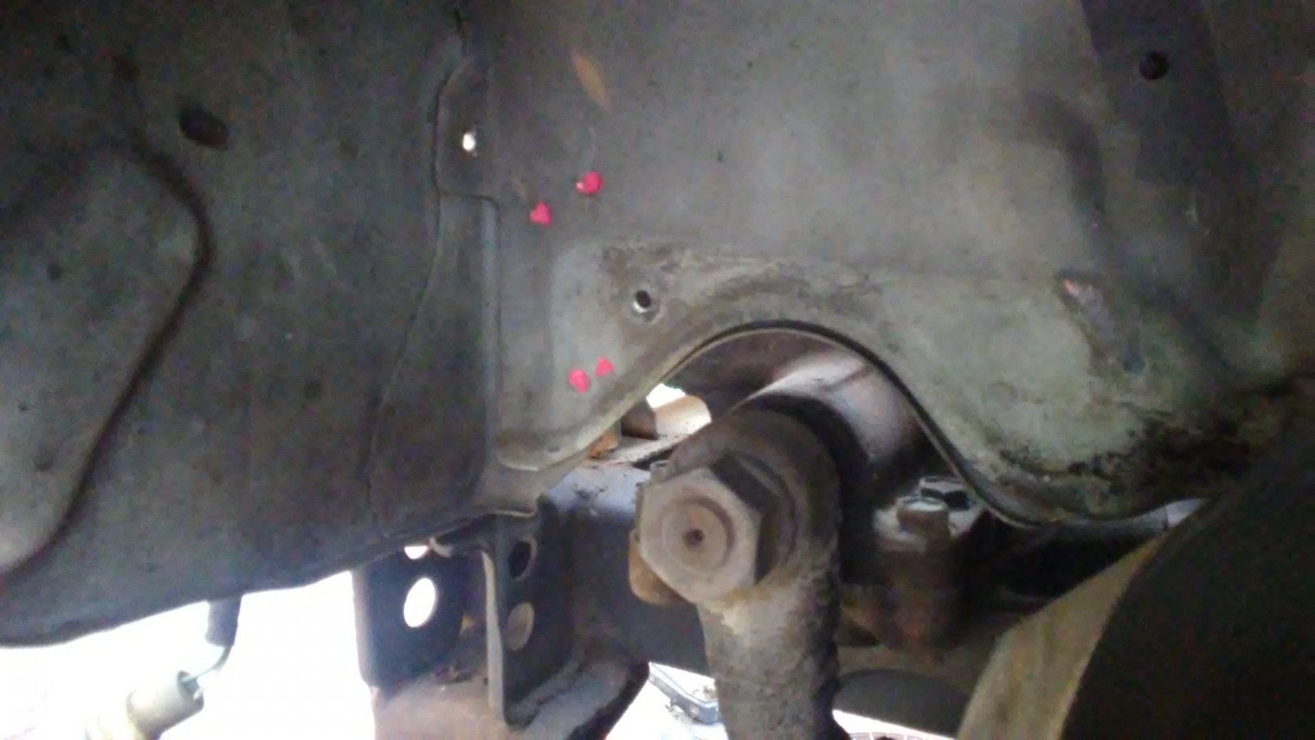

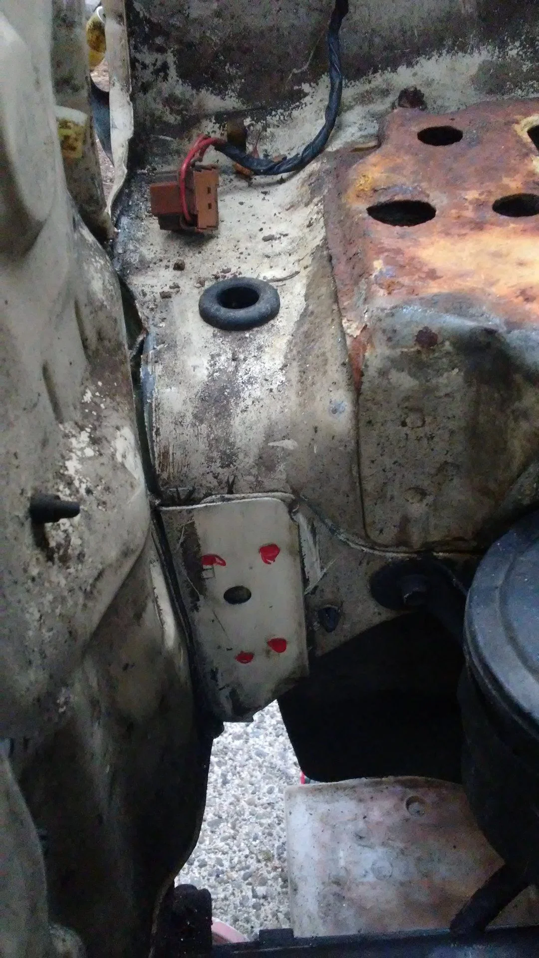

Well thanks for all the input. I am a day away from picking up a G52. Further away than I had hoped, but...The support definitely is welded. I marked all the welds lst night and will drill them out next. It is worth the effort, for me. If I can post photos here , I will.

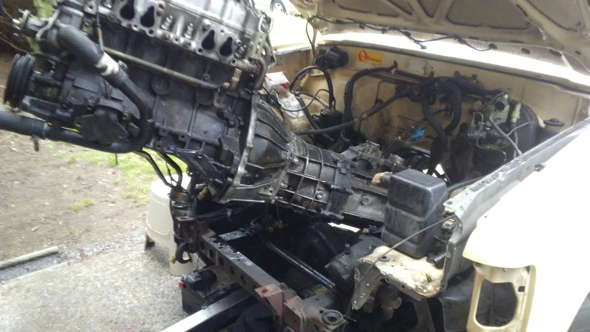

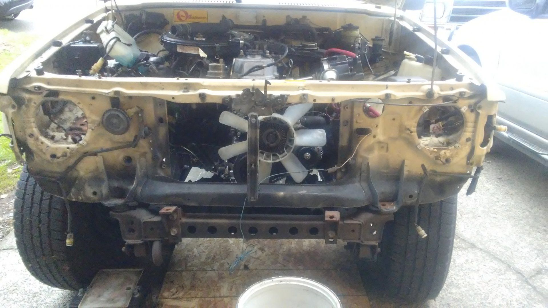

So, all done with that. Took about 1.5hr. Hood stays on, fenders unbolted on top and free from fender well (there are 2 welds under the fender lip), and that's it. I used a 1/8 drill then a 3/16 and finally a 5/16. The 4 holding the bottom are easier to reach from inside the fender well, especially the driver's side, as the steering box blocks them.
I just got done pulling a 22re myself and I must say I’ve never seen it done the way you just did. Am I missing something? Did you completely remove the rad support just to avoid having to drop the trans separately??? It’s really not hard at all to pull the 22re first then drop the trans second and reinstall in reverse order. I have done this countless times with ease.
Short answer: The owner, my neighbor, asked me to.
I believe he saw me working on the Wagoneer in that way and he wants to sell the motor and transmission "as removed". Made sense to me and I actually like it like that.
