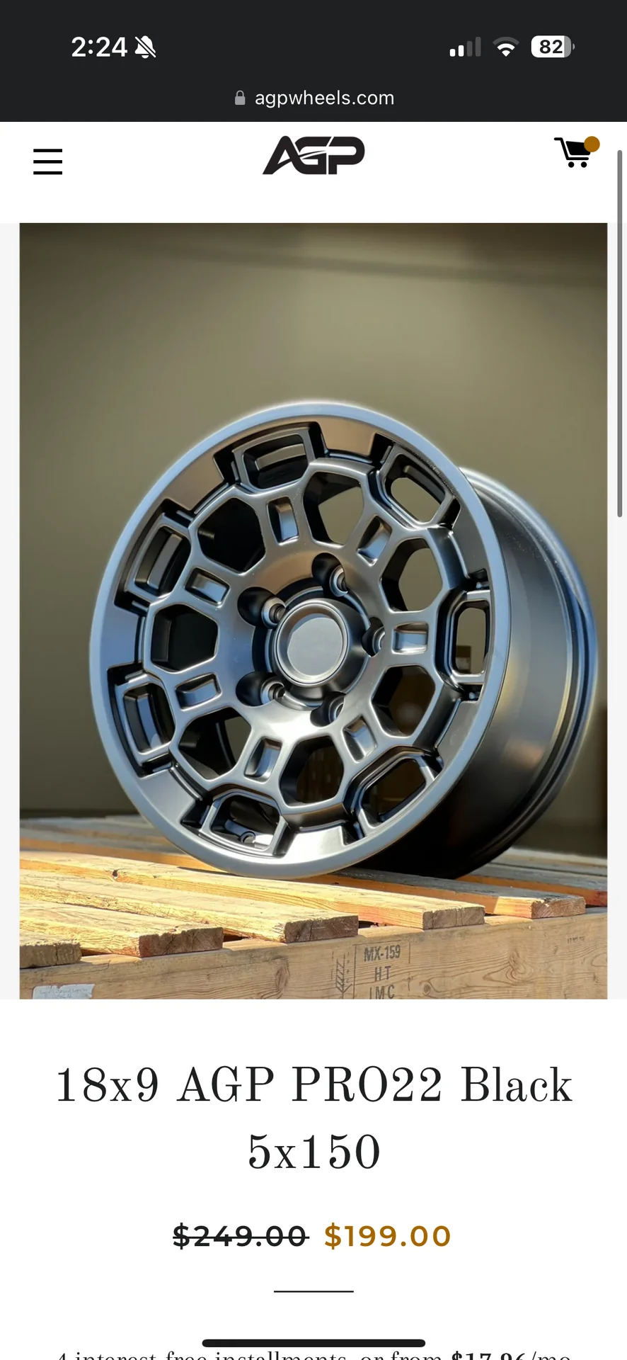

Anyone see any issues with mounting these on a 100 series? From what I understand I’d need 1.25” spacers in order to run the wheel centers. However, are there any other issues I’d run into anyone can think of? These are similar to what a new pro tundra or sequoia come with, but in a 5x150 option.
Thanks for the help.
  • Size: 18x9
  • Offset: ET +18
  • PCD: 5x150
  • Center Bore: 110.2
  • Color: Matte Black
  • Weight: 30lb
  • Lug nuts: not included. OEM compatible14x1.5 mag seat
  • Load rating: 2,500 lbs
  • Certification: SAE J-2530, DOT approved
  • The center cap is interchangeable with OEM center cap

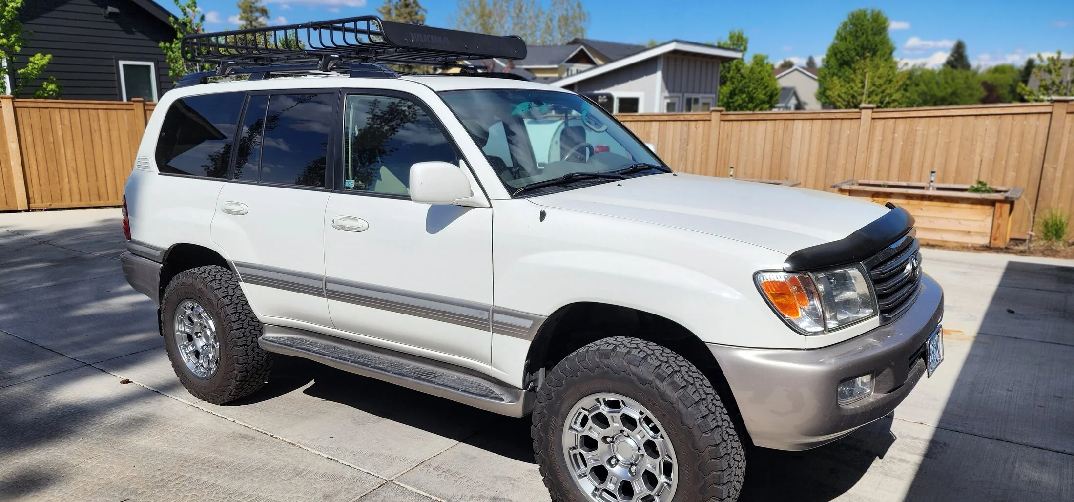

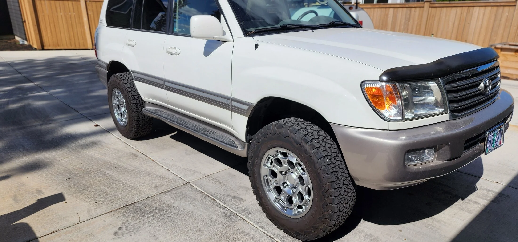

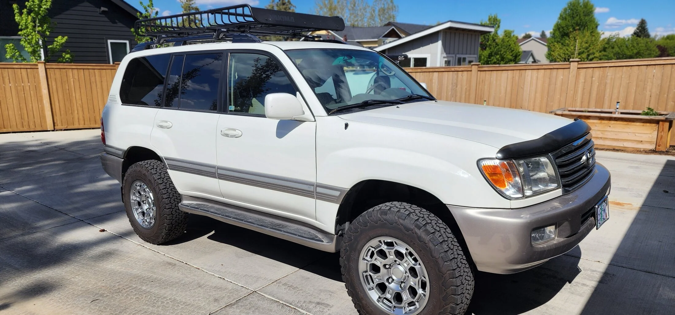

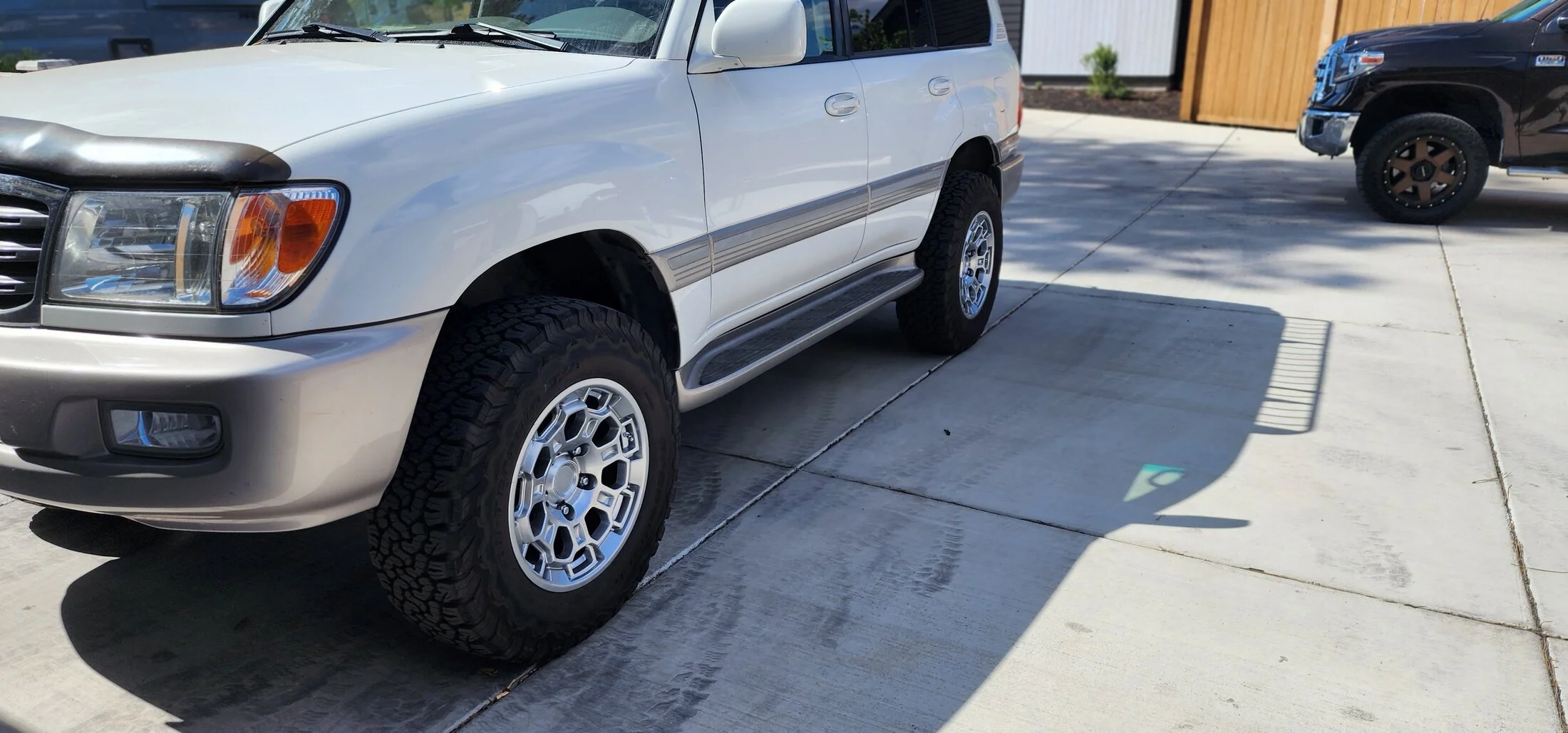

Well, you are correct. 1.25" spacers required to run the provided center cap and miss the grease cap. I suppose the other option would be to replace or flatten the grease cap. I was a willing guinea pig on this one. I think it looks pretty damn clean. This is with 33" tires and a modest 2" Old Man Emu lift.
How much poke do you get with the +18 offset and the spacers? Looks pretty sharp!
