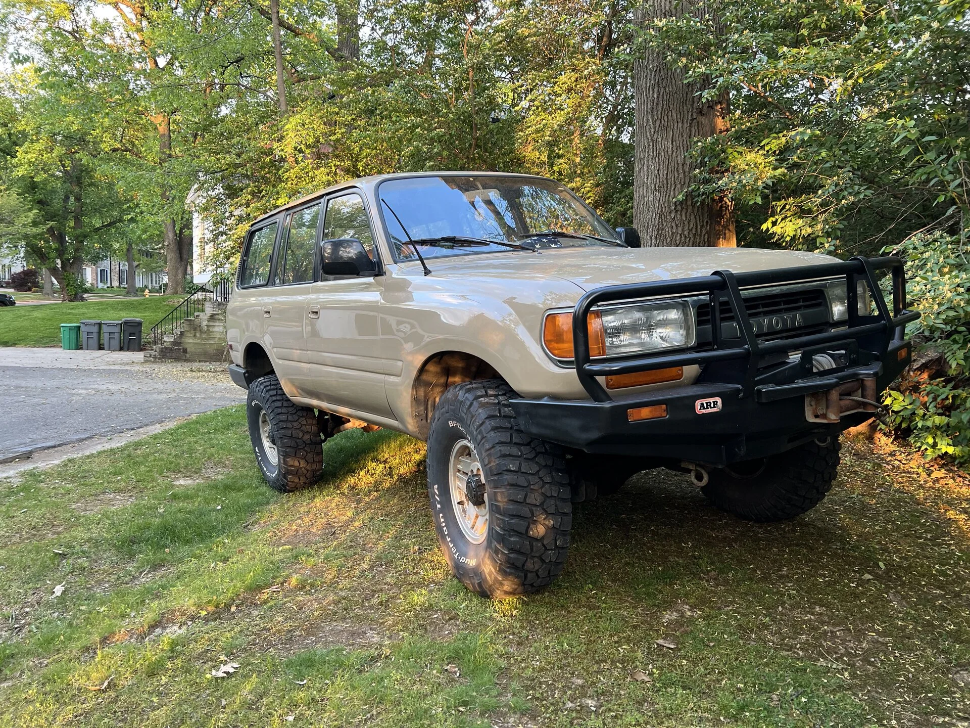

Hello there, this is my first post here and looking for some advice for my newly purchased 1992 Landcruiser. Im 18 and know very little about mechanical work on cars and wanted to get into it. My close friend and his dad have been building a 96 land cruiser for as long as I remember and convinced me to purchase one of my own. I don't really know where to start or which things I should look at first. I bought the car with 225,000 miles on it and it runs great. The previous owner had the car lifted with a OME lift and put it on Bf Goodrich Km2's which are currently dry rotting and struggling to hold air and has 4.88 gears in it. Just looking for some advice on where to start with the project! I attached a photo of the car as well

Nice looking rig! Hopefully the previous owner documented some of the maintenance on it to give you a good starting point on maintenance. Get a Toyota service manual, replace the tires, and wait until something needs to be fixed.

Get ready to fork out about $1000 for new tires. I guess with those gears and lift you will not want the stock size, more like 33". Do NOT swap out those wonderful OEM wheels for some ugly aftermarkets.
Post more photos! It's looking good so far.
