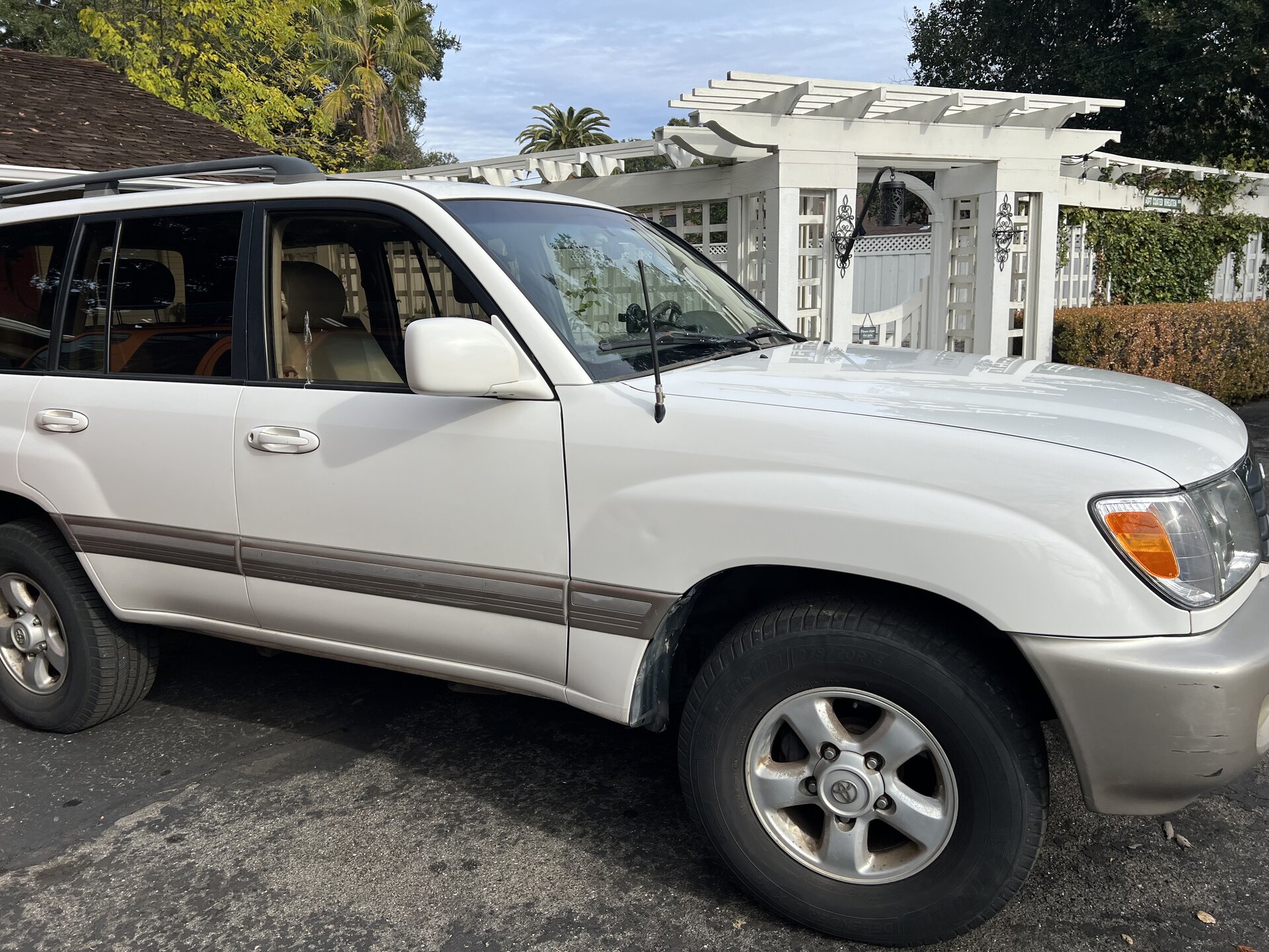

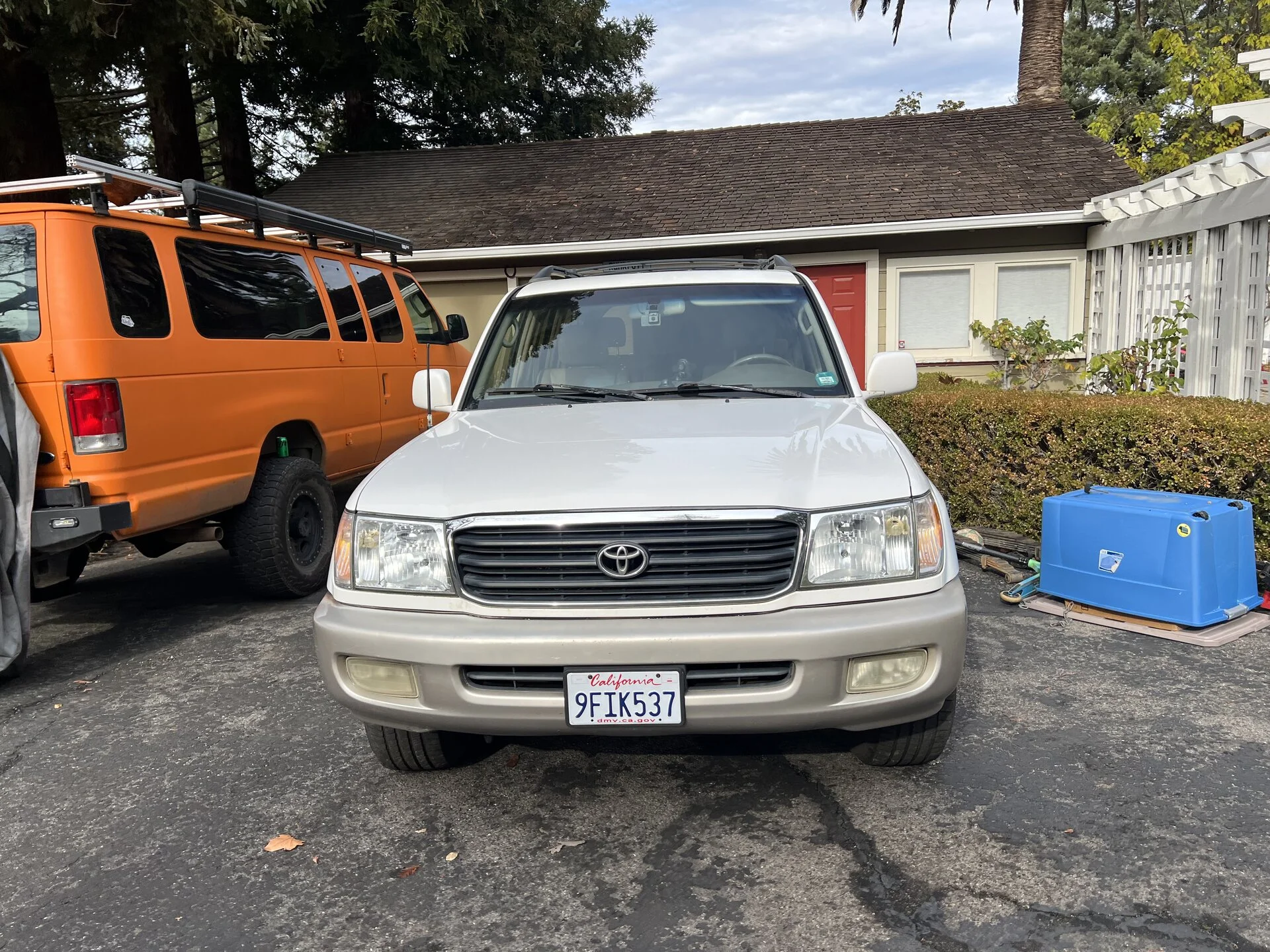

Just yesterday I bought a 1999 LC, 269k miles, nicely serviced and 20 years owned by the same lady, all life in California, ...
Quite some stuff has already been done in the past 1-2 years like alternator, battery, water pump/ timing, T pieces have been replaced with metal ones, new transmission cooler, ...
The paint is a little faded, but my first quick shot of polishing looks very promising and I don't have the typical clear peal :)
I'll add pics along my hours on the new ride.

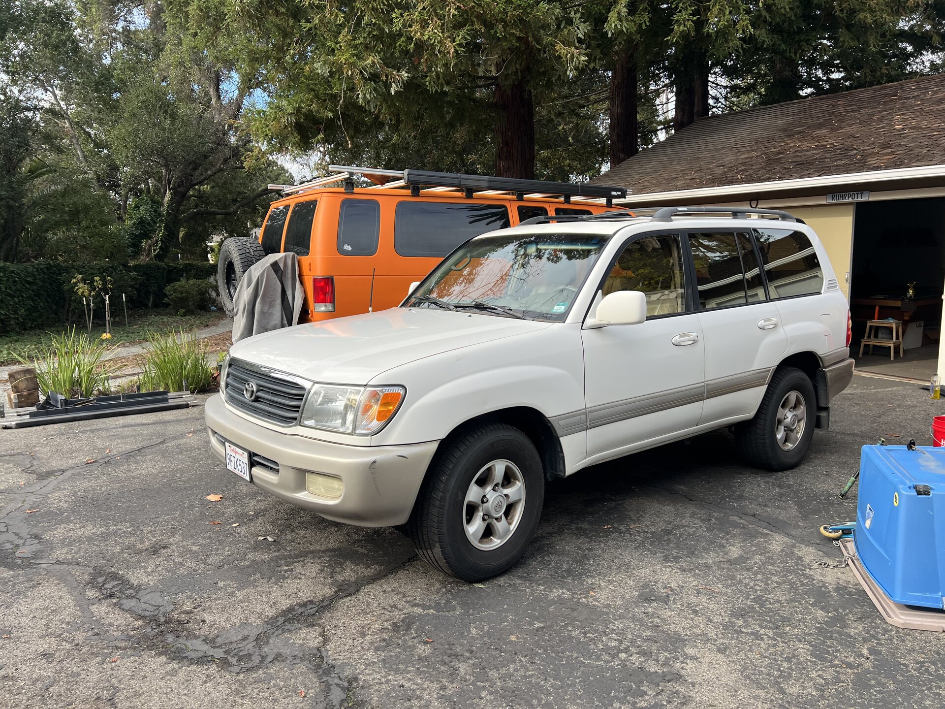

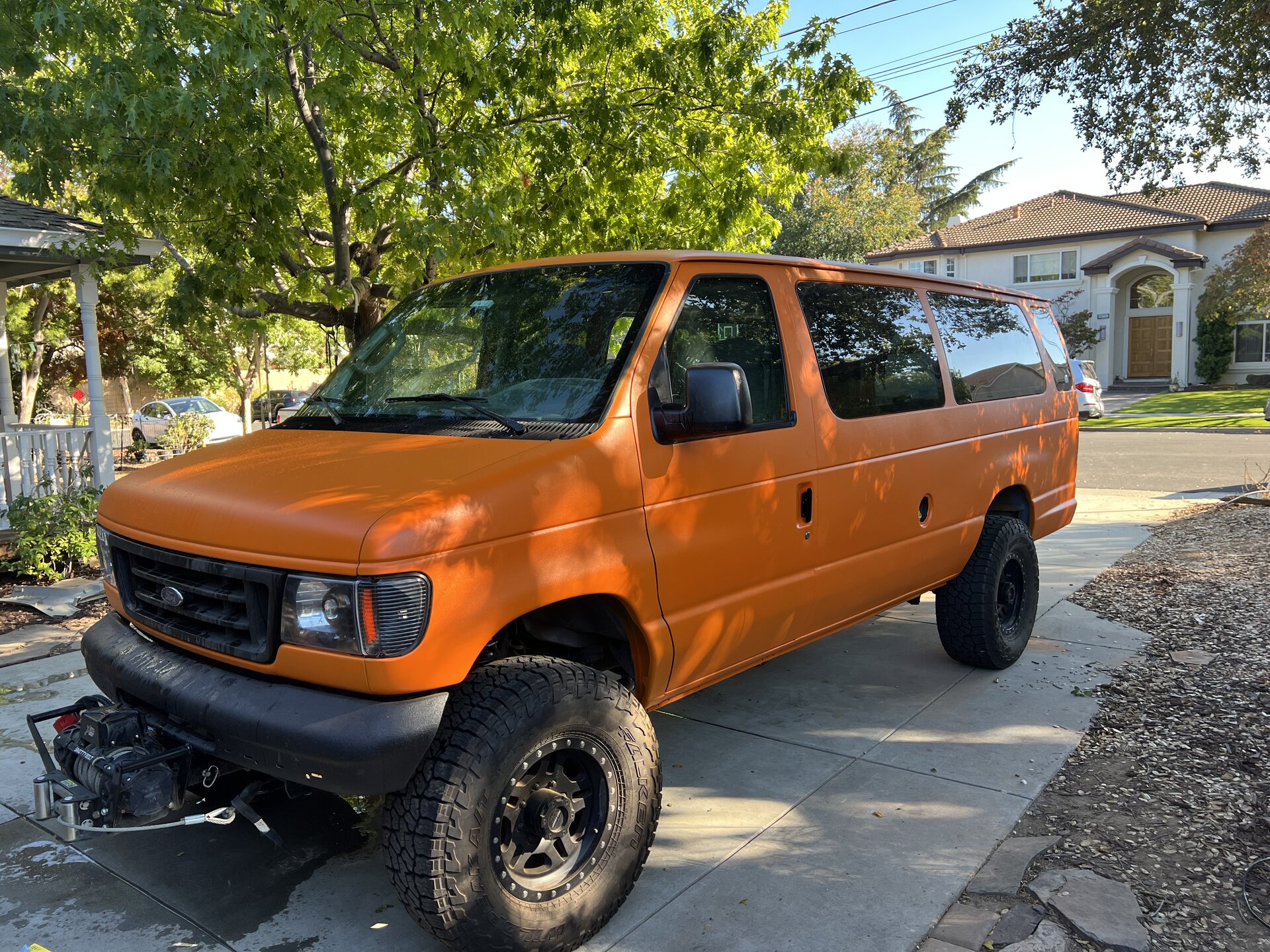

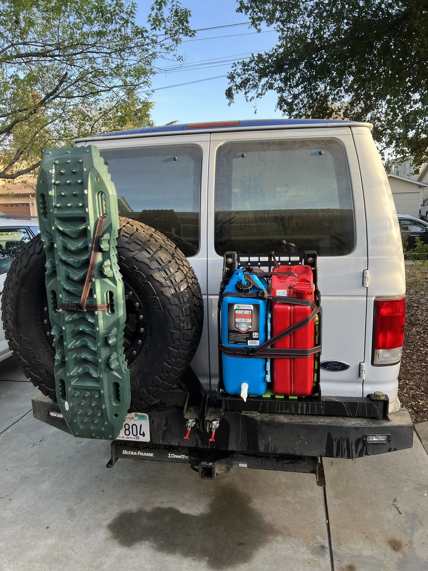

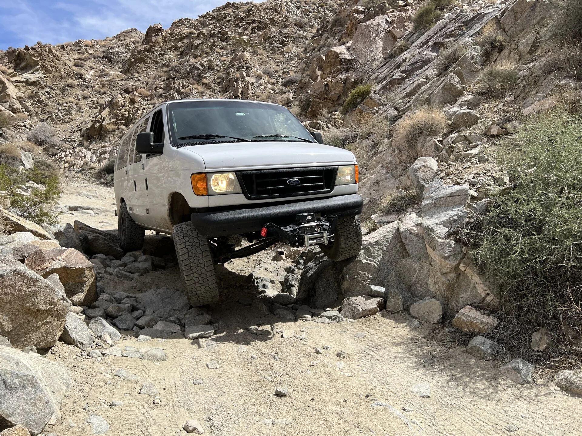

A few pics of my other one in various stages (white as bought, orange after driveway repaint and taking it down to bare metal)

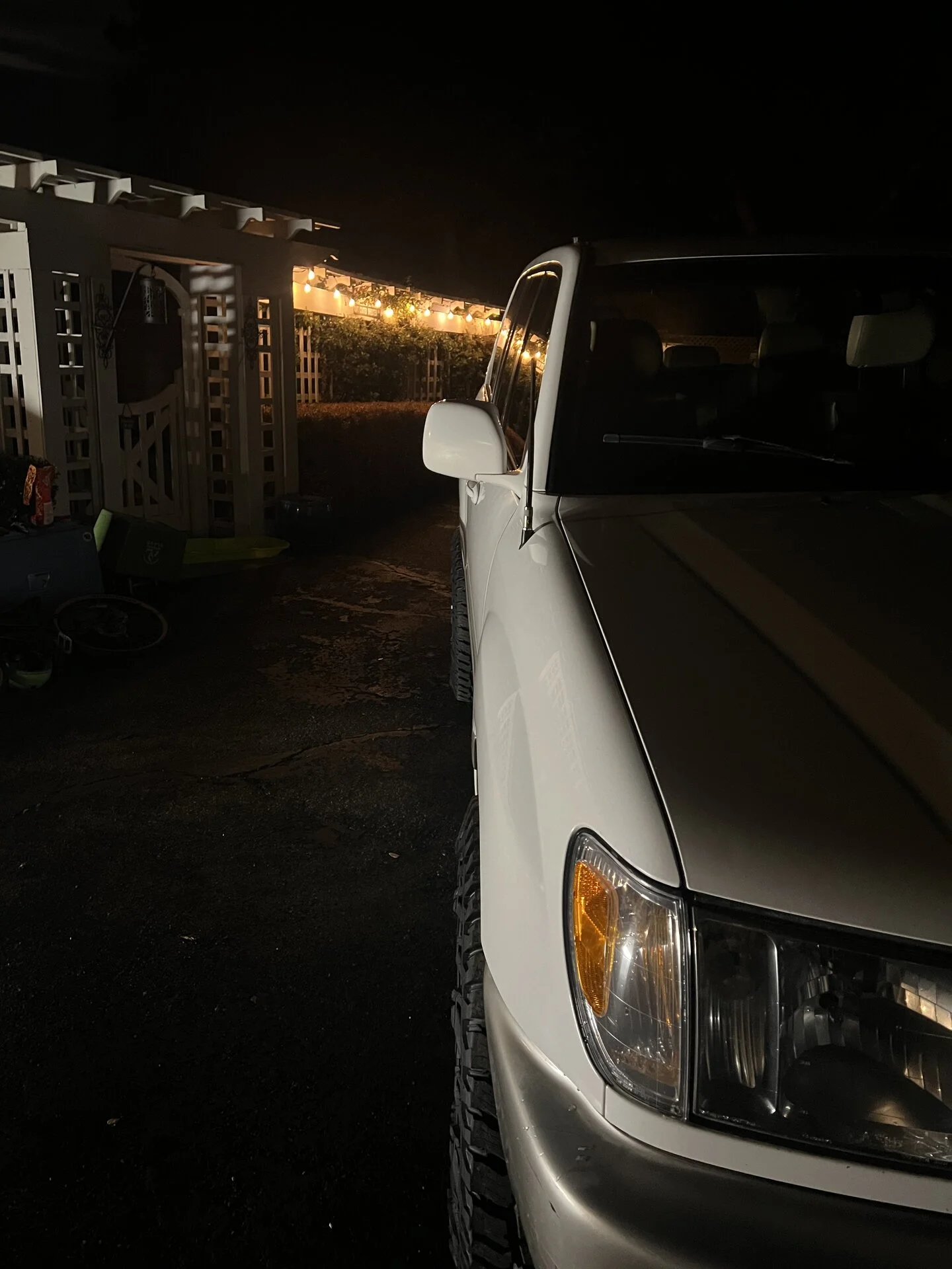

And the new baby with no name

Dig the van! Before I nabbed my LX I was looking at some E350's to build. Already had some axles from a '16 SD that were bought for a T1N sprinter 4x4 conversion. The Econo's are such a great buy since they are so much cheaper to get into than the other vans on the market, and a 4x4 conversion can be done on a decent budget.
Enjoy the cruiser!
Yep, that build was fun , but at that time I was shying away from 4x4 as I was afraid of the transmission work. 1/2 year later I had to do transmission and since then I regret my decision :-D Will also never take down a vehicle to bare metal and repaint again :-D

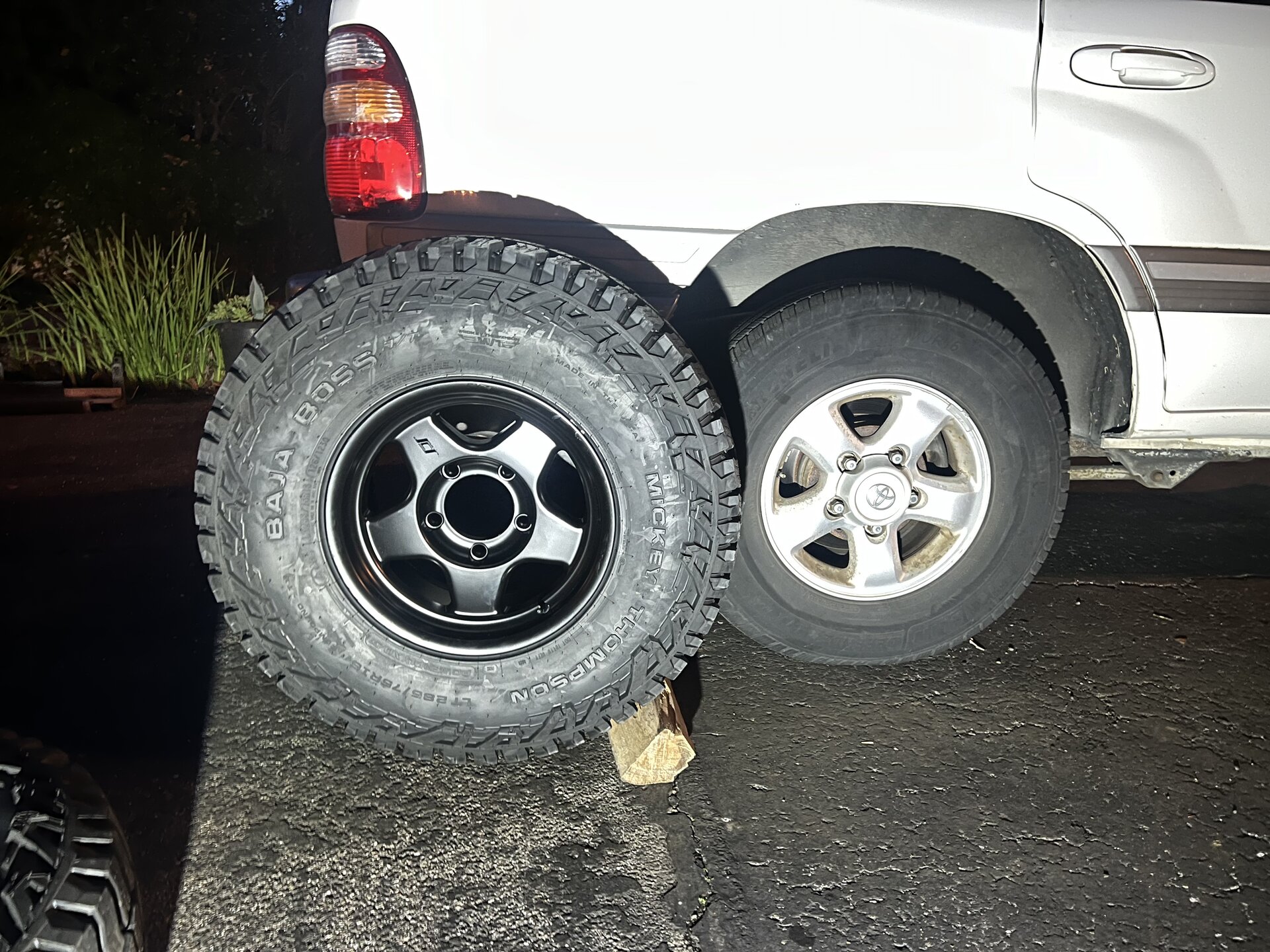

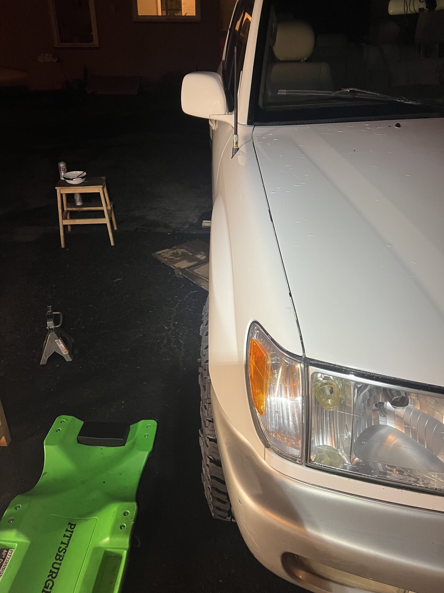

Soooo! Got my tires mounted, got new tools as I‘m afraid of LCA bushing #2, got new jacks to have enough space.
Tomorrow the journey of suspension swap starts :)

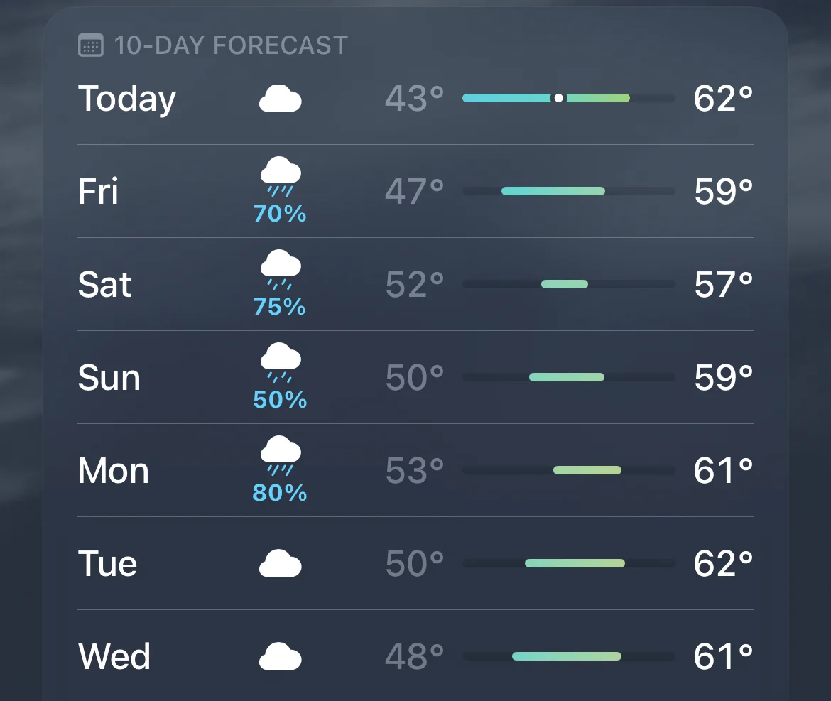

(In case it doesn‘t rain here in California…)

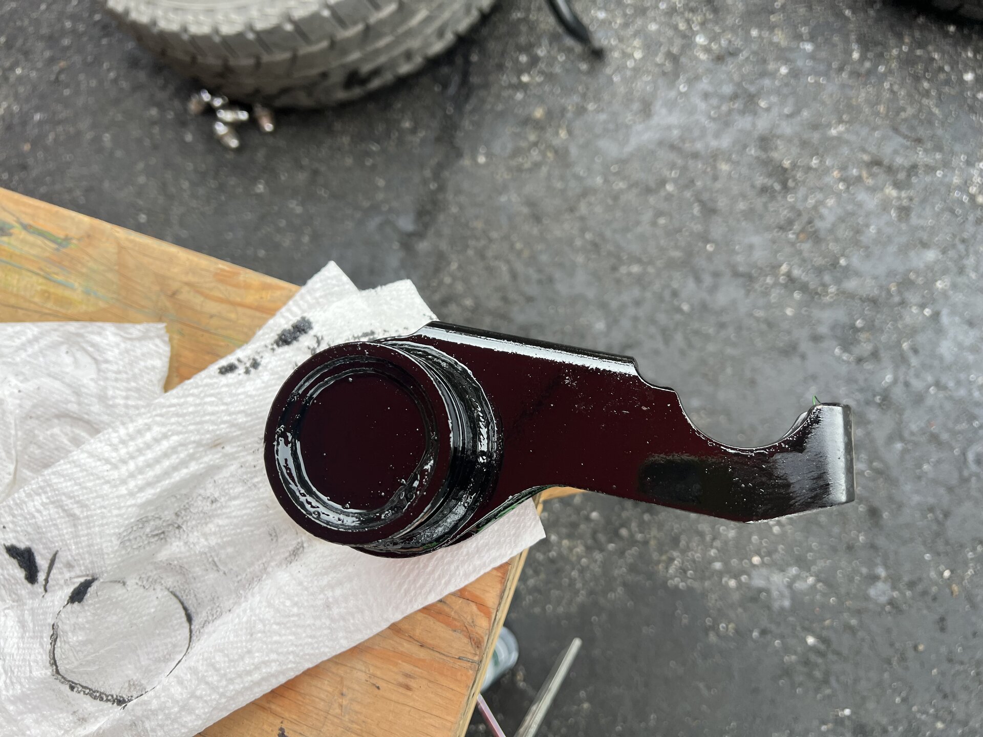

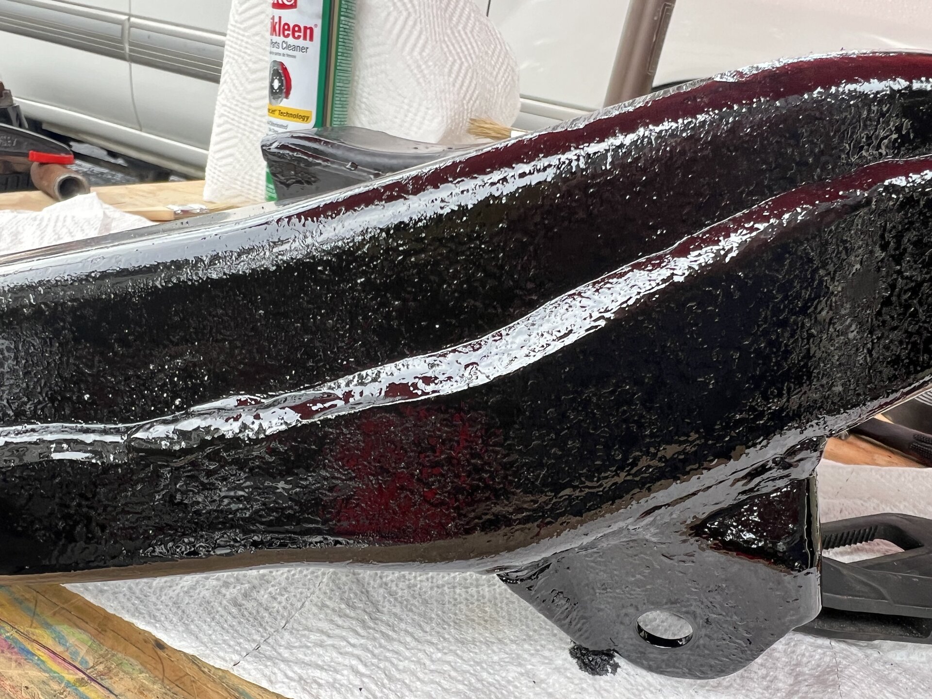

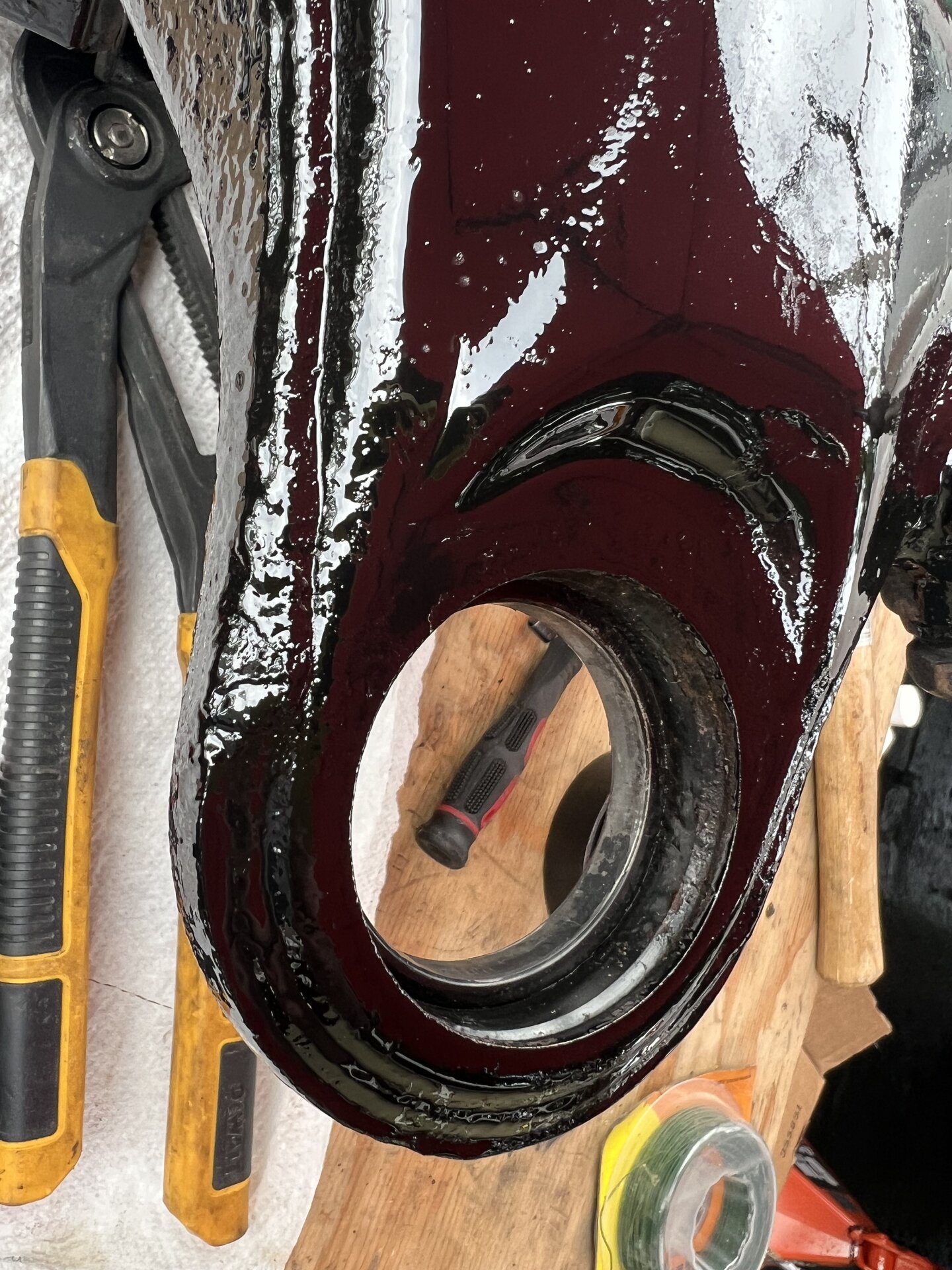

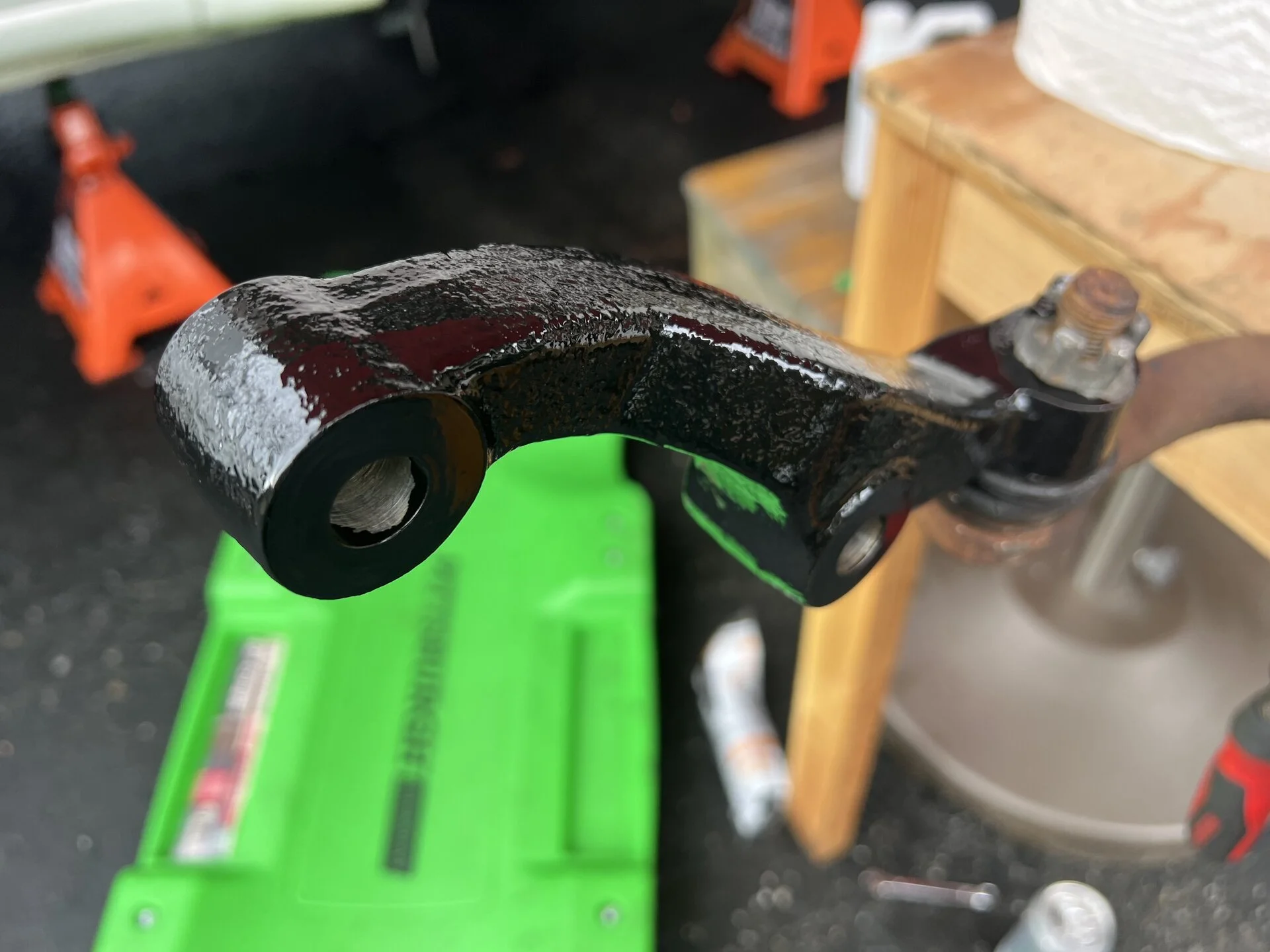

And everything I have in my hands (like LCA, new tie rods,…) will see a proper treatment via POR-15 before it goes back on.

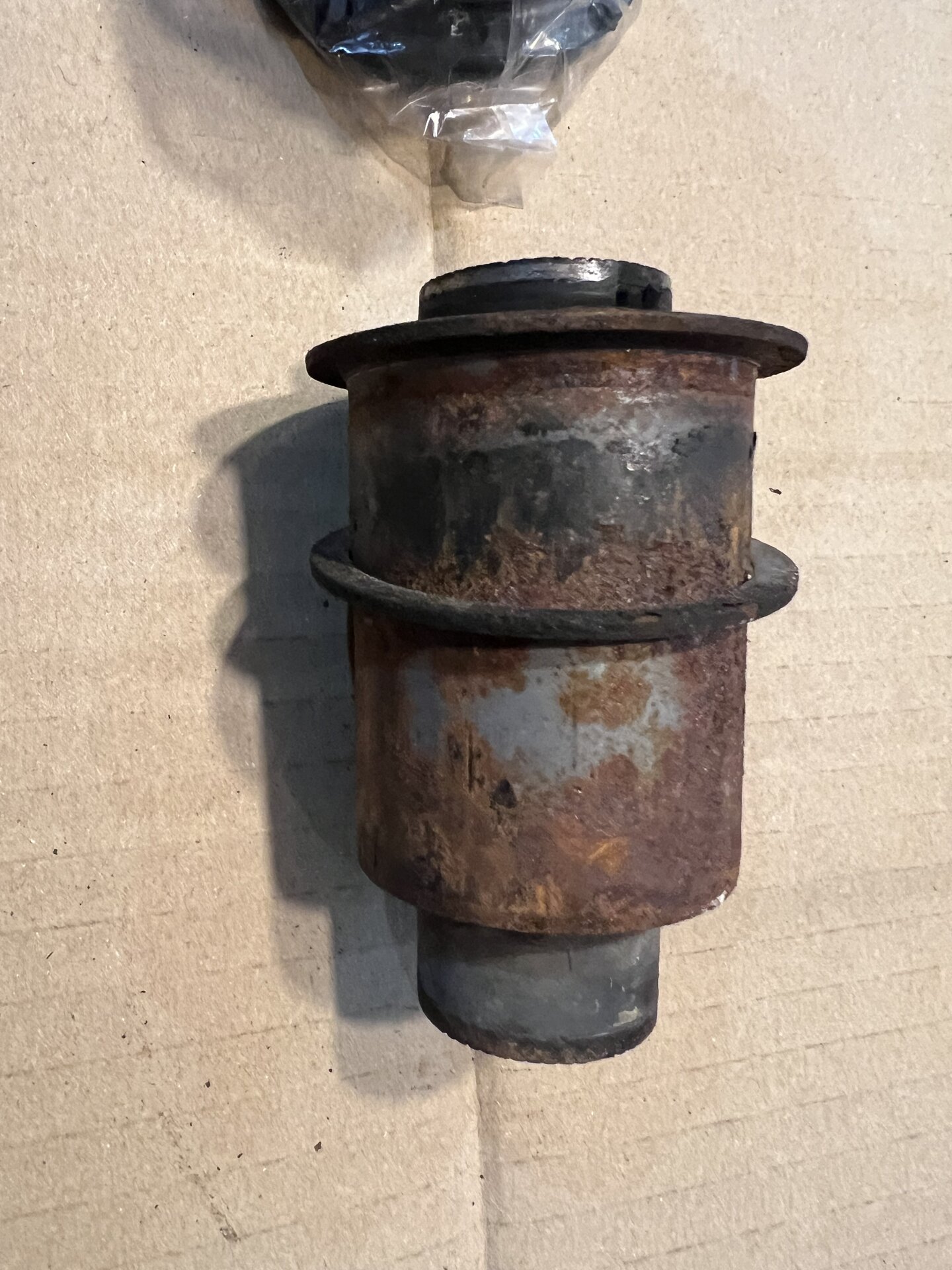

Guys… hate California or not… but you‘ll love it for the fact that after 270k miles I just got the passenger LCA bushing #2 out only using my regular 1/2“ ratchet 😂😂😂
First side is out, all TB parts marked with a punch. Now, after degreasing and etching, POR-15 needs to dry and I got to wait for parts and then it can go back together.
Just a little pretaste :-)

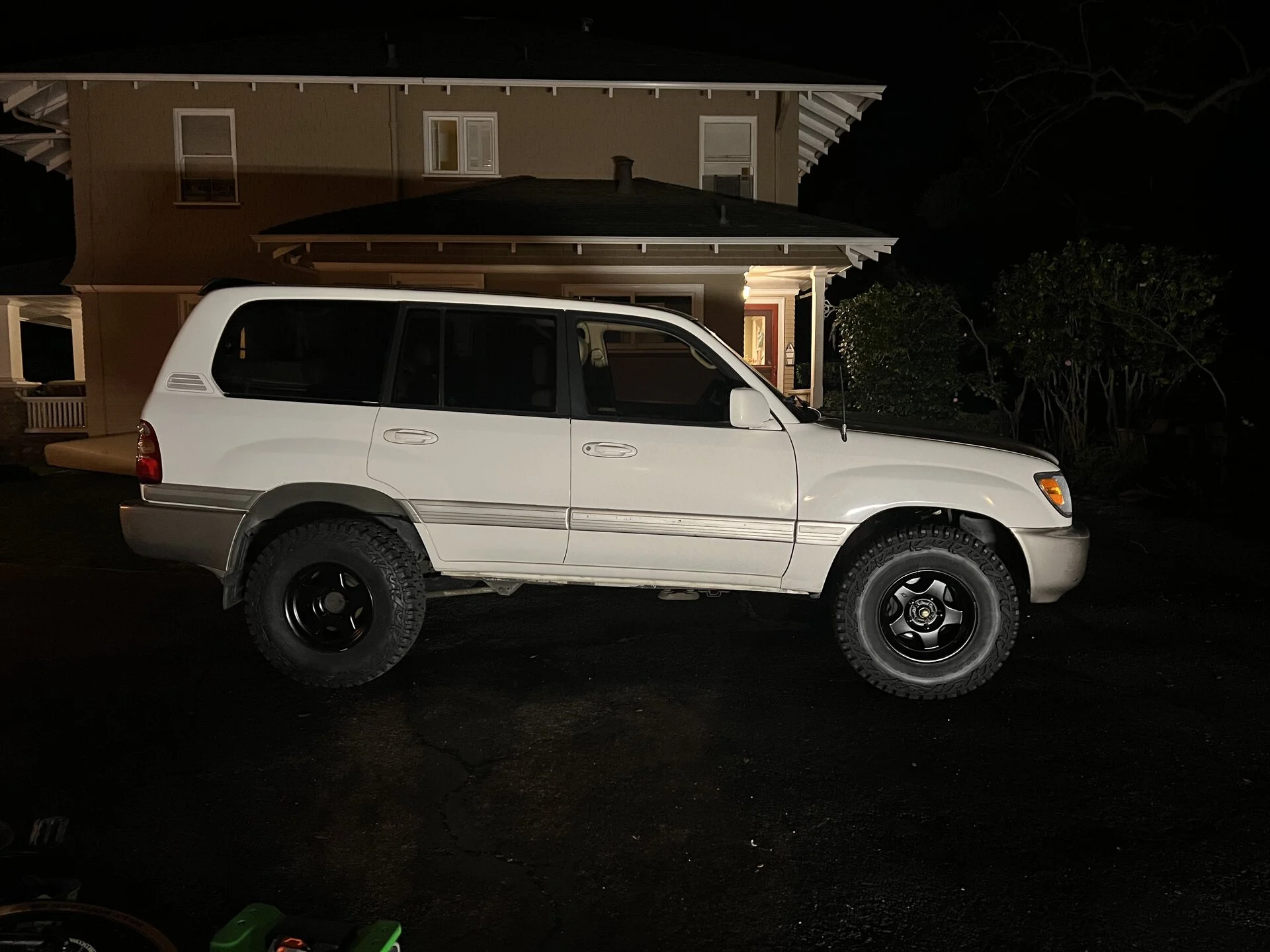

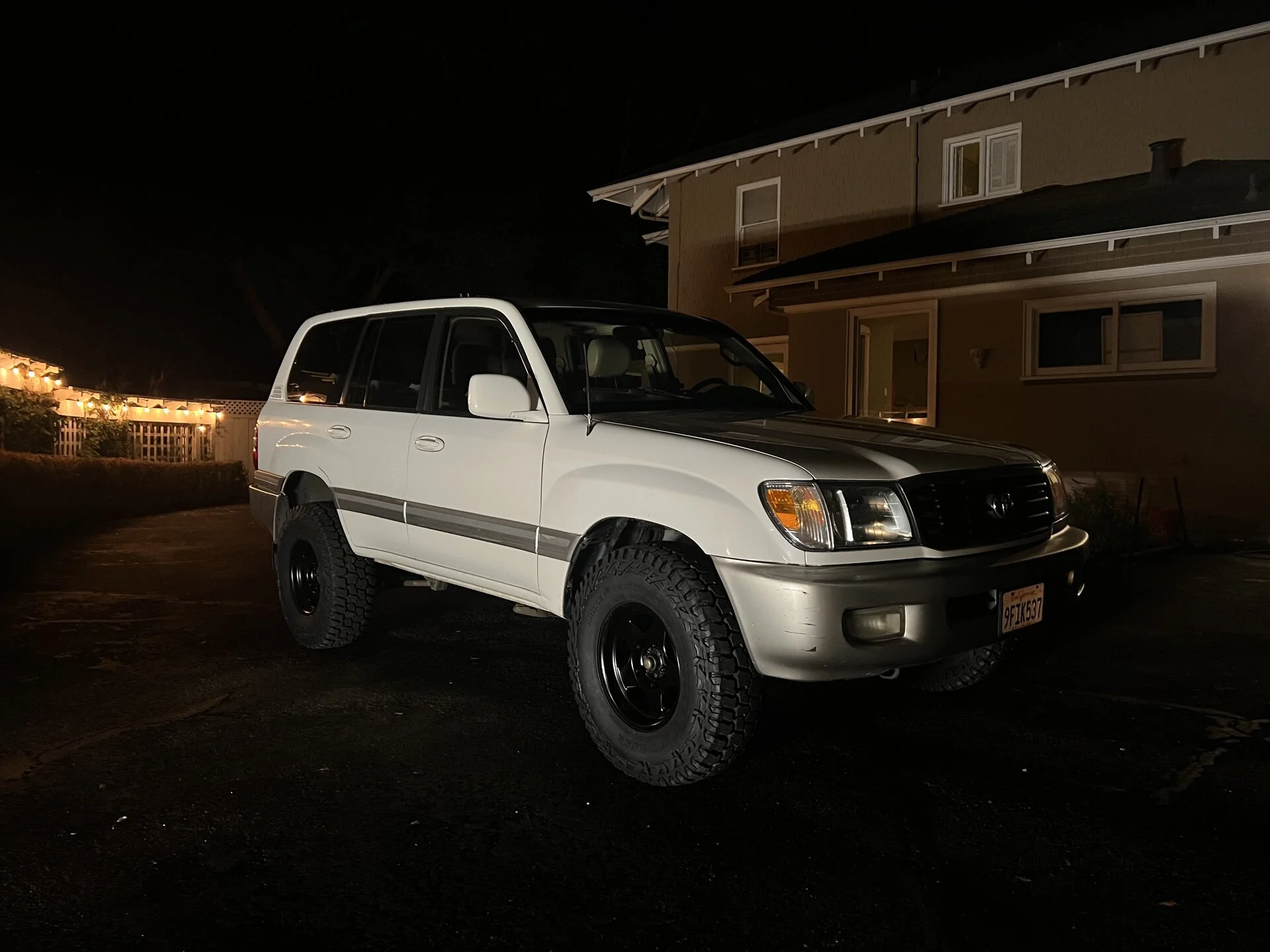

There we go! Dobinson is in, tires mounted. Got to readjust the front from now 20.5 to 22 and then it‘s more level, but still have 1-1.5“ more on the rear.
And got to take care for pinch weld/ fender as well as confirm the rear reservior is mounted in the right place.
One things that wasn‘t really obvious for me was which anti spin washer to use and which way to mount everything. The Dobinson instructions don‘t provided all info (at least not for me ^^).
But: right now I‘m happy and can enjoy my beer :-)
