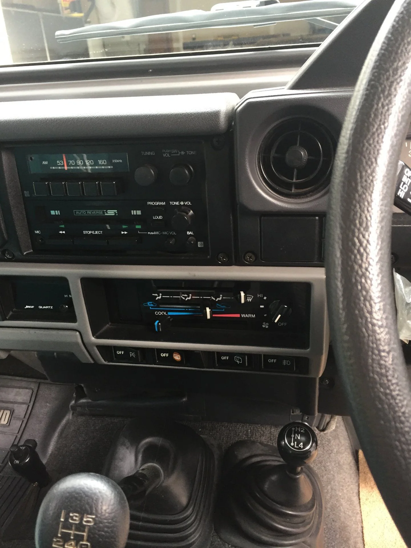

Ah, the elusive "FUN MODE" knob. For use only when on muddy inclines with an adult beverage. Seriously though....maybe it's for those fog lamps?
The fogs have their own switch which I have tested already... In the meantime, I'll go with "FUN MODE". :)

if the bumper fog lights are not oem, could be for that. the dash fog light switch usually actuates the rear fog lamp.
on my lj, I had no wiring for front fog lights and I just added another switch.
make sure your "fun" switch is not a "wilson" switch. I burned once the 6v superglow glowplugs by keeping the unmarked (unknown at that time to me) wilson switch , otherwise designed to work with 11v glowplugs.
I've wondered about that switch myself, mine was removed before me owning it, but just have a hole with the wiring. Ended up installing a different switch in that location

I did investigate the mysterious "FUN MODE" knob. One end was tied into power over at the lighter. The other end just dead-ended under the dash. Cleaned that up and maybe I'll find a future use for it. :)

As for the "F" knob...seems like the true meaning is "Future Use".

@FJ73Texas thanks for clearing up the "F" button, makes sense. Also another attribute to toyota's forethought at the time
