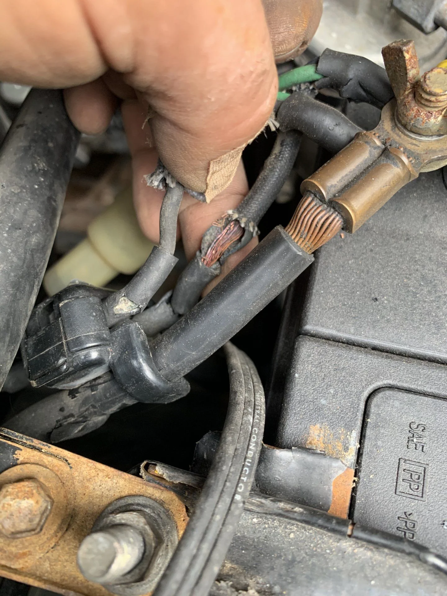

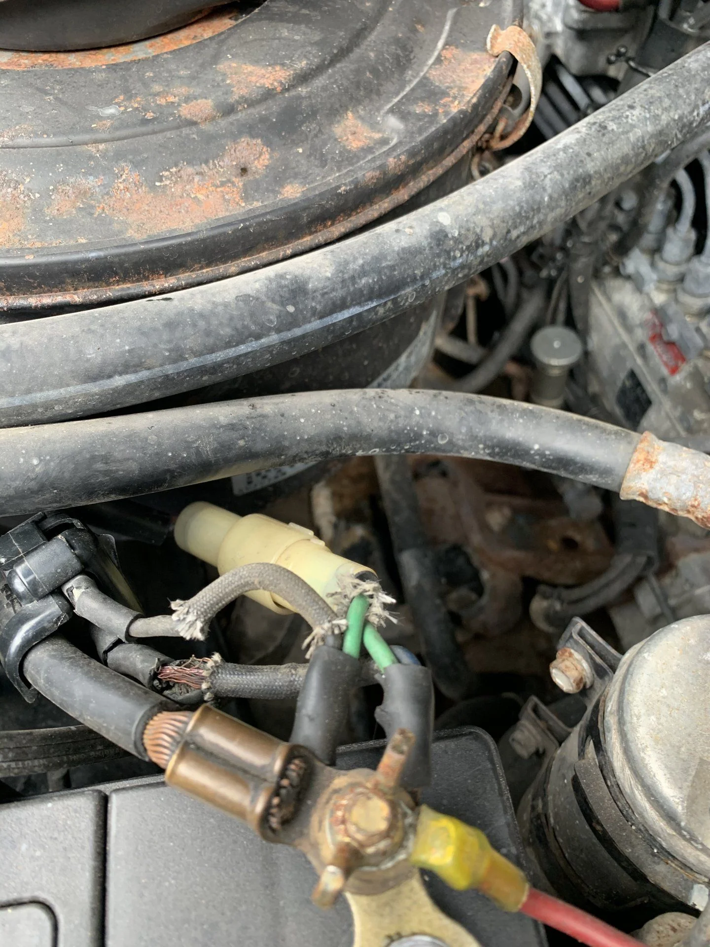

glow light now off, broken wire.

Fusible link as above was a mess. Fixed. Grid heater too...
