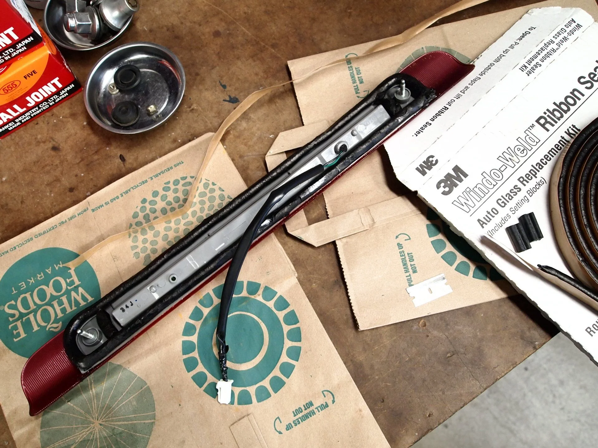

I found some 3/8" x 15' 3M Windo-Weld Ribbon Sealer at Advance Auto. It sure looks and feels like butyl and in "directions for use" they call it butyl. I also see they recommend 3M Windo-Weld Primer PN 08643. This must be and adhesion promoter.
The 3/8" butyl was way to thick, so I ended up cutting down. A 3/16" thickness would have saved time.

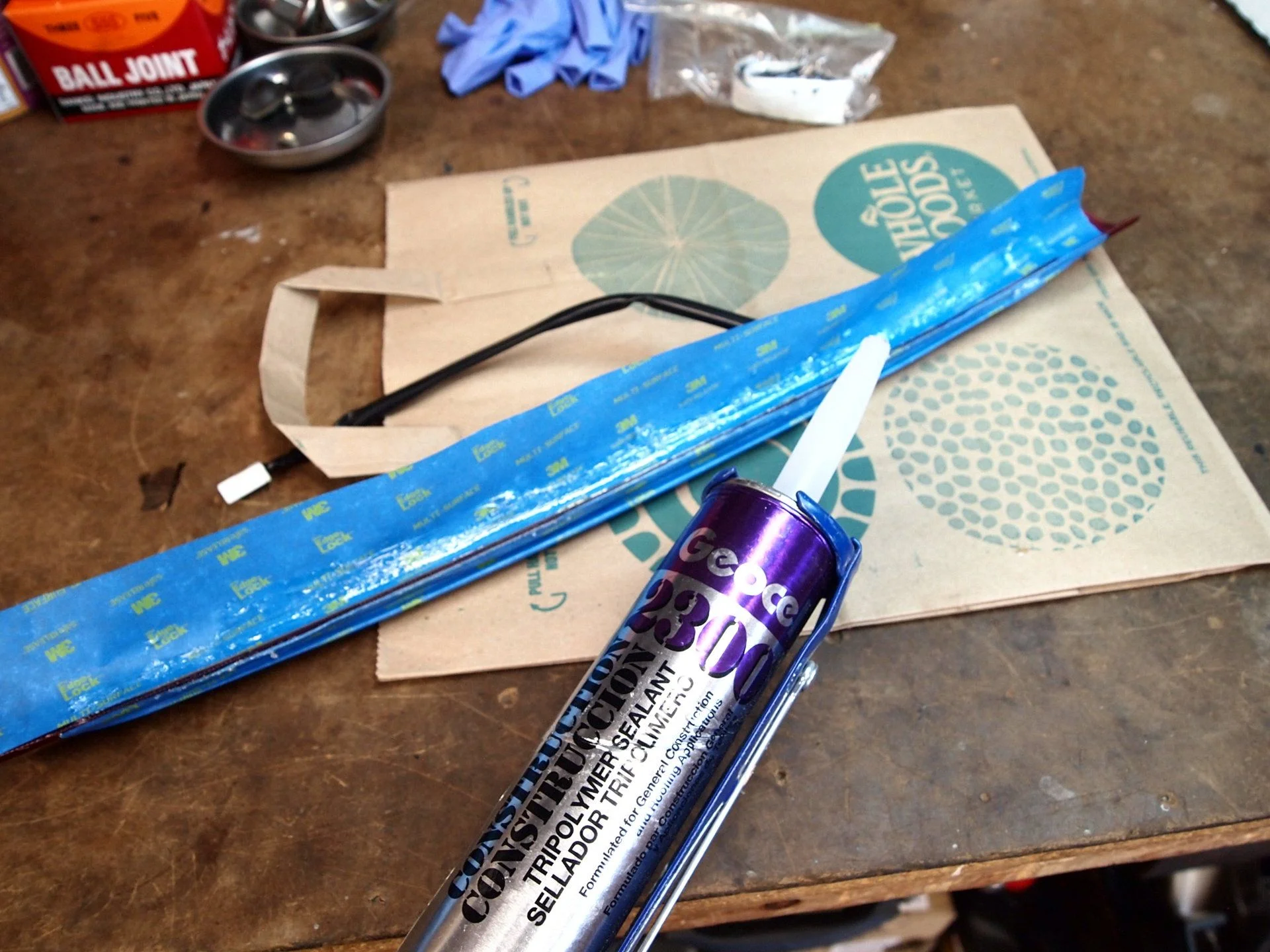

I used a household roofing sealant 2300 along seam of lense to lense housing. I don't know if leak was at this point, but did sealed it anyway along top and sides.
I then added the 3/8" butyl rope to back side of third brake light. Did a test fit and quickly realized it was to thick and working/pressing in would take a long time. So I took a razor and cut it down to about 3/16". Then still spent a good deal of time pressing it in flush.
Cleaned with 3m Adhesive remover, trying to get butyl to come up to edges then ressessing back in so not create pockets to trap dirt or so high my cleaning & drying microfiber would touch during washings.
I notice this one spot that may have been (not re-tested yet) my leak. It's where lense bonds to lense housing. As I pressed lense onto hatch to work in butyl, that spot emerged.
Once I had light seated and sured the two nut and attached the wire. I then when back and put pressure on lense again to settle butyl as much as possible. Seem slow (over time) steady pressure works best.

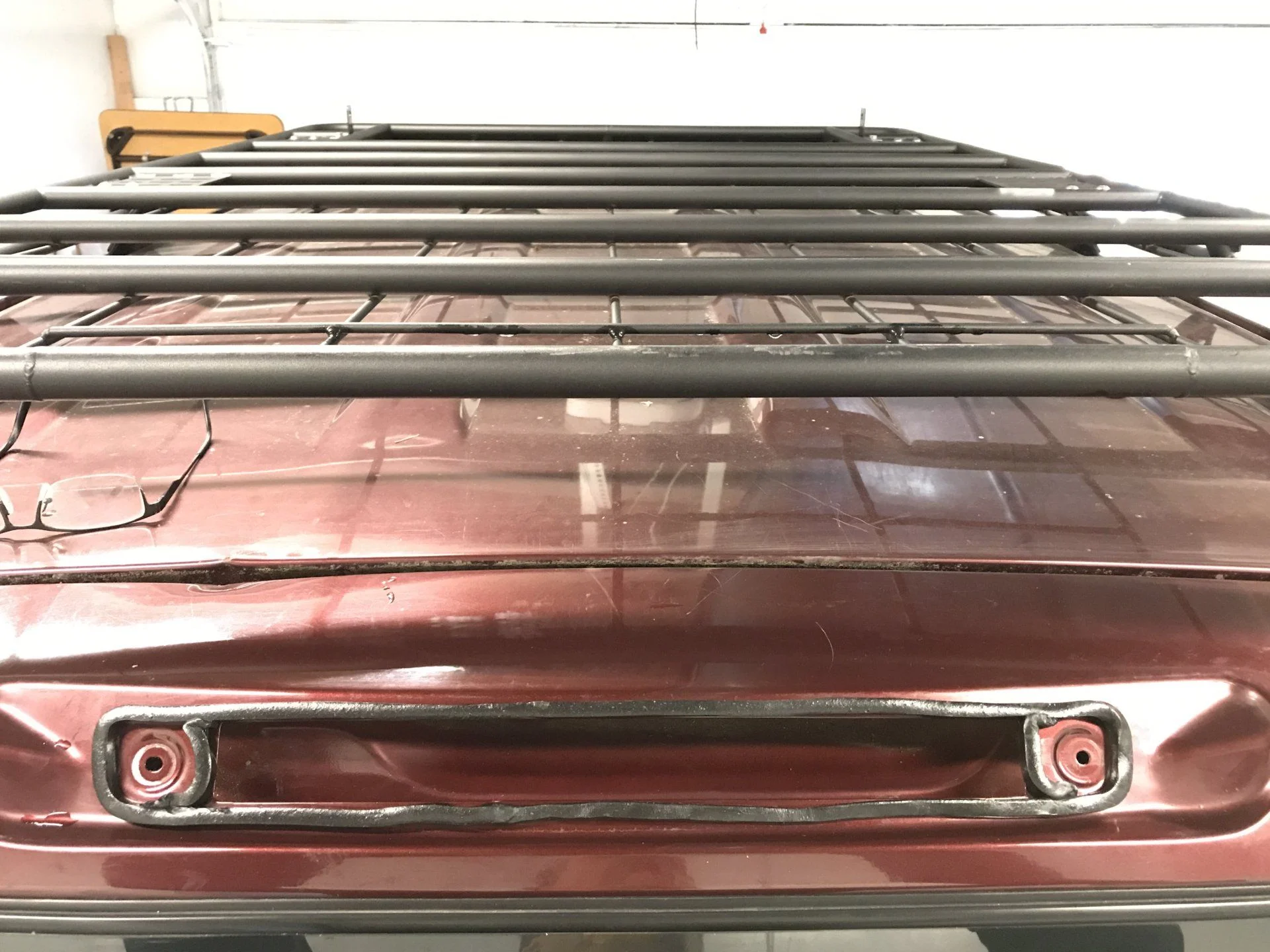

- Before removing the brakelight I confirmed the leak by removing the inside trim and hosing down the upper roof/hatch area. Lots of water dripping straight down onto my cargo carpet.
- I then removed the brakelight assembly, cleaned off the old foam gasket, covered the holes in the hatch with tape and re-soaked with the hose. No water dripping at all.
The width of the factory seal along the top edge of the light is waaaay too thin. There's only a few millimeters of overlap with the hatch metal, no wonder that it fails with age from heat cycling, etc. I'm going the butyl tape route shortly.
