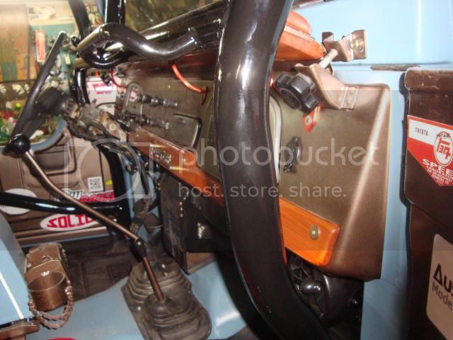

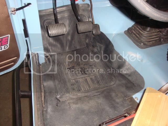

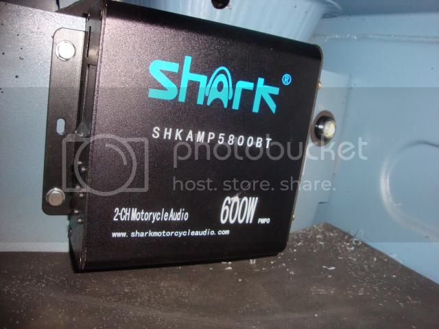

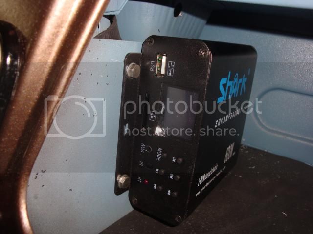

I did get the alt. and ps belts on, the last heater hose is on, shark motor bike stereo is 1/2 installed in the glove box (waiting to get the cage done and in before mounting the speakers), threw an led light in behind it to light up the glove box a bit, ds oe floor mat got rubber backing glued to it so now its not so holy and tattrerd lookin and fits pretty good. Probably some more crap but Im still in camp mode so...

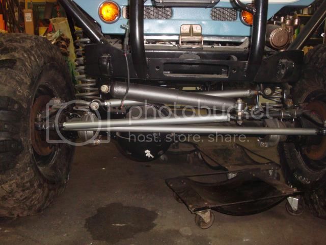

Managed to get some junk done. Speakers are mounted under the dash and to the a pillar, started an exhaust and have it done past the t case x member. Buddy gave me a long assed cherry bomb muffler so thats going in for now, made a bunch of 1/4" flanges so it can be replaced easily if it sounds like s***. Got the msd high vibration coil and mount installed on the ps inner fender..... The steering links are all tight and jammed tie rods are tight and pinned, threw an ome steering stabilized on that I had lying around with an extra ruff stuff shock mount I had left over under the winch plate.

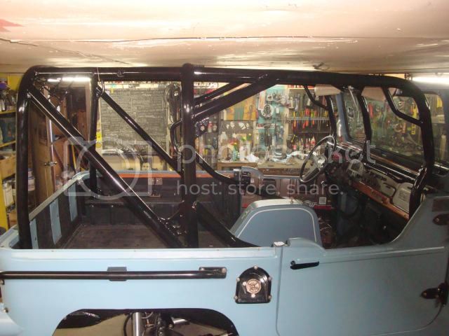

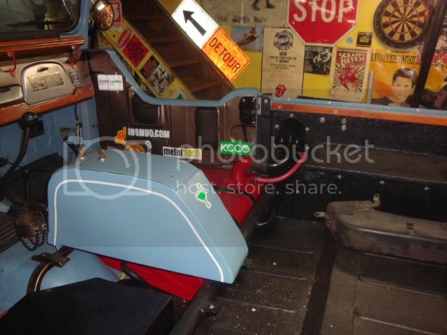

Roll cage is gone to get blasted, epoxied and painted. Seats are out to get redone. Shes got speakers now.... Exhaust is built and installed. I think thats it....

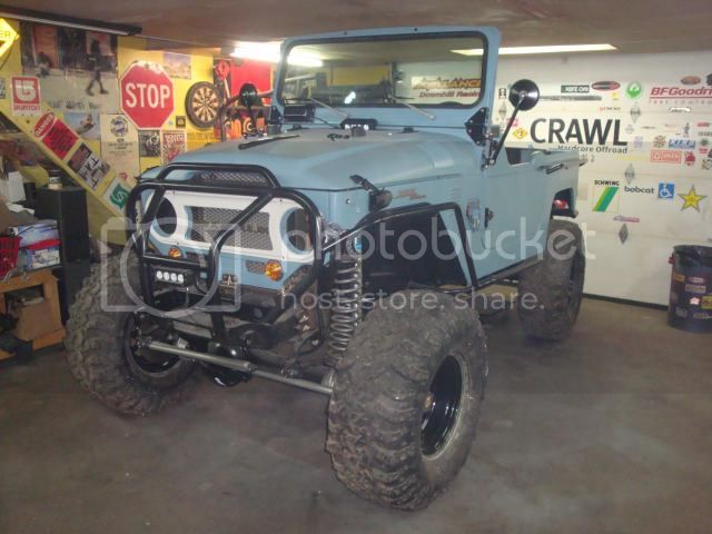

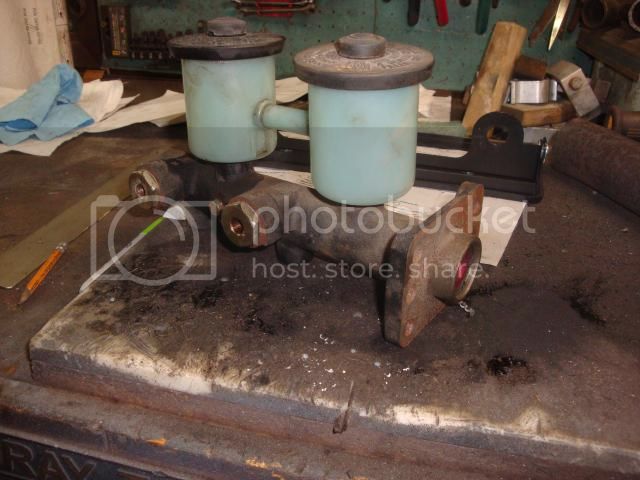

Progress pics. Well kinda, found out my brake master has a leak so thats one step backwards lol. Lucked out and a buddy of mine had one that should work from a 75 series, bolt spacing look to be the same so Im gonna try it out. Front and rear lines are roughly in the same spot so thats a bonus. Its brand new so it shouldnt leak. Dude also gave me a new style 2 bolt 79 series master and a new style 2 bolt clutch master for the hell of it. Gotta love ppl who give you free stuff

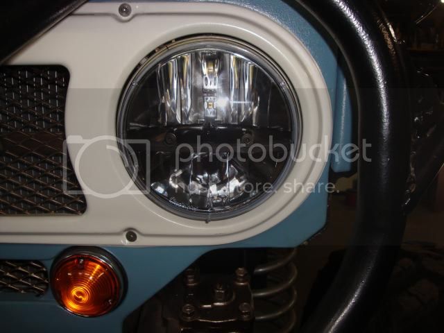

Picked up the cage and light buckets from blasting/epoxy priming/painting yesterday then in a moment of weakness pulled the trigger on a set of new style truck light led headlights. Gotta say, they look like shiny candy that I just wanna pet...
Bunch of other junk Im sure I forgot about but its all in the pics.

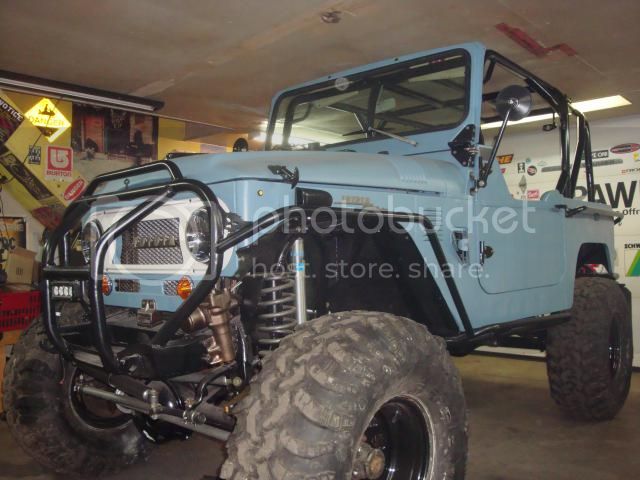

Bunch more stuff off the list yesterday.

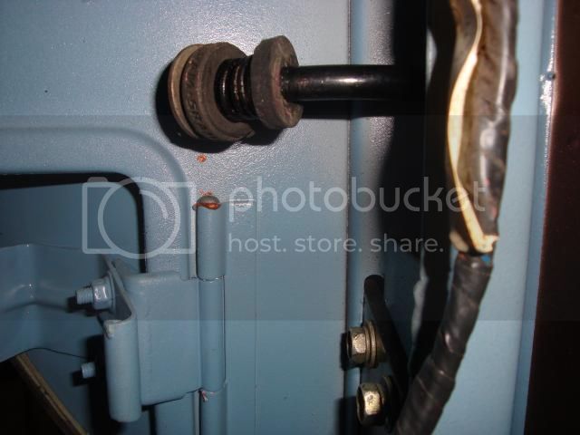

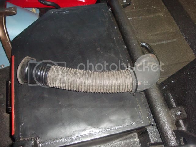

Swapped out the leaky brake master and bled the brakes. Had to make one new line but it was a nice short one so it wasnt a huge pain and Im an expert at bench bleeding masters now so I can teach classes and whatnot. Extended the ps cowl vent drain down to frame level, the stock tube came out of the firewall and was pointed right at the starter so i used a brass elbow from an old heater line to make a 90 then attached another drain line. Gave up on routing the ds drain like it was from factory (3 freaking 90* bends lol) and just ran it through the top of the tranny hump and down past the bell housing. Funny thing, I somehow had a chunk of the exact same foamy rubber hose that the stockers were made out of, love finding random stuff you didnt know you had.

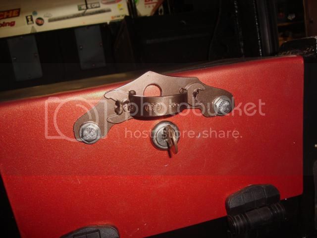

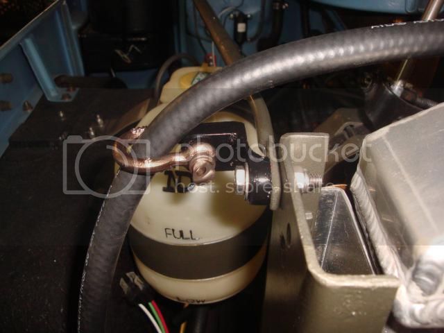

Found out the key for the lock on my stoosh box under the ds seat hit the handle so I threw a new one together with some 1/8 plate and an old acme wrench i bent up. Half assed but it works. Threw the third brake light on, drilled a hole in the fw for my speedo cable, then for some unexplained reason I spent an hour making the most complex overflow hose holder dealie ever made. I had the stock clip attached to the side of the rad mount where the support rod bolts on but it wasnt the right shape to hold the hose good and it ended up getting all bent to s*** from someone tryin to make it work. Ended up using a piece of 1/8, a piece of 3/8 and a hole saw slug to whip up a new one. Had this little mini clevis lying around so it holds the hose and is attached to a mini tow point lookin bracket thats bolted to the rad support.... Yeah.

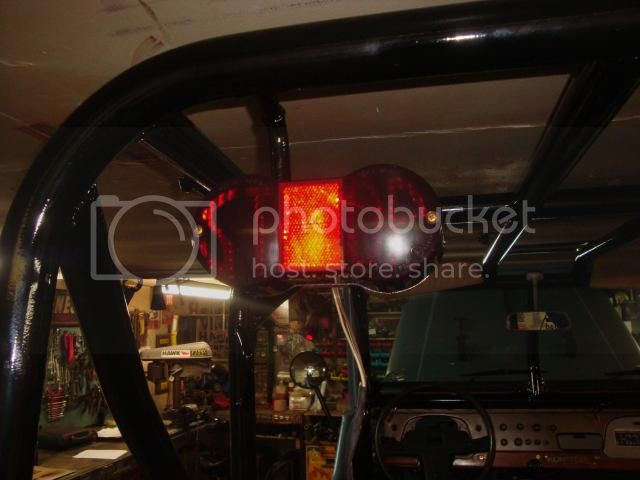

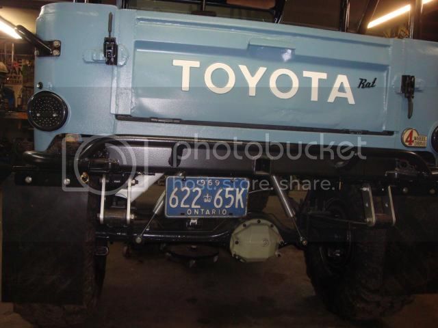

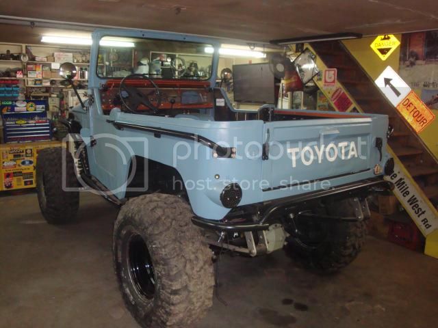

No beef missing from this rig. It's been a while since I caught up with your progress. The taillights look great.
Thanks man, was wondering what ppl would think of the transport exhaust light buckets lol. At least I can say theyre one of a kind....... lol.

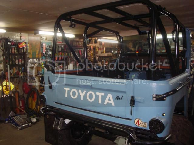

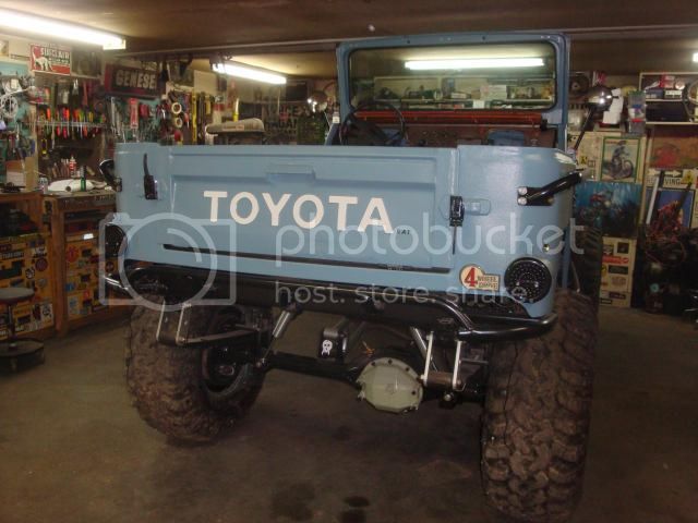

Love the tailgate!
That exhaust is going to melt your bushings. Ask me how I know...
Yeah, it is kinda close to the shackle eh? Lol. Ill wait to see what it sounds like before I chop it up. If it sounds half assed ill mess w the tail pipe a little and get it to a better spot.

Took a break from tryin to start the 40 yesterday and invented some front bump stops. Cut up a pipe that fit nicely into the coil bucket posts and welded a 1/4" cap to it with a big bolt welded through a hole in the center. The pipe fits into the coil bucket tube with an extended tj? bump stop bolted to it and is held in place by a nut/ bolt. Turned out semi adjustable lol, just have to drill another hole in the bucket pipe and slide the stop mount up or down.
Took this opportunity to make and throw on some coil isolator rubbers and paint the coils since they were out.

Aside from the fabrication and build, I like all the little details you add your your builds like the D-shackle hose bracket, JD sticker, open end wrench welded to roll cage, tailpipe trimming, etc... Lots of Rat Rod inspiration. Great work.
