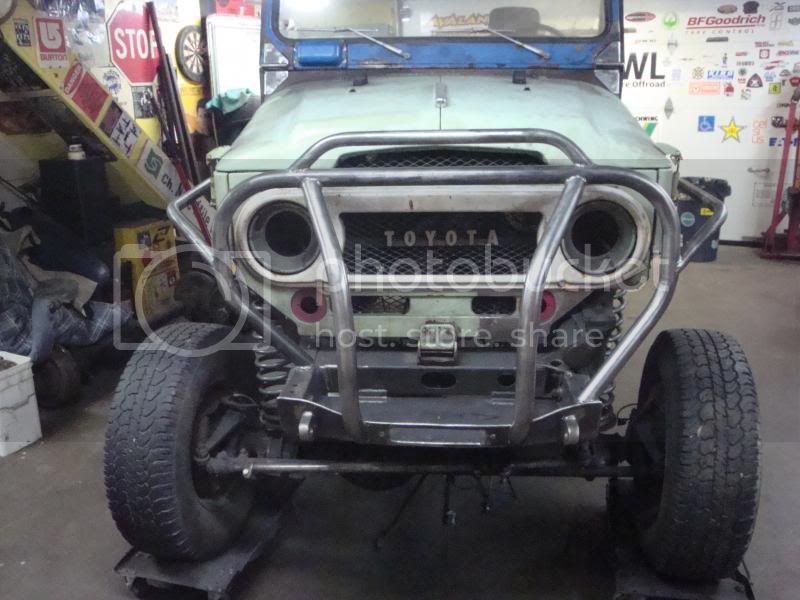

Made up a grille guard thing today....

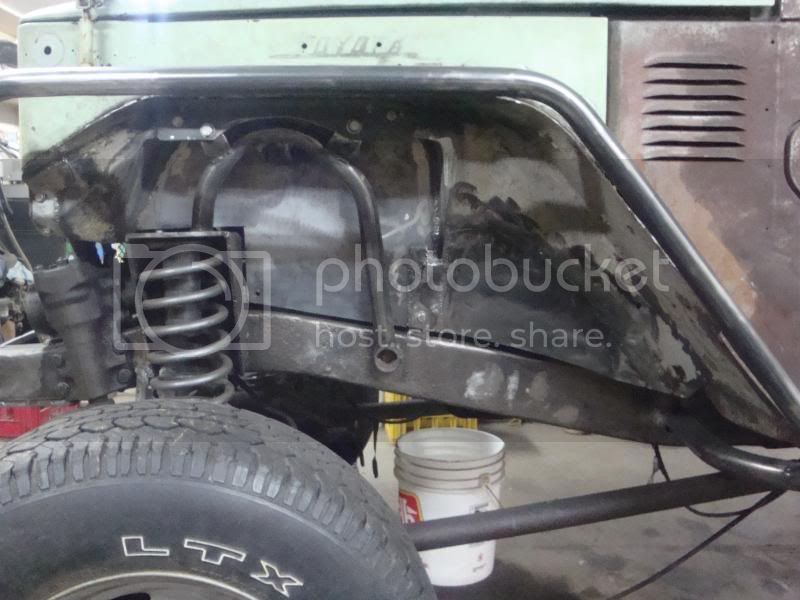

I was just looking back through your build thread and have a couple of questions. First, with your new suspension arms, do you expect to have any tire interference when you turn, especially with bigger tires? Also, which coils did you find to use? How much space did they leave between the tires and frame rails? I plan on using a similar width axle to the 60-series.
The coils are from a v8 zj (grand cherokee), 4" lift coils. No interference from the coils or buckets and a 37" tire rubs on the radius arm at full lock but only slightly, only every second outer lug. Some 3.5" bs'd rims should help with that. That being said I tried the 40's from my sixty on today for the hell of it and they would definitely rub lol.

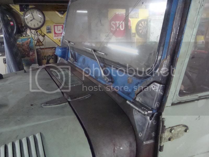

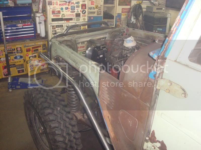

Well, since photobucket is being a dick there isnt any pictures but I am making progress. Ordered ss hardware for the w/sh hinges, hood hinges, and a couple other things, should be in today. I cut apart the ds w/sh hinge and put in some new steel to replace the po's hack job then stripped both hinges down and welded up the 30 grinder cut marks (Im guessing po slotted the screws when he stripped em). Turned out looking like unmolested hinges...

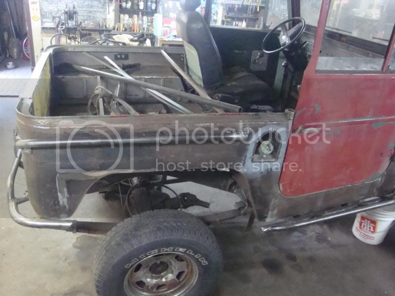

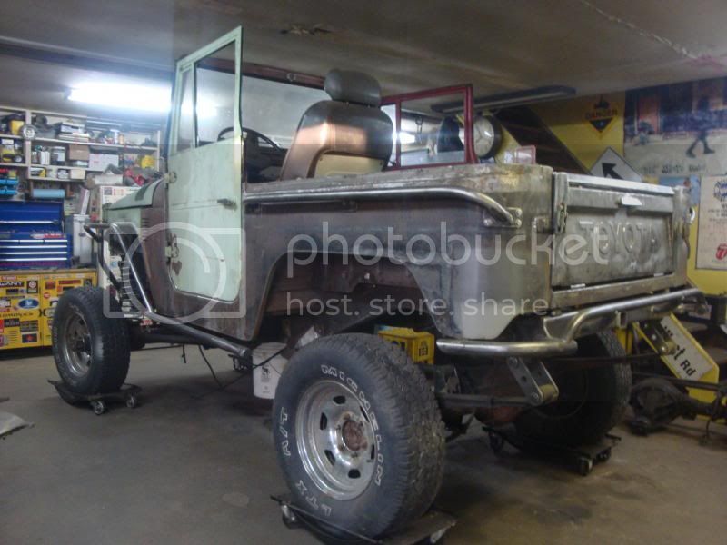

Finished off the ds inner fender by plating over the old steering box hole and capped the bottoms of the tail gate posts yesterday then started something new since I still have the bender. Made some bolt on rub rails for the sides of the tub.... Still have to finish weld and pretty up but I think I like em.... maybe.

Finished up the rub bar things, they look ok I guess. Pics of the hinges and inner wheel well jobbie.

Thanks. Yeah, I use the 1/4 protection on the sixty quite a bit, theres still bark on the tube from last summer lol. Could have been sheet metal.

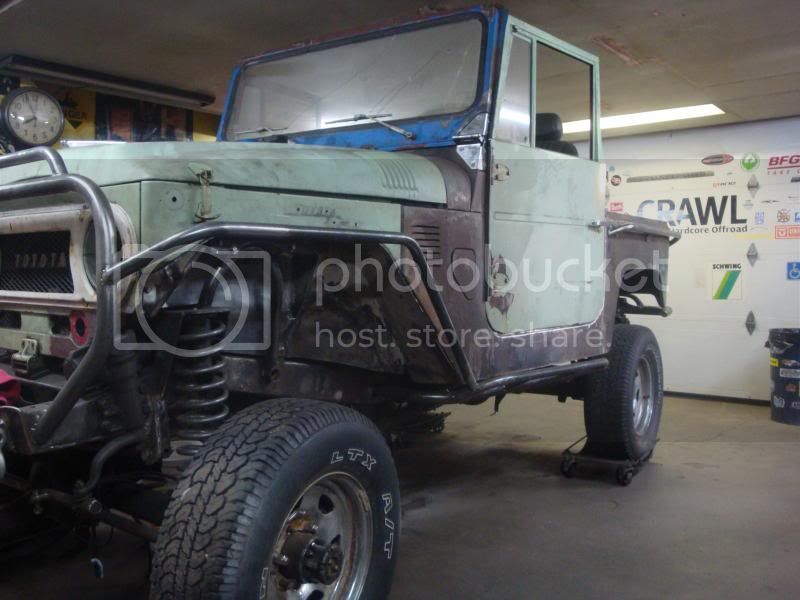

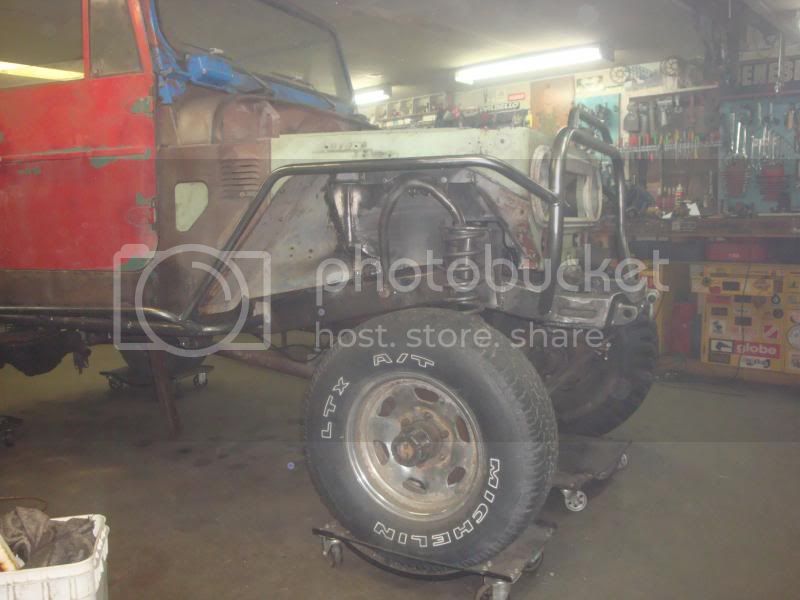

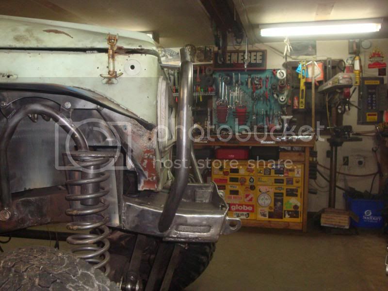

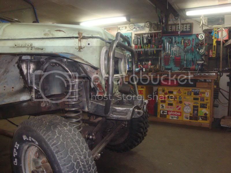

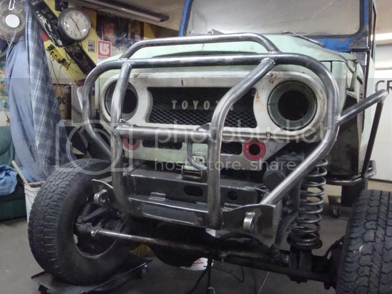

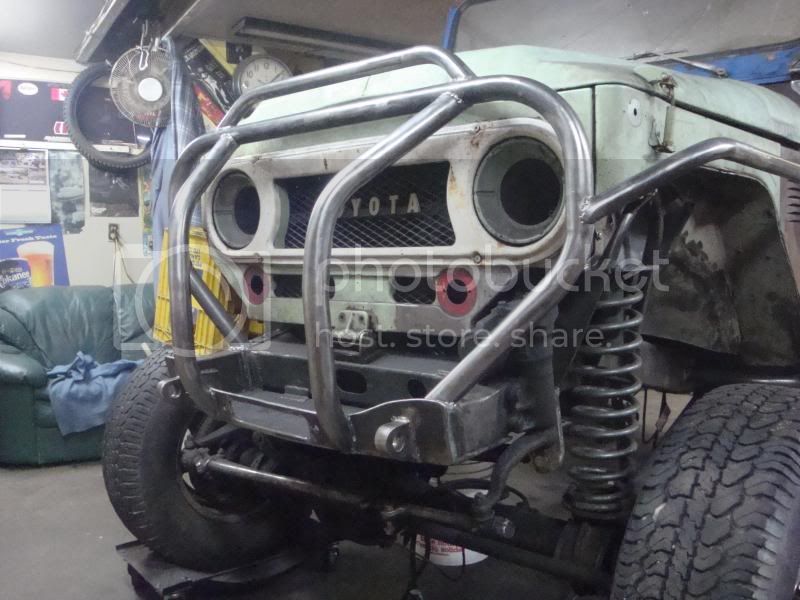

Added a couple tubes to the front end yesterday, I like the way it turned out.... Ended up moving the lower grille hoop tubes up a little and welded em to the top of the frame instead of the side, forgot about tire clearance and such the first go around lol.

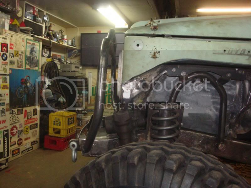

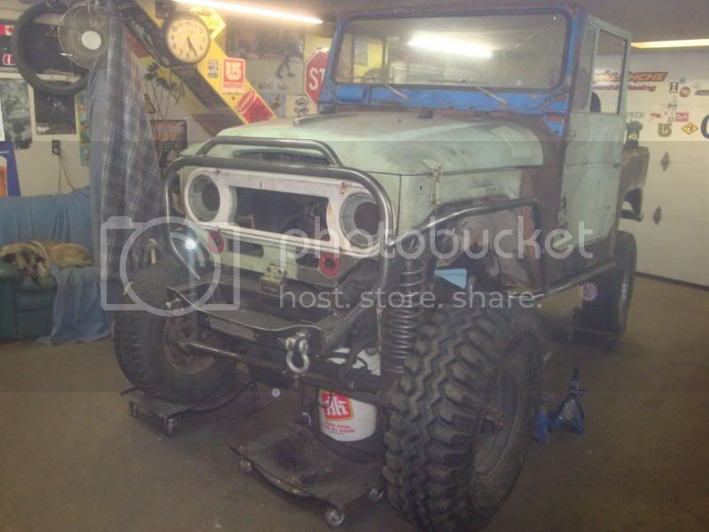

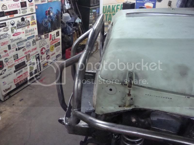

One last tube, couple gussets and a winch hook thing.

Yeah, I'm trying to make uneven the new even you know? There's too much eveness out there imop lol.

Threw a 1"x1/8" strip under the outer edge of both front fenders yesterday and fixed more rust on the ps one. I then proceeded to drink beer and that turned into.... new outer front fenders ... fenders made out of cedar planks lol.. Yeah, thats when we called it a night and concentrated more on the beer and less on the fourty.
