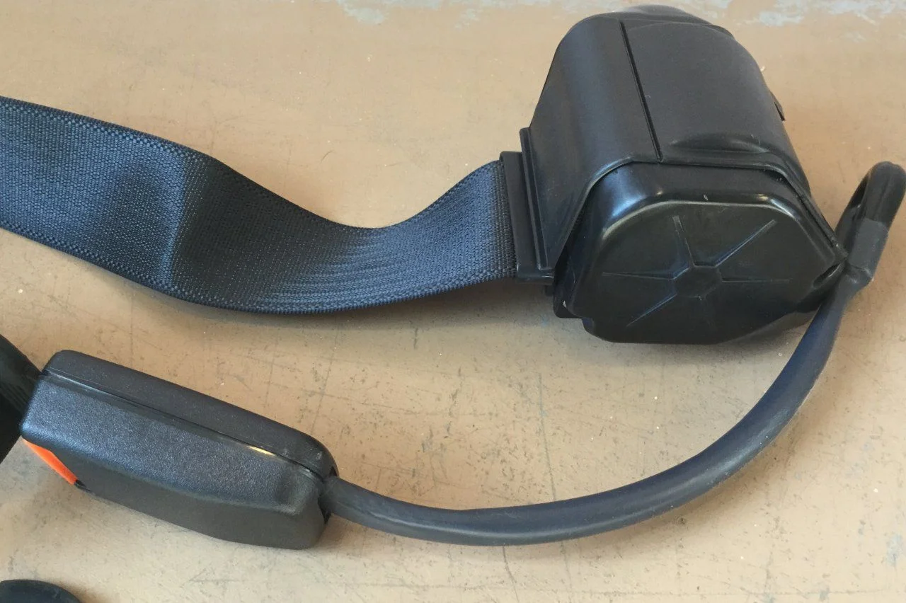

Have you mounted the retractor or just holding it in your hand? Once it's mounted....bolted into place...it should operate correctly. I don't know why it is like that but several reviews referred to that as well.
Mount it up and see if it works.

Just received my Humvee Seat belts in the mail today, I have to say how impressed I am, especially for the price. You are right, initially I thought they defective until I did what you said and hard mounted them. It is very weird how they don't retract while they are in your hand. Thanks for the referral TCSTARK. These are a great buy and I highly recommend them.

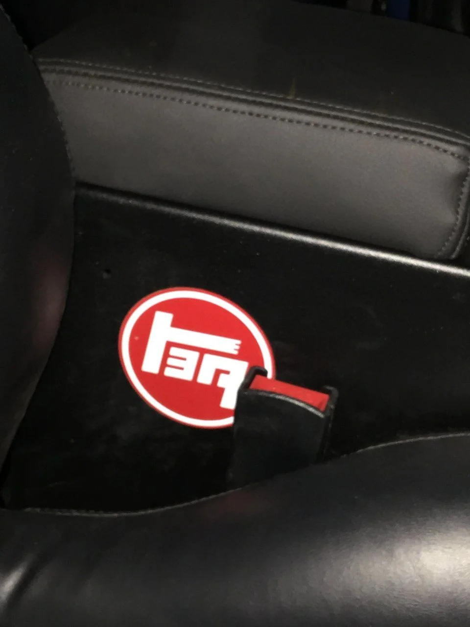

Just installed mine... Two issues: 1. Receptive that you latch into rides too high with original seats 2. Bolting retractor portion to exiting threaded hole in tub rail is convenient, but way too weak of a mounting point with an under rated bolt (too small in diameter).
So corrective action, IMO, is mounting retractor on an additional bracket attached to base of roll bar AND getting after market seat that will likely rise higher and provide better positioning of newly mounted latch receptical.

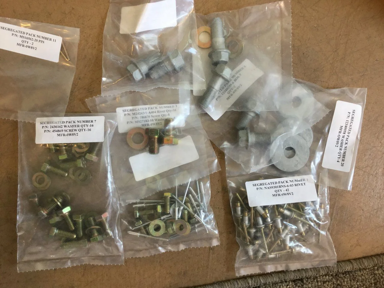

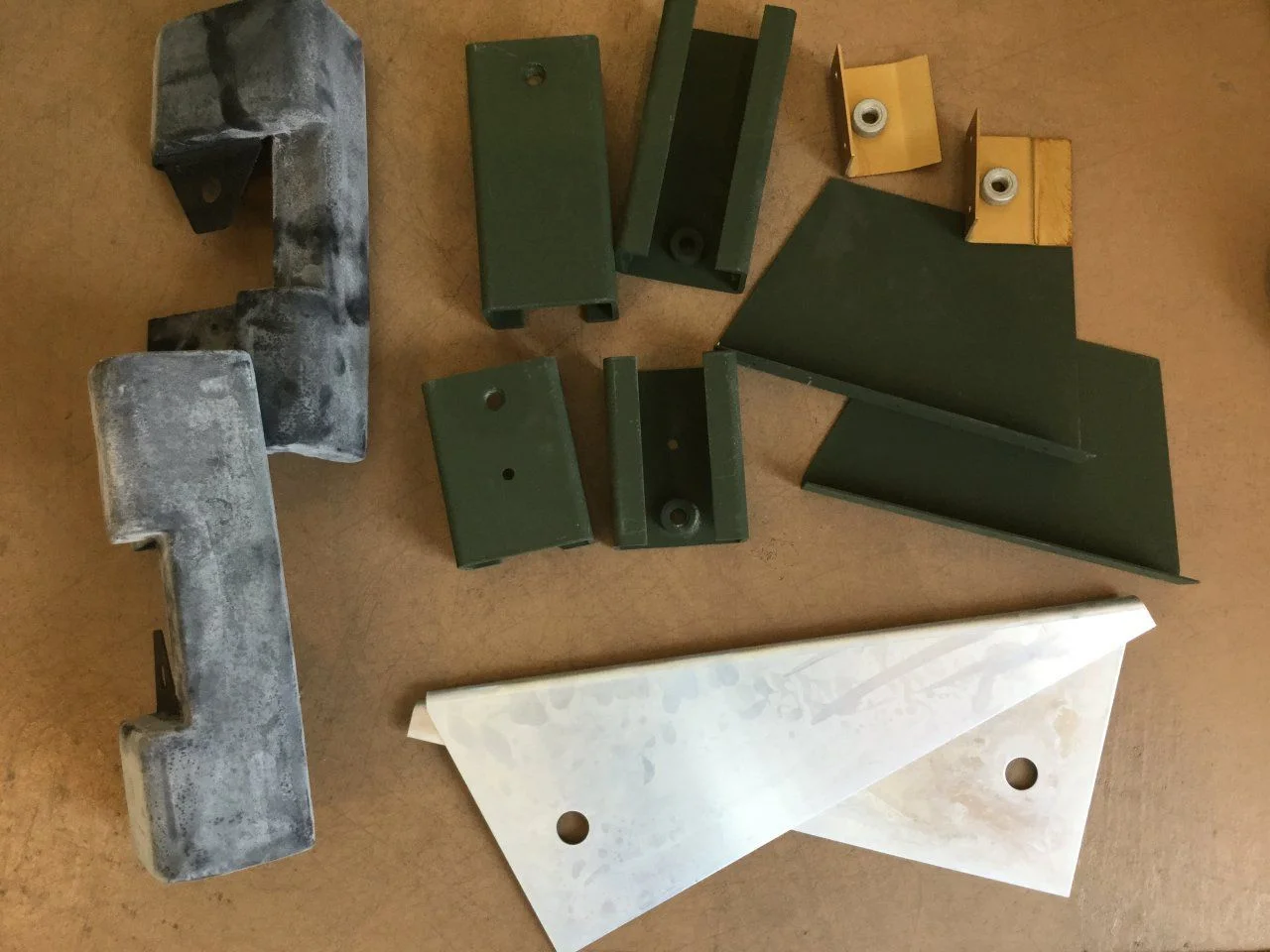

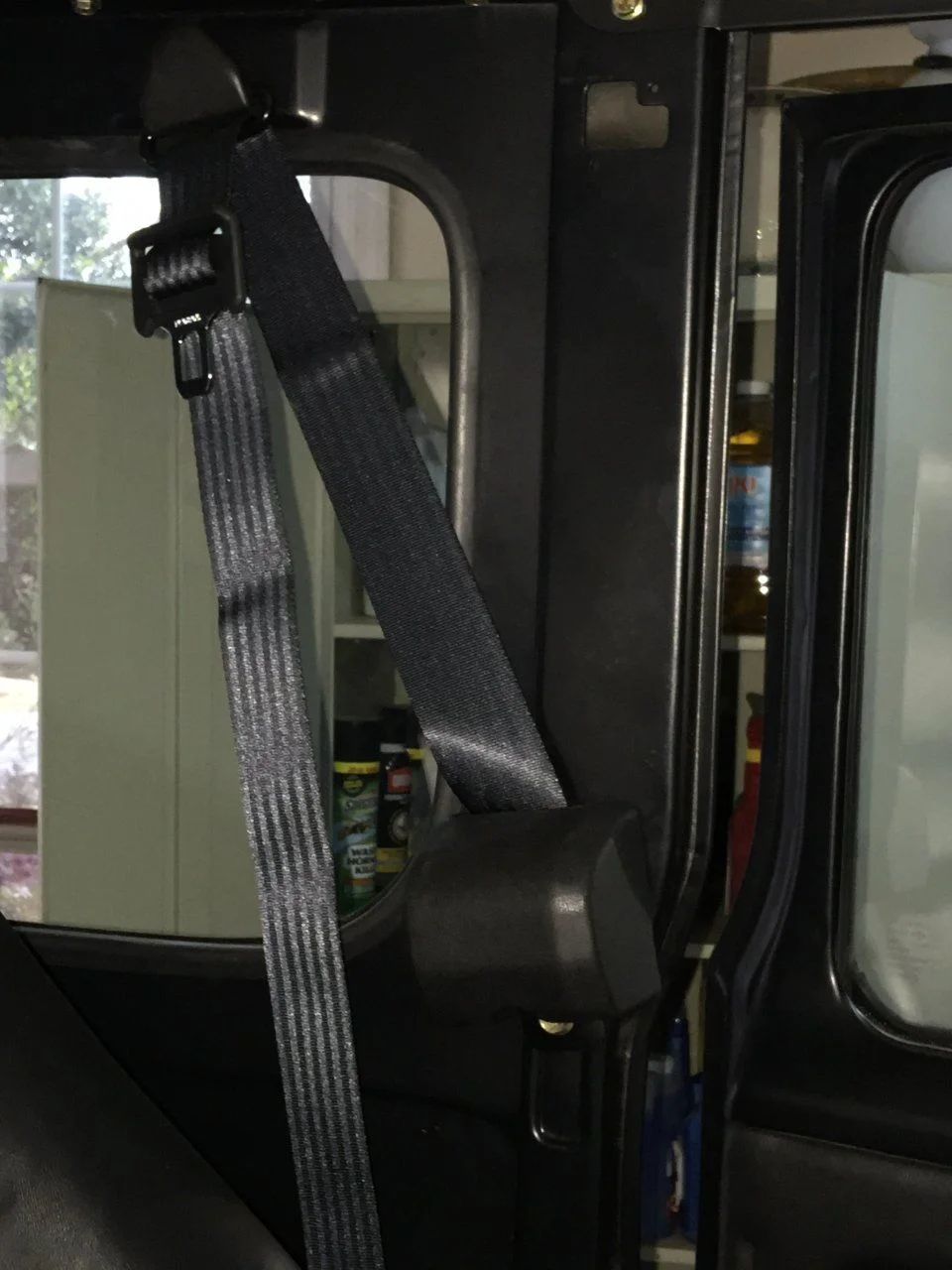

Installed my humvee belts two weeks ago and they're awesome. The amount of extra hardware is ridiculous too. I'd have paid the $28 for just the misc hardware for whatever! The belts do retract in your hand, just need to be facing upward in the installed position. No issues and look great.

1. Can someone tell me the length of the receiver (from the loop to the end of the buckle)? Update...... ebay seller sent me a picture. overall length is 12".
