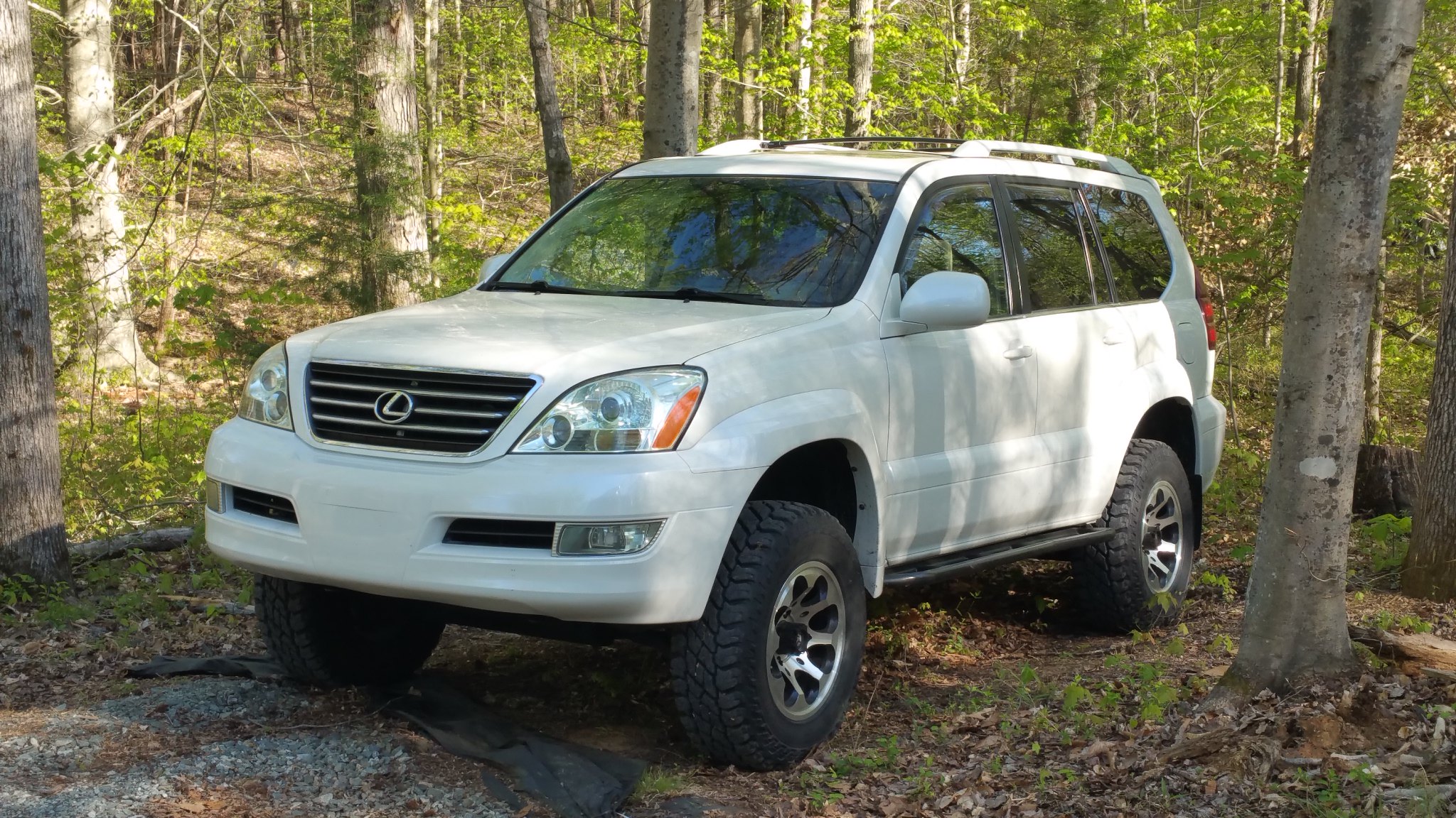

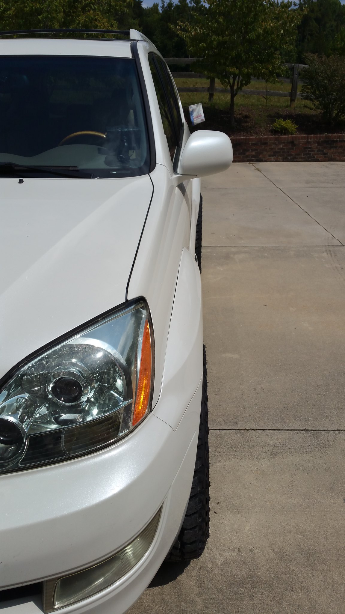

-10 offset no plastic.
Are there any negatives to using skinny tall tires 255/80/R17s on 17x9 -12 wheels? Or is it perfectly fine to put skinny tires on the wider wheels?
I recall reading that some folks (a couple guys on GXOR) have thrown a bead when airing down below 20 psi when running a 255 tire on a wide rim- I will have to do some more research to get the specifics on what width the wheels were.
