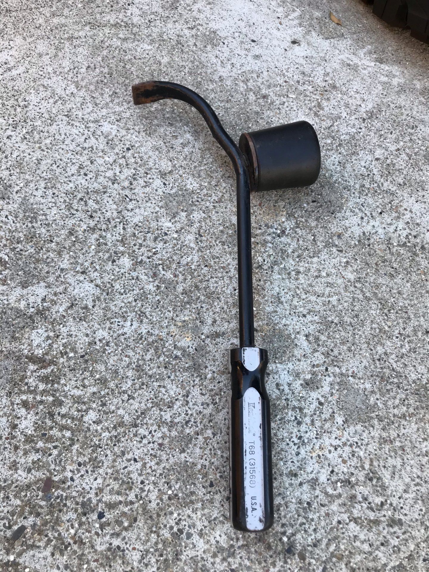

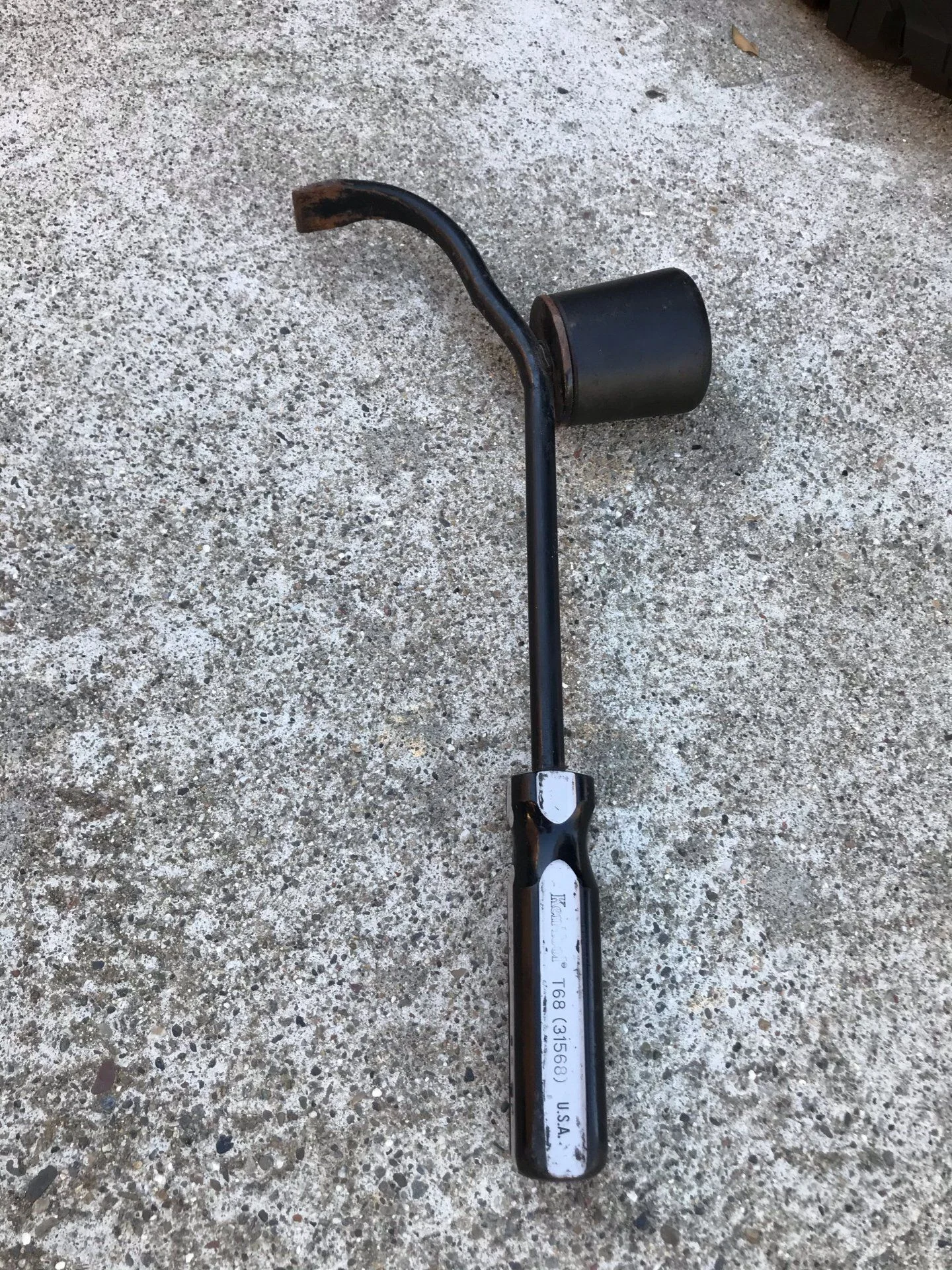

in the old days we had hubcap hammers, it was a rubber mallet on 1 end and the other had a prying device for removal
