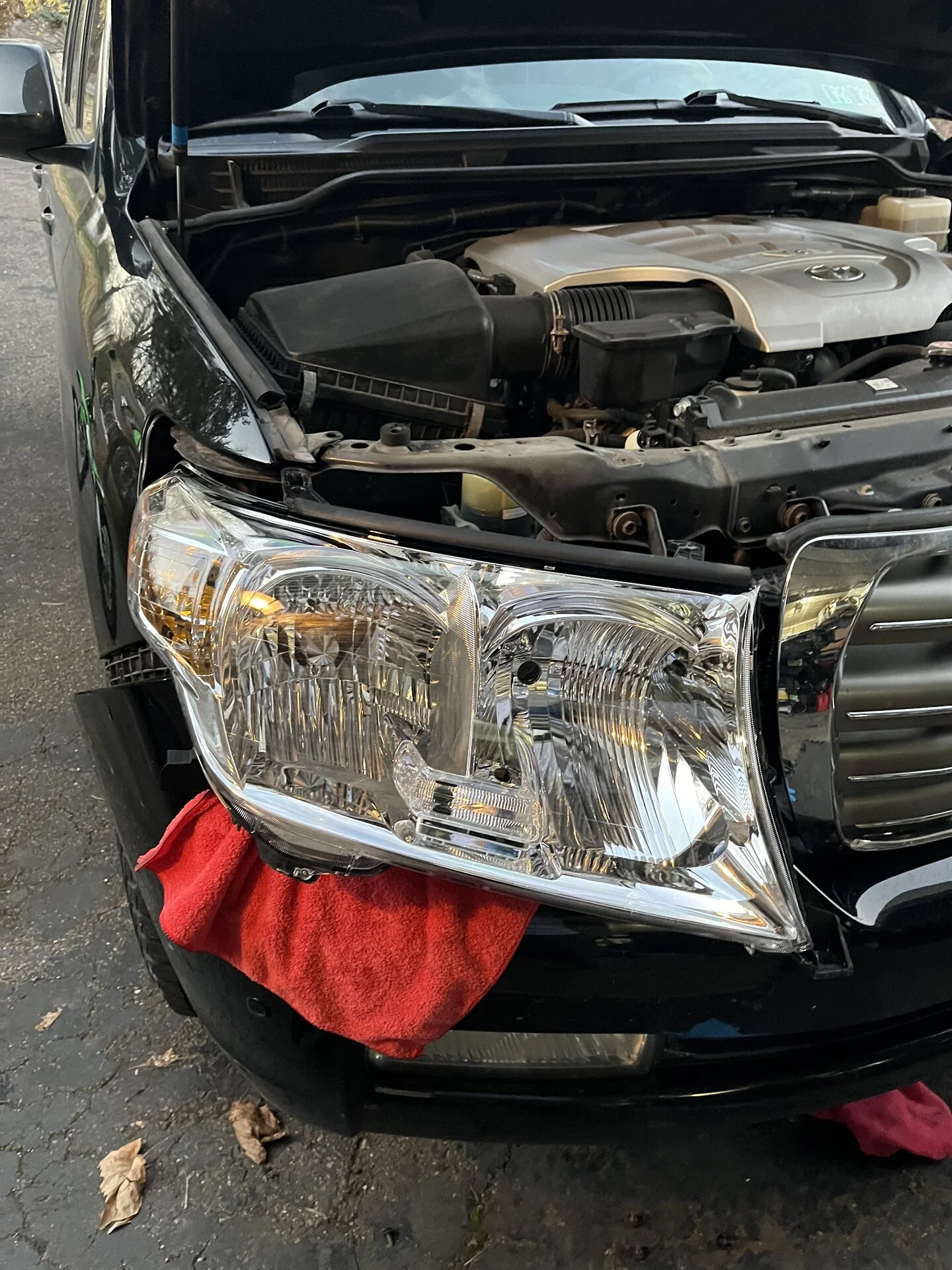

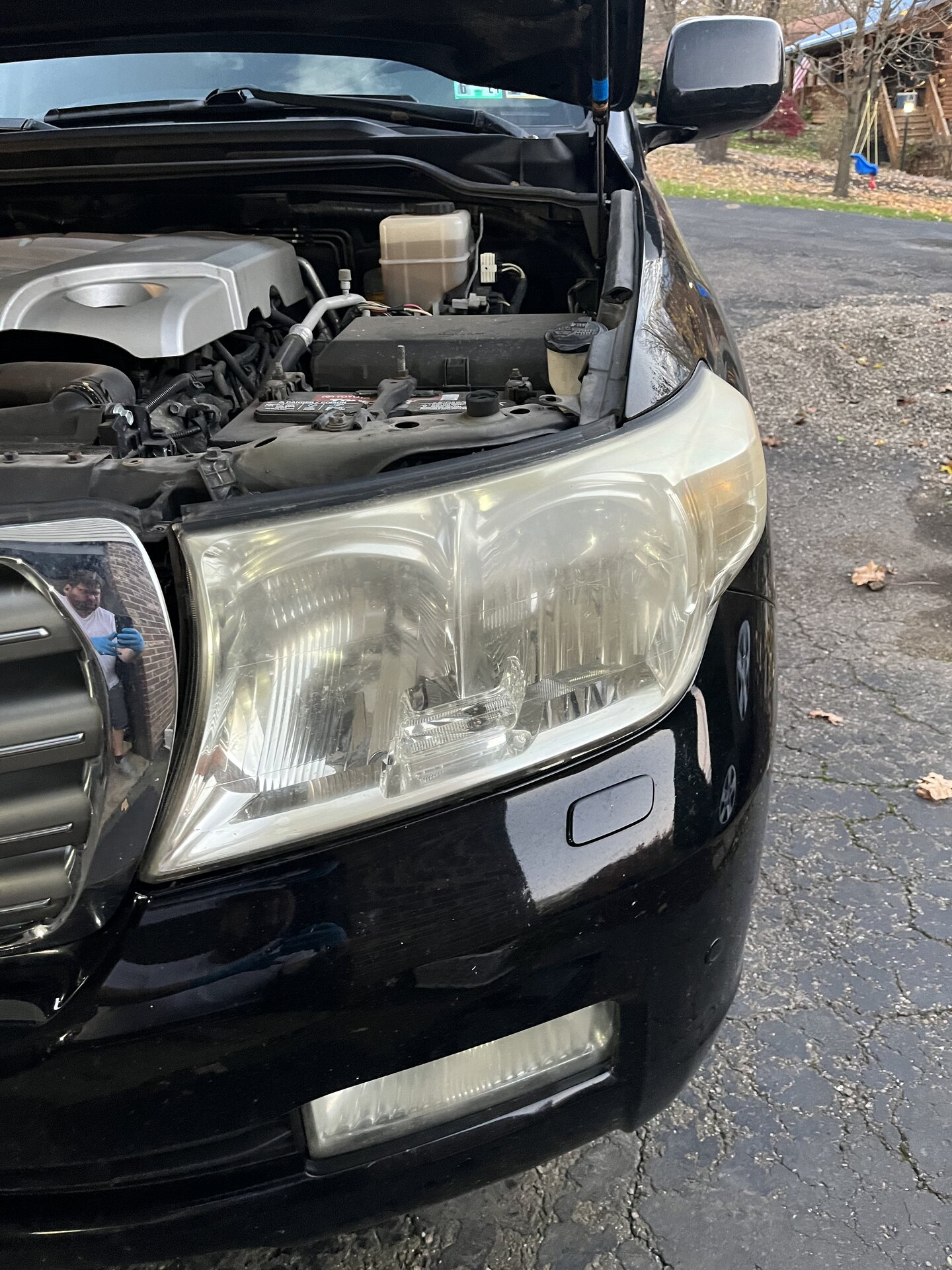

I installed new OEM Toyota lights this weekend. They were $222 each with free shipping. Taking the front bumper off was easier than anticipated and everything went smoothly. If you are tired of polishing your old headlights, just order new ones. I have a few videos that I can upload to YouTube showing what bolts to take off but I found most of the information on here. 2-3 hour job.

Why do the old headlights need polishing all the time?
Stock lenses are made of Polycarbonate but it isn’t UV resistant. From the factory there is a hard but very thin coating applied that prevents degradation. Road use causes physical damage to this coating exposing the underlying poly which starts to degrade and that damage moves under the coating and spreads. This is why modern headlight lenses yellow.
To restore the clear look you must sand off the yellowed surface and polish that to be clear. Some companies offer products that supposedly prevent further yellowing but I haven’t found any that truly work for the long term. Clear coating is a good solution but I didn’t want to do that on the vehicle..
