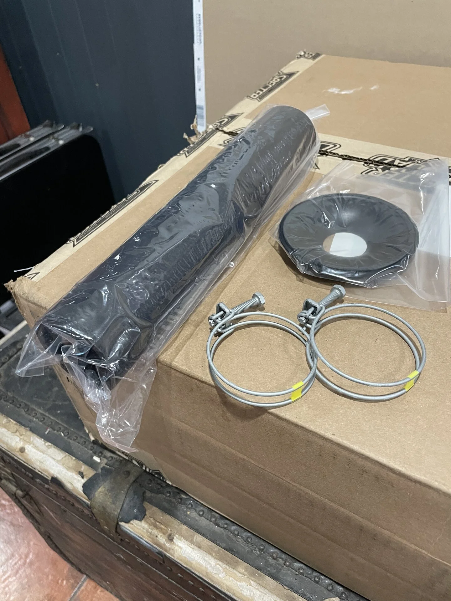

There has always been some discrepancy about the correct sizes of some of these hoses and some are still available from Toyota, but some aren't, and since this is a common replacement item we deal with here we decided to put together a simple affordable complete kit for our shop use and for you all to purchase. The hose is made from high-quality manufactures and the clips are all correct OEM.
There is also a discount when combined with our filler neck hose kit! :)
I struggled with this years ago and would have loved to have this kit back then.
this would be great to bring to the dealer for fuel tank warranty replacements, since this is what usually makes them say they cant do the warranty repair

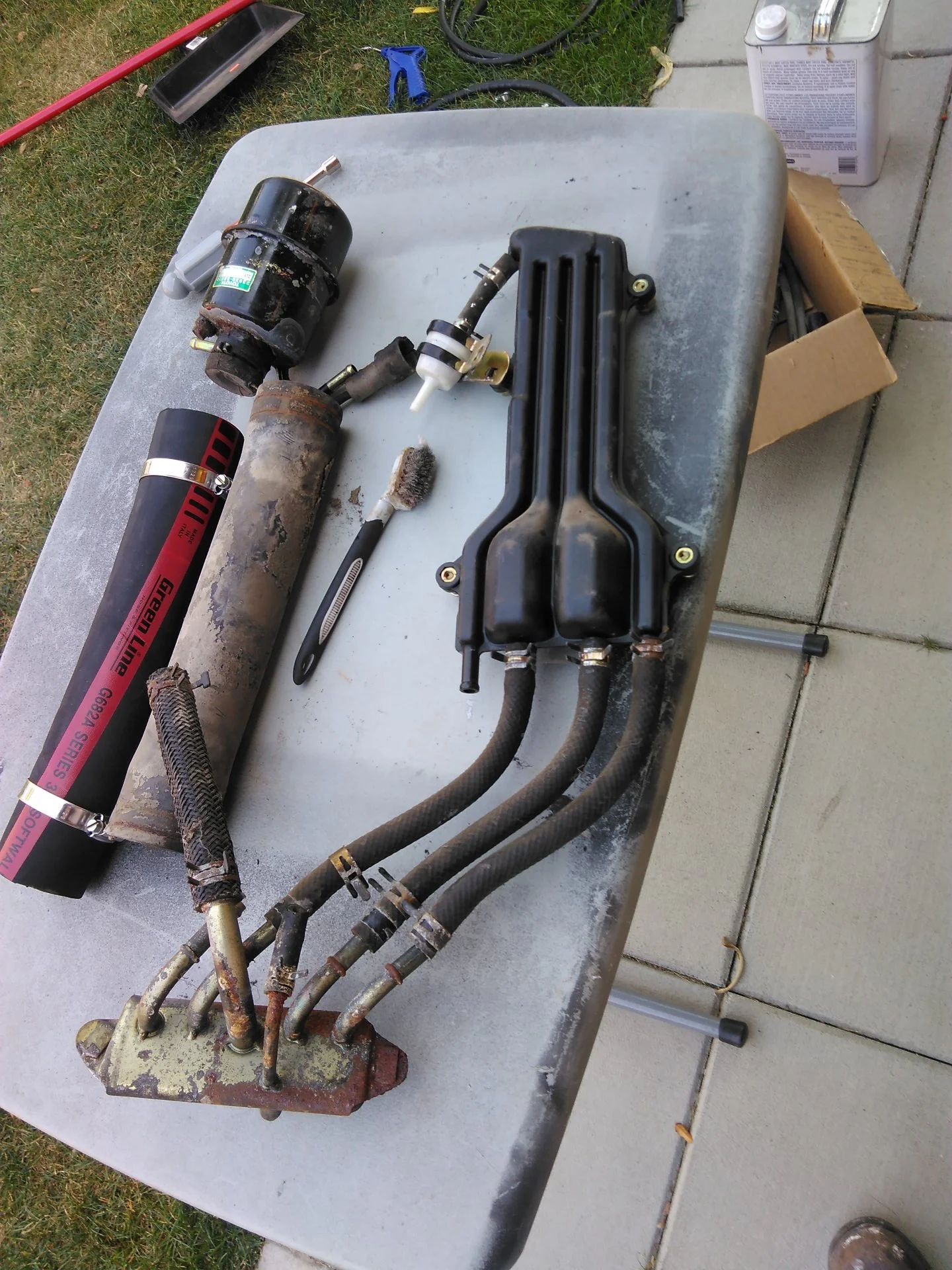

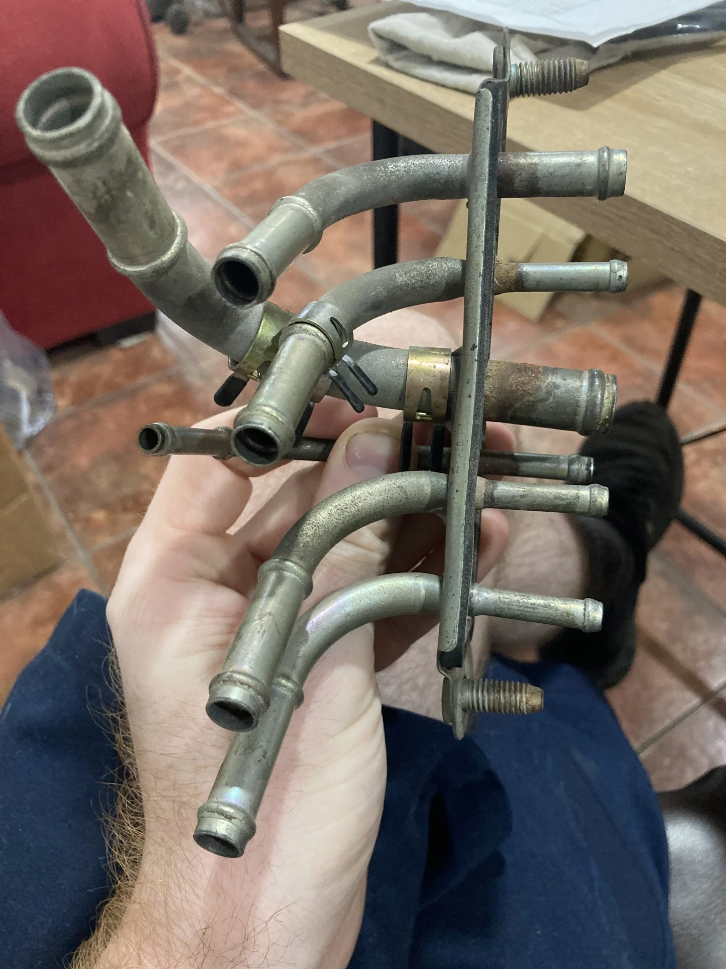

Just a note: The "manifold" the soft lines get connected to - there are two different sizes. For the small diameter hoses, my FJ60 had 1/4"ID hoses, though my '87 HJ60 had 5/16"or 3/8" hoses. Either way, they're not all the same. I realized this when I sized my new hoses with the one out of the HJ60 while I was restoring the FJ60 one. When I went to install the FJ manifold, none of the hoses fit. Not sure if you can see the difference between the diameters in the images below.

Yes, but that difference is only inside the 1/4 panel, no?
All the hoses that go from the tank to that bulkhead (what my kit actually replaces, not the ones you pictured) show as fitting all 60 applications.

I don't recall to be honest, and I don't have the old manifold now to compare. But it makes sense that the tubes in the manifold are just bent tube, welded to a plate. I can't imagine there are different diameter tubes on either side. I just checked mine, all the small lines are 3/8" ID on my truck.

Well they literally are :meh:
