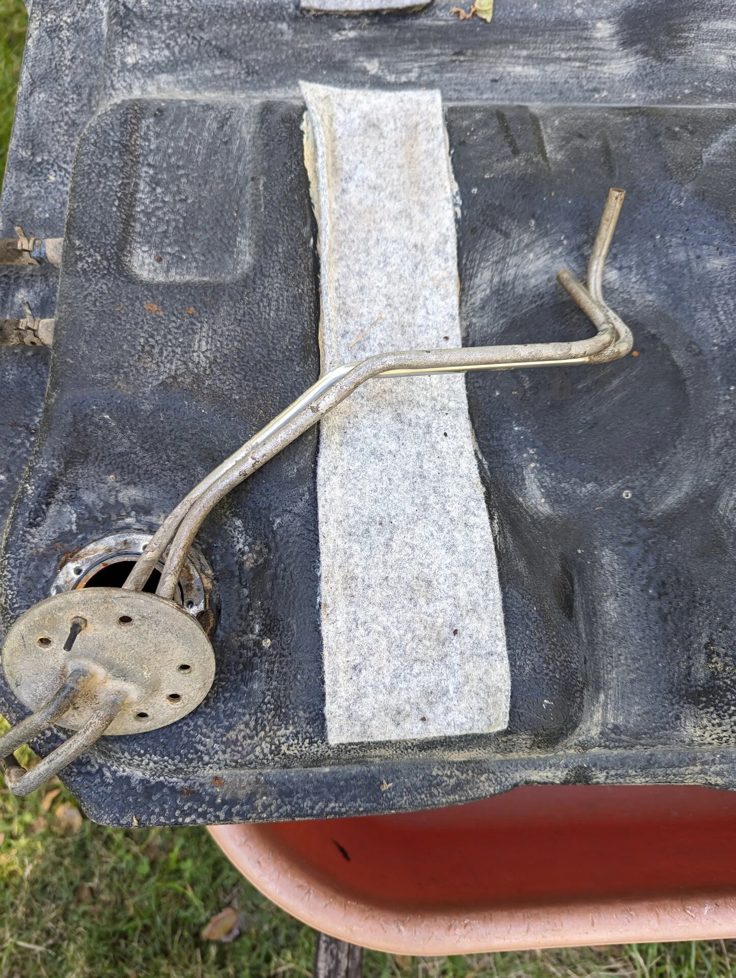

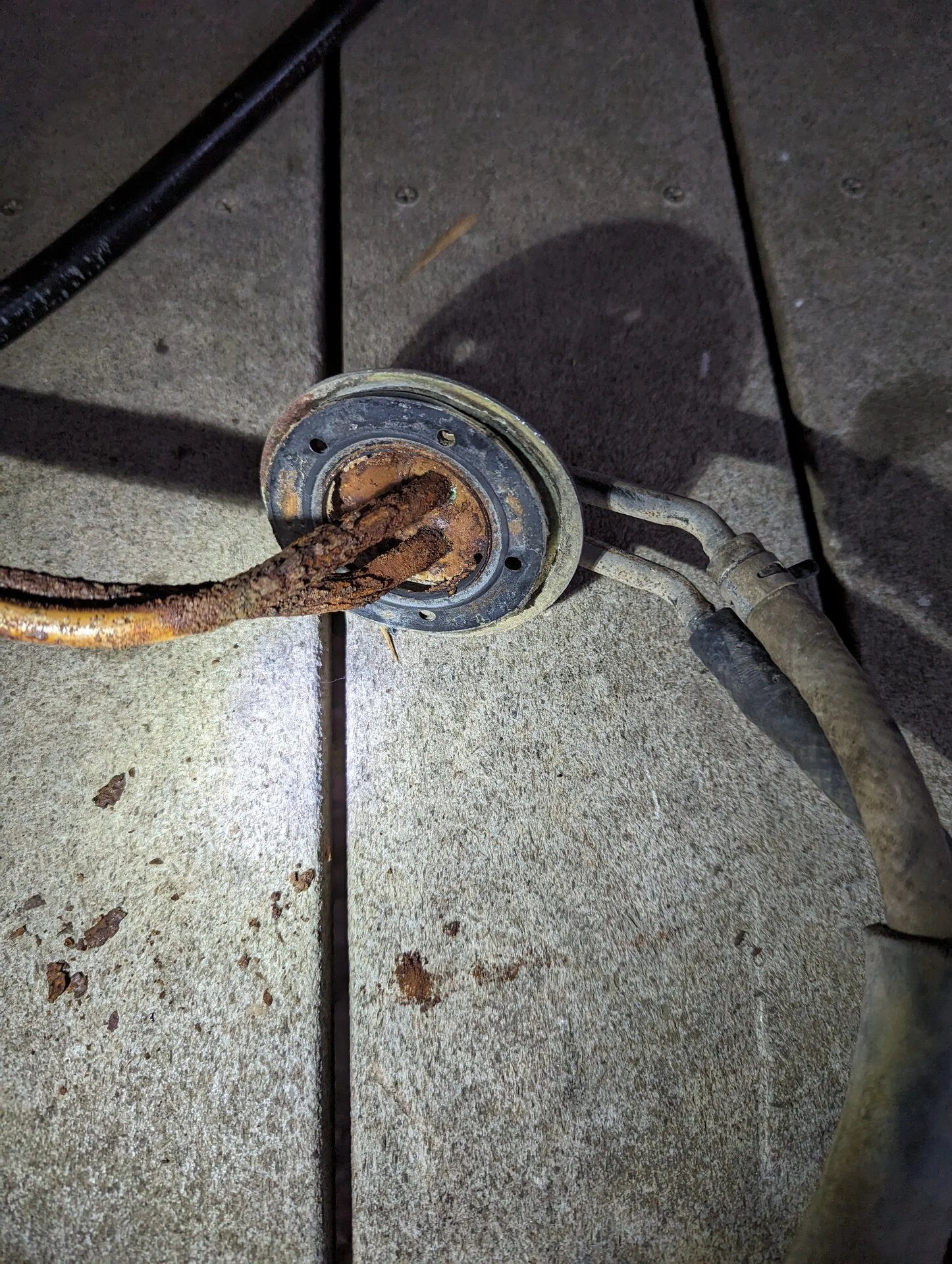

Hello I was wondering if the 86 fj60 has the same internal fuel tank lines as my May 1984 FJ60 - other than I think the early FJ60's had no in the tank filter? I found the line that curves and lays flat (which is probably the send line) was 95% clogged with rust. I blew compressed air through it but that still left some rust. Tapping on it with the rubber handles of a heavy tool knocked out a bunch of rust. I tried running some insulated 14 gauge electric wire through it but it gets stuck. I'm gonna soak it in carb cleaner for an hour and keep working on it.
I'm wondering if the dealer didn't take the time to clean out @Pr86yota internal lines?
The first two picture are before cleaning the outside. The last is after I cleaned the outside but the inside still has some rust.

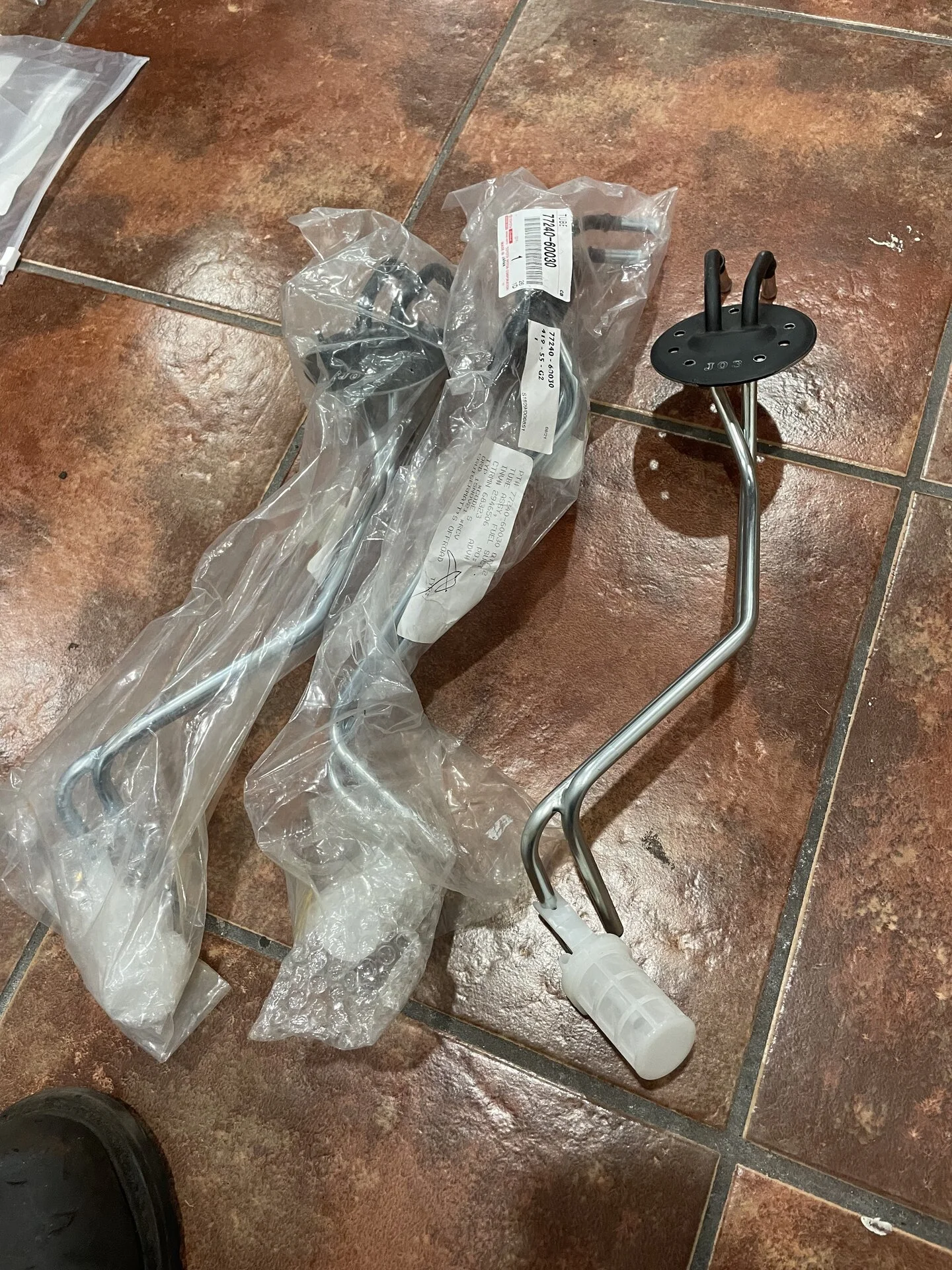

That pickup tube is available new from Toyota. I remember it being less than $50 and it comes with a new gasket and screws. The easy button here might be just replacing it with a new one.
That is good info and not a bad price for how important it is.
Can't seem to find the part but I did find a fuel tank, 77001-60241, priced at 770.12.
I have the pickup tubes on sale right now…
